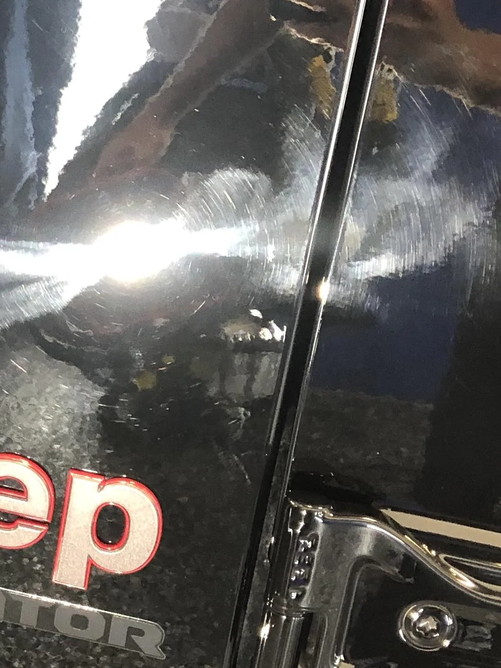

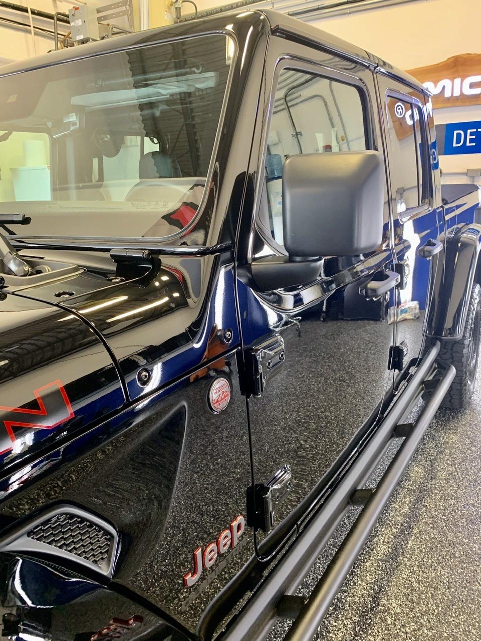

I got it done and it’s a waste of money to have a dealership do it. Their “paint protection” is just a paint sealant. When the dealership outsourced mine to be done...it was so bad, the paint came back worse than when it was new off the floor. The sales manager had to personally inspect mine 3 times before it was decent enough to come back to me. In the end, I took it to a ceramic coating place and their estimate to color correct my black JT was $900. The dealership ate that cost for me to make things right for the damage caused by their paint protection. You’re better off doing a good wax job yourself than have a dealership do it for you.

Yours was a pretty obvious problem this time around. Glad they took care of it for you.
On the other hand, that thing is BEAUTIFUL now. Wow, what a finish.
Jeep Gladiator Dealership Paint Protection 90455DCD-5416-4F84-B10B-7B04FAE35523
