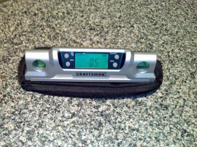

It is CRITICAL that the Angle Finder [available from Sears, Home Depot, ACE, about $10 or less] be ALIGNED and parallel lengthwise with the Jeep frame and wheels.
TIP:
You MUST be looking at the angle finder (AF) straight on to get an accurate reading. Try looking at it and moving your head slightly to the left and right of the angle finder. You will see it shift back and forth, this will help you identify the exact angle. Might want to practice by setting your angle finder on any flat surface that you can easily move back and forth while looking at it.
BETTER WAY:
Discovered this Digital Multifunction Torpedo Level Mdl48295, at Sears. It reads to an accuracy of .1 and displays to .1 degree. It does several other things such as a lit screen and what is really COOL is the display automatically flips to read correctly when you turn it upside down.
It has a powerful magnet on the bottom and will provide some very accurate readings for Caster measurements over the Home Depot angle finder.
http://www.searshometownstores.com/product/Craftsman-48295-Digital-Torpedo-Level
Note:
Alignment machines can get far more accurate readings. Most will at least give 2 decimals points, some can do even 3, 4.589 for example. Looks impressive, but its most likely a waste. Adjustment ability is only about a half-degree max in most cases.
Bottom line is you can get just as good results as the alignment shop. I would not recommend using your driveway unless you know it is level on level ground, your garage floor might be a better place unless it has also been sloped for water runoff.

Readers question, from 'RockPig': When the angle finder is attached to the bottom of the knuckle, the needle should be to the right of the 0 correct, and my Steering wheel will not return to center easily after a turn, what do you suggest?
Looking at your angle meter: If the front LEFT tire is kicked out (forward towards the front of the car) this results in a + caster the needle will be to the RIGHT of the 0 degree mark.
Conversely (note, this is done while laying under your Jeep)
Looking at your angle meter: If the front RIGHT tire is kicked out (forward towards the front of the car) this results In a + caster, the needle will be to the LEFT of the 0 degree mark.
That said, REMEMBER that the NEEDLE in fact is ALWAYS pointing UP as its counterweighted and meant to do so. It is the angle meter that is moving. If your looks like the ones above then it is round. THINK of it as the tire. Since you want to obtain + caster then the tire/angle meter must rotate forward to the front of the vehicle.
TIP: Hold the angle meter in hour hand and NOT looking at the needle, rotate the angle meter to give + caster, thinking of it as a wheel, now look at the needle.

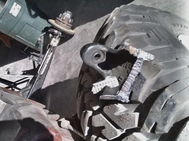

I have experienced DW on my Harley, my Corvette, and have been driving Jeeps since the 60's. I have worked to mitigate it as a mechanic and as a Off Road shop owner. YES I can and have fixed it.

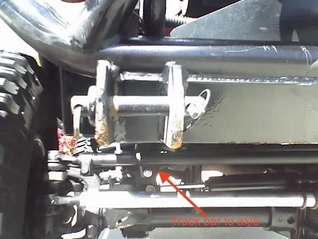

Here is how bad it can get: Cracked track bar frame support, look at cut off frame support sitting on the tire and you will see a piece of paper inserted into the crack.

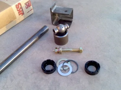

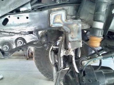

To fix I cut off the old track bar frame support and I built a new track bar using a spherical double shear set up:
I welded it to the frame and dropped it down to be a parallel connection to the axle vs the typical angled connect.
Parallel front suspension is a big plus to solving DW on highly modified vehicles. NOTE in the pic above that I cut off and moved my Steering box. Below you see parallel: Track bar, tie rod, Steering Stabilizer, and Pitman arm connection, note the parallel to the axle.

The genesis of my problem is in the frame side of my track bar mount. I run an OEM track bar and the weak side is the tie rod end that affixes to the OEM “C” mount welded to the frame. The small tie rod end is no doubt in a constant struggle to keep the Dynatrac ProRock 60, 37 MTRs and Walker Evans bead locks running on the straight and narrow. Rapid wear in the OEM tie rod end is clearly expected. Gotta apply a FIX!

Thank you very much. Here is the backstory: Over the years I had DW from time to time and the cure was a new Steering Stabilizer and a rotate/balance of tires. But when I kicked my Jeep up to notches unknown with 37's, full beadlocks and started driving thousands of miles a month hitting trails across the SW from Texas to Cali. I started dealing with hard DW. I must have gone to every shop from Dallas to Phoenix and heard every story on how to solve from adding chrome muffler bearings to adding 4 SS. FACT was NO ONE could solve the problem.
What I also confirmed was there is more misinformation about Jeeps than good info. Most of the comments you will get on forums are from what we called in my Racing days back in the 60's "Bench Racers". These are guys who sit at their bench in the garage posting information and they have never driven a car down a race track, or taken a Jeep beyond the curb other than at Sonic Drive IN. IOW they have no friggen idea. They read the latest issue of WeBeJeeps that some company bought full pages ads to get a write up on their 10 in lift kits. He reads it and then spews his new found knowledge on the forum but does not own, use it or anything else. FYI one of the TOP DOGS in jeepdom back in the TJ days I happened to know him very well, he was considered a GURU...He did not even own a Jeep and when he finally got enough coin to buy a used one he never wheeled it because he did not know how and he would not wheel with anyone because they would learn he knew nothing about Jeeps. He wrote about them, and got LOTS of stuff to test and install. I know because I was one of his testers and I installed stuff on my Jeep then wrote a report and sent it to him so he could publish it.
I won't mention his name, not even sure if he is still active in the Jeep community, have not seen him since my TJ days. He did not have the coin to afford a new Jeep then, certainly not today with their nosebleed prices...
Well I am an engineer and albeit I left the Mech field for Software Engineering I had not forgot how to solve problems.
What I did was crawl under my Jeep and STARE at the front suspension and I was under there most of the day and then it hit me this is how I can solve the problem and I did it, its worked and I put about 60k miles on it past that point with no issues...
