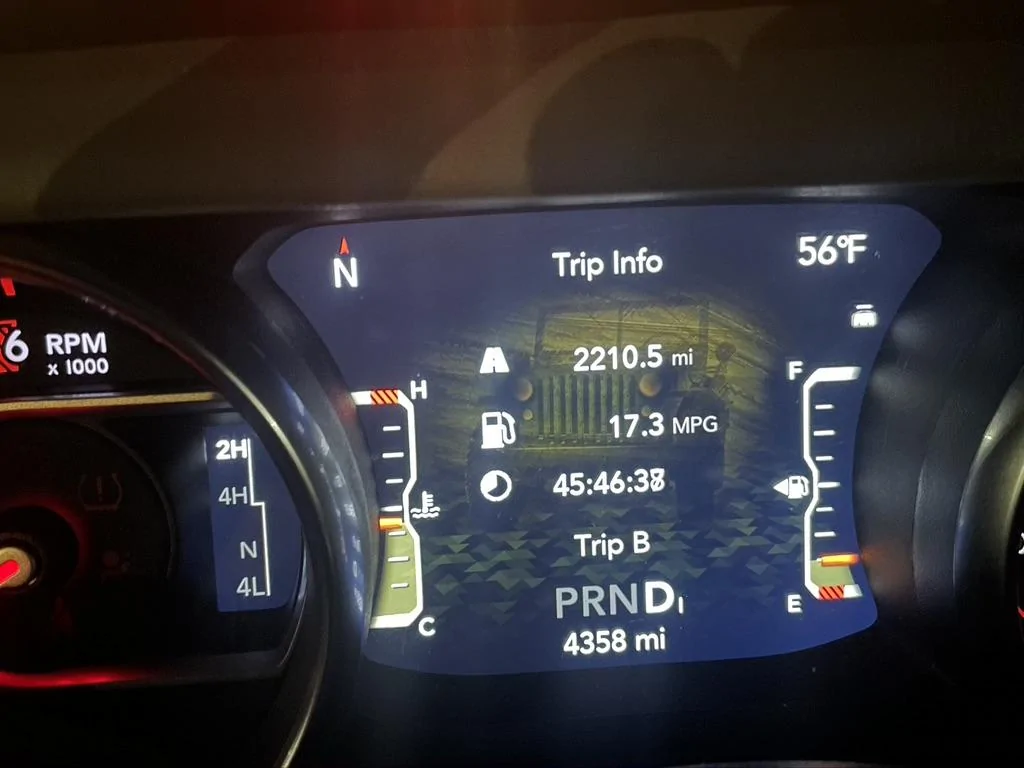

I had to fill up my DEF today. 2100 miles. Said I had 400 till engine would not start. What are you all seeing if you have yet mileage wise.
Ok update. I just finished a 2200 mile trip. 90% freeway. I filled up the DEF tank to the top. I pulled into home last night and got the alert I have 300 or so miles left of DEF. I have reported to Dealer for their input. Something is not right having to fill DEF every 2000 miles.
what was your calculatEd mpg? DEF should be 3% of that usage

So it’s a touch high depending upon how accurate your computer is but not off too much. You’d need to hand calculate your mileage to know for sure
So you think using an entire tank of DEF on 2200 miles is correct?

There's an issue. Unless your actually getting 10mpg then your def consumption is at least double what you should be seeing. I would start hand calculating and logging on paper what your getting fuel and def mileage.
