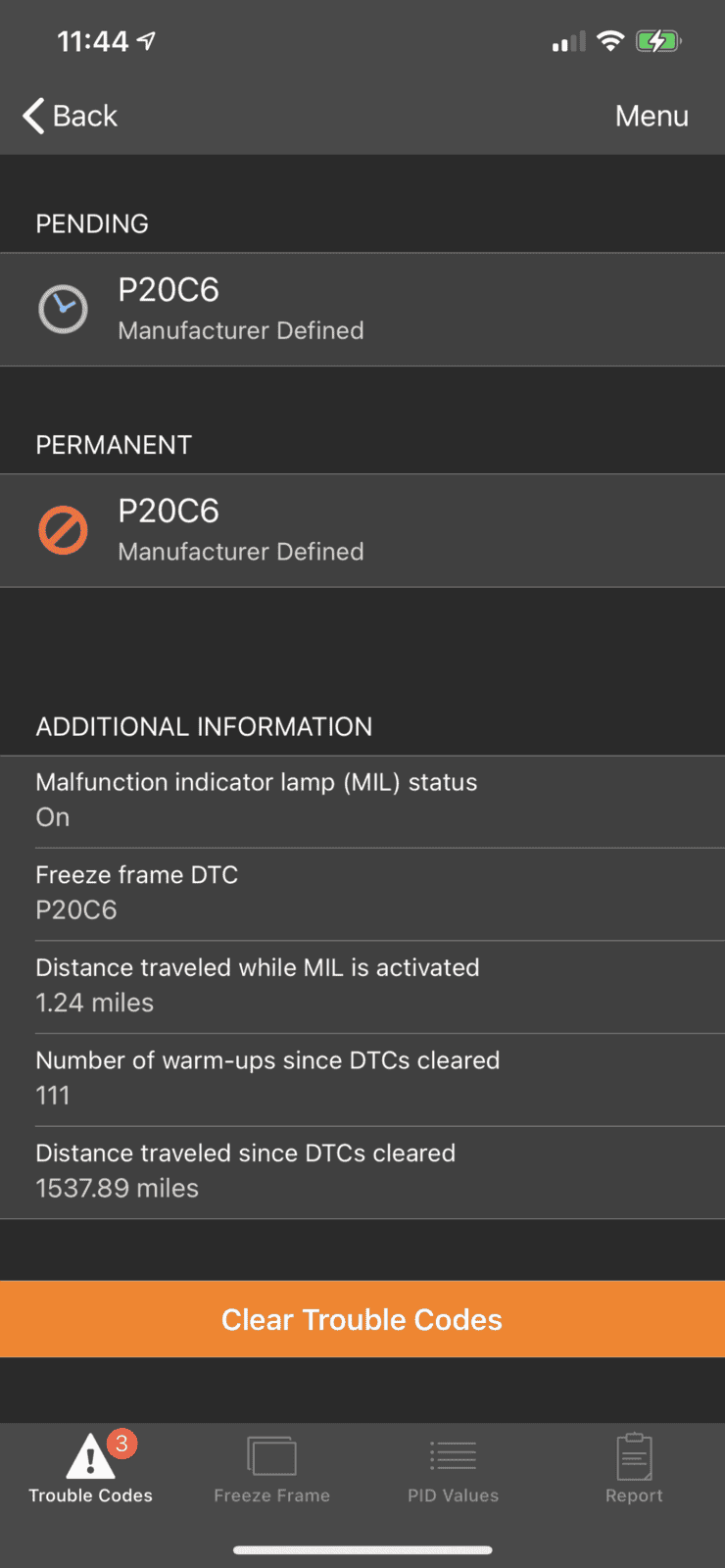

Received my first troublecode today P20C6. The vehicle had been running all morning and I was just pulling off the freeway after about a 150 mile trip. This code refers to the DEF heating circuit. Thought I would at least share. I will call and schedule an appt with the dealer tomorrow.
From what I found online at OBD codes:
If the PCM detects improper voltage that is outside the normal expected value range within the control circuit for reductant heater D, a code P20C6 will be stored and a malfunction indicator lamp may be illuminated. Reductant heaters may be inside a DEF tank (example shown here): What is the severity of this DTC? A stored code P20C6 should be considered severe and addressed as quickly as possible. The SCR system could be disabled because of it. Catalyst damage could result if the conditions which contributed to the code being stored are not rectified in a timely manner.
Read more at: https://www.obd-codes.com/p20c6
Copyright OBD-Codes.com

Check that all your fuses and relays are seated properly.
I checked these. Fuses were fine, relays were only partially seated. I reset the OBD code and will see if it occurs again. This particular code gets set in the permanent codes. Any idea if I need to notify Jeep or the dealer in case of further problems?

Absolutely! You want all faults on record in case it lasts until 2 days after your warranty is up, OR in the case something else happens.

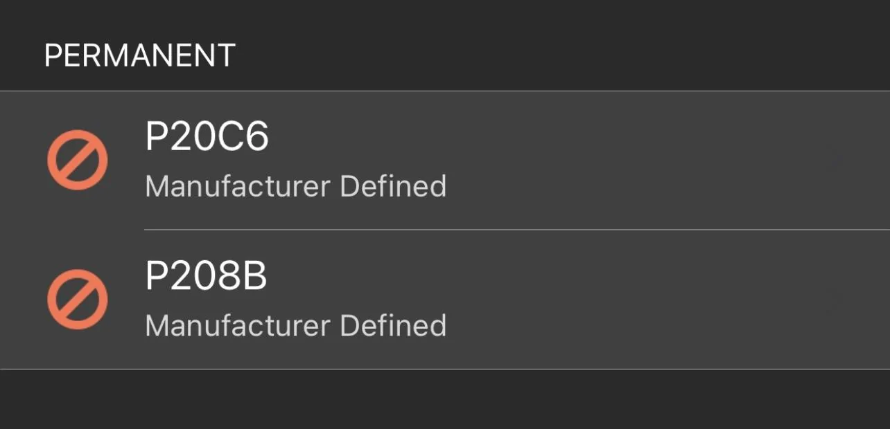

Got another code today P208B saying def system requires service and to take it to a dealer. Started running really rough so I called and take it to them in a week. 1643 miles. F-ing DEF
Jeep Gladiator Def troublecode at 1542 miles 3BCF7503-5128-4B30-860D-95FE0AFB1058

The first thing to check for with code P208B is DEF contamination or degraded ...
according to one troubleshooting thing I found.
