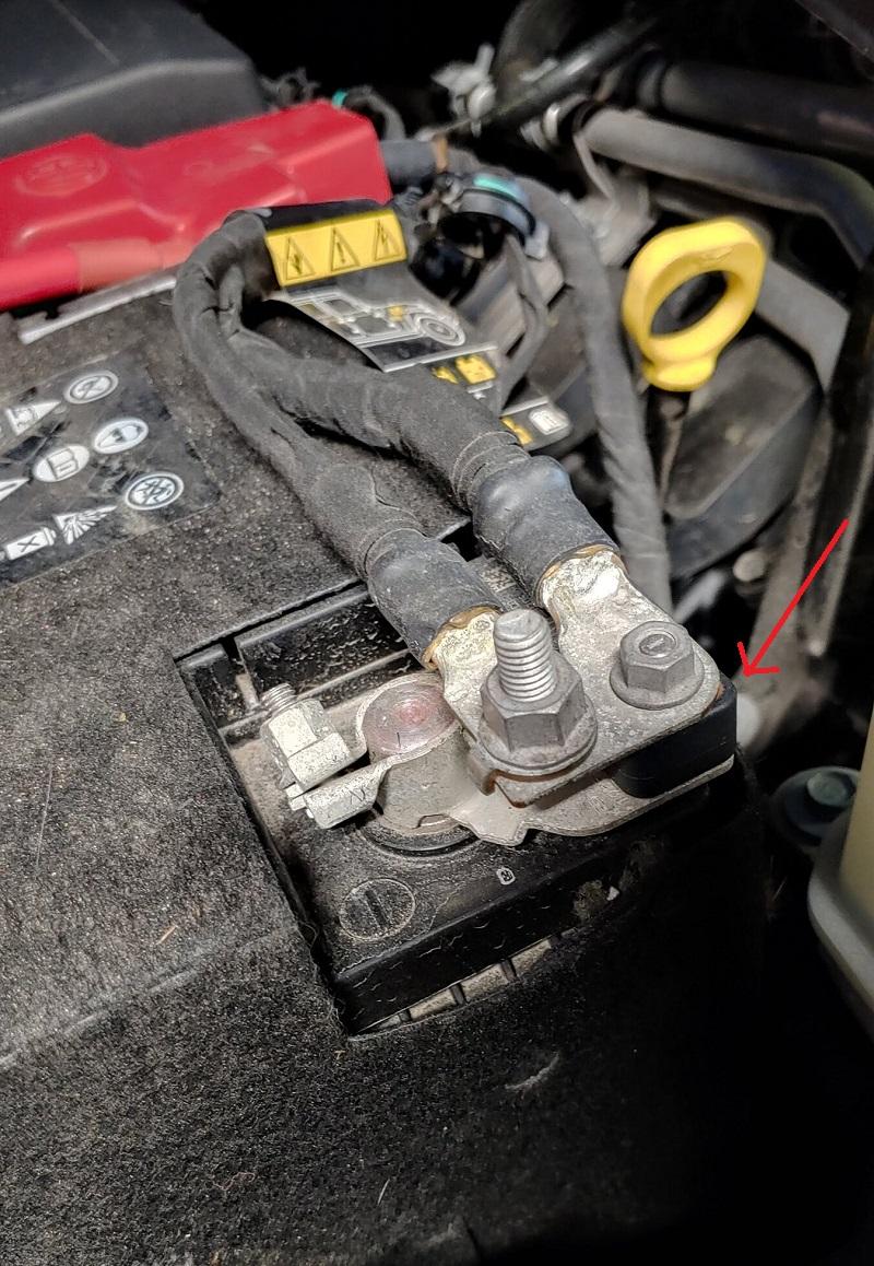

When sitting parked engine off the batteries are connected in parallel.
A decent charger should be able to keep the batteries up.
However, connect the negative to the top of the IBS, not directly to the main or crank battery negative terminal. Always charge through the top of the IBS, where the black ground wires are connected. Or, connect negative to the body ground terminal.

IBS = intelligent Battery Sensor? in my Mini Cooper thats what it was. Just a little filter and circuit on the neg terminal right.
Yeah, sorry. I was so used to just calling it IBS........
Connect to the top where the nuts are, or the body ground which is where one of those two cables goes to.
