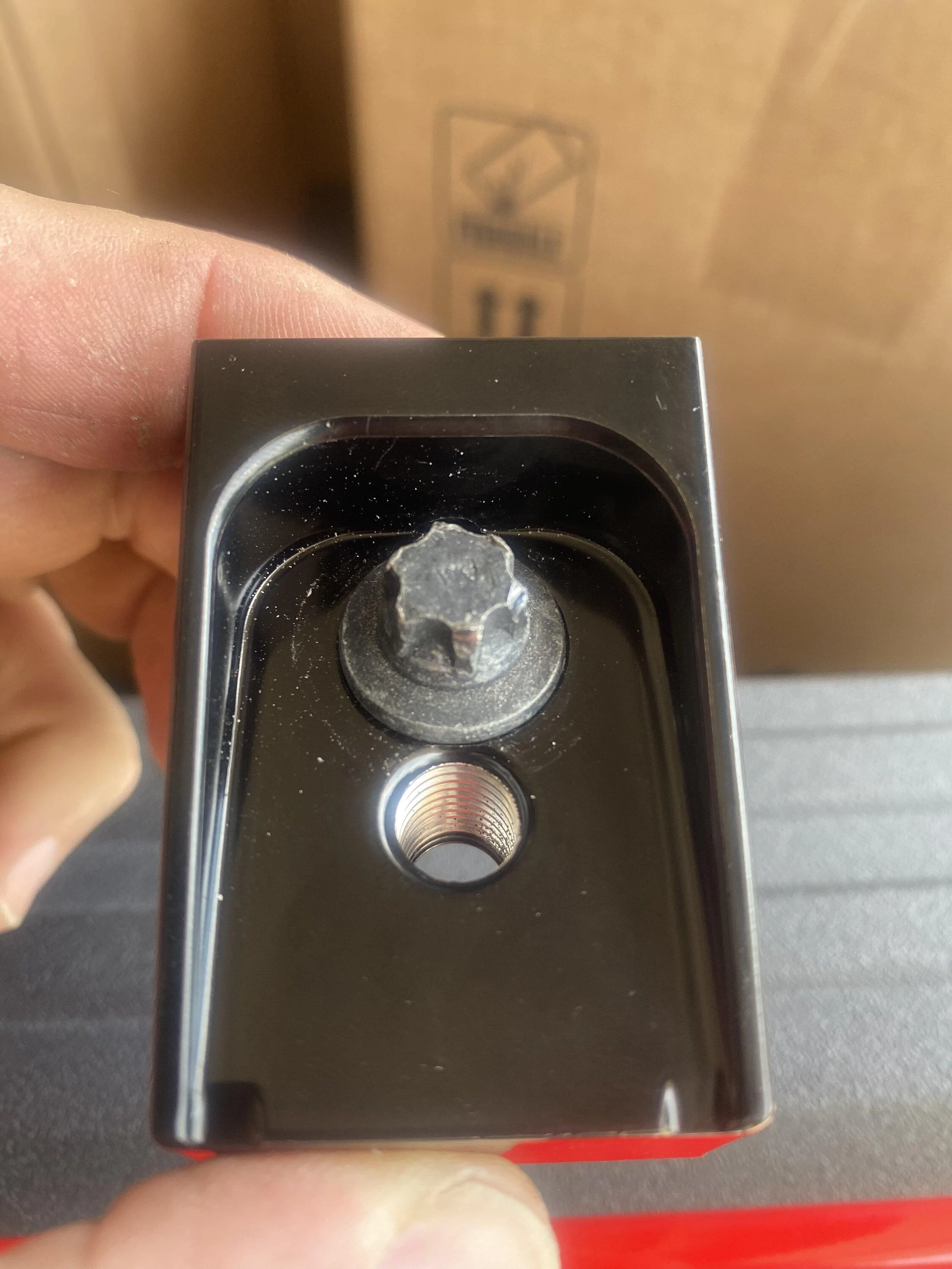

Ordered up the 2" seat slammer kit for my '20 JTR and installed it this past weekend. I'm not sure if did something wrong or if there was some issues with the parts. The flanged bolt that goes into the bracket that goes on the front of the seat next to the shifter console didn't fit. The threads fit, but the flanged portion would not drop down into the counterbore of the bracket. It didn't seem like the paint was thicker or anything, just seemed to small. The other front bracket fit just fine.
Anyone else have this issue?
I notified DDI, not sure if they are a member on here but i'll see what they say and report back.

So I heard back from Desert Does It and apparently their instructions are not current to the product. While they sent the hardware I was supposed to use on the front brackets, the instructions still specified to use the original hardware.
My solution during the install was to chuck the factory bolt into a drill and run the drill direction against the direction of my belt sander until the flange of the bolt was small enough to fit into the bracket. Ended up working just fine.

Yeah as you found out should have used the provided hardware. The instructions they sent me too were also out of date but I only did the front seat Jackers so was pretty straight forward

The guy at DDI made it sound like they recently changed the geometry that now prohibits the use of the factory bolts on the front jackers.
