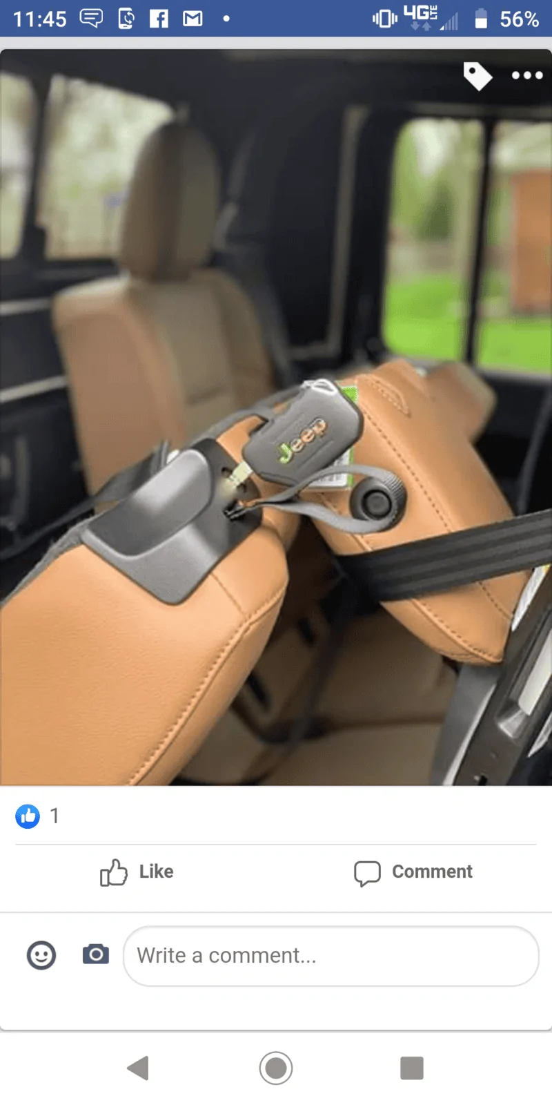

You can actually Keep
it unbolted from the floor and just flip the seat down and lock the seat. Problem solved

You can actually Jeep it unbolted from the floor and just flip the seat down and lock the seat. Problem solved
Kinda incorrect. The tops of the seats can be locked so you can’t get to what’s behind the seats. The bottom seat cushions can not be locked in the down position. Just lift them up to gain access to the box below the seats. The box itself can be locked. And if the box is left unbolted then anyone can lift the entire box out and run off with a box, regardless of weather or not the box is locked or unlocked. It’s really best to keep it bolted to the floor and locked if you don’t want to get your box stolen.

So if you flip the top of the seat over the bottom it doesn't lock? Well that sucks...
That would be nice if it did that. But to the best of my knowledge it only locks the seat back in the upward position. Does not lock the seat back when it’s in the horizontal position. Believe that falls under the wishful thinking category. But to be honest I am certain that Jeep didn’t think to do that for the simple reason that they put locks on the under seat box that really should be left bolted to the floor. That way you can lock up what’s under the seat in the box and what’s behind the seat. Just don’t unbolt the box, problem solved.
