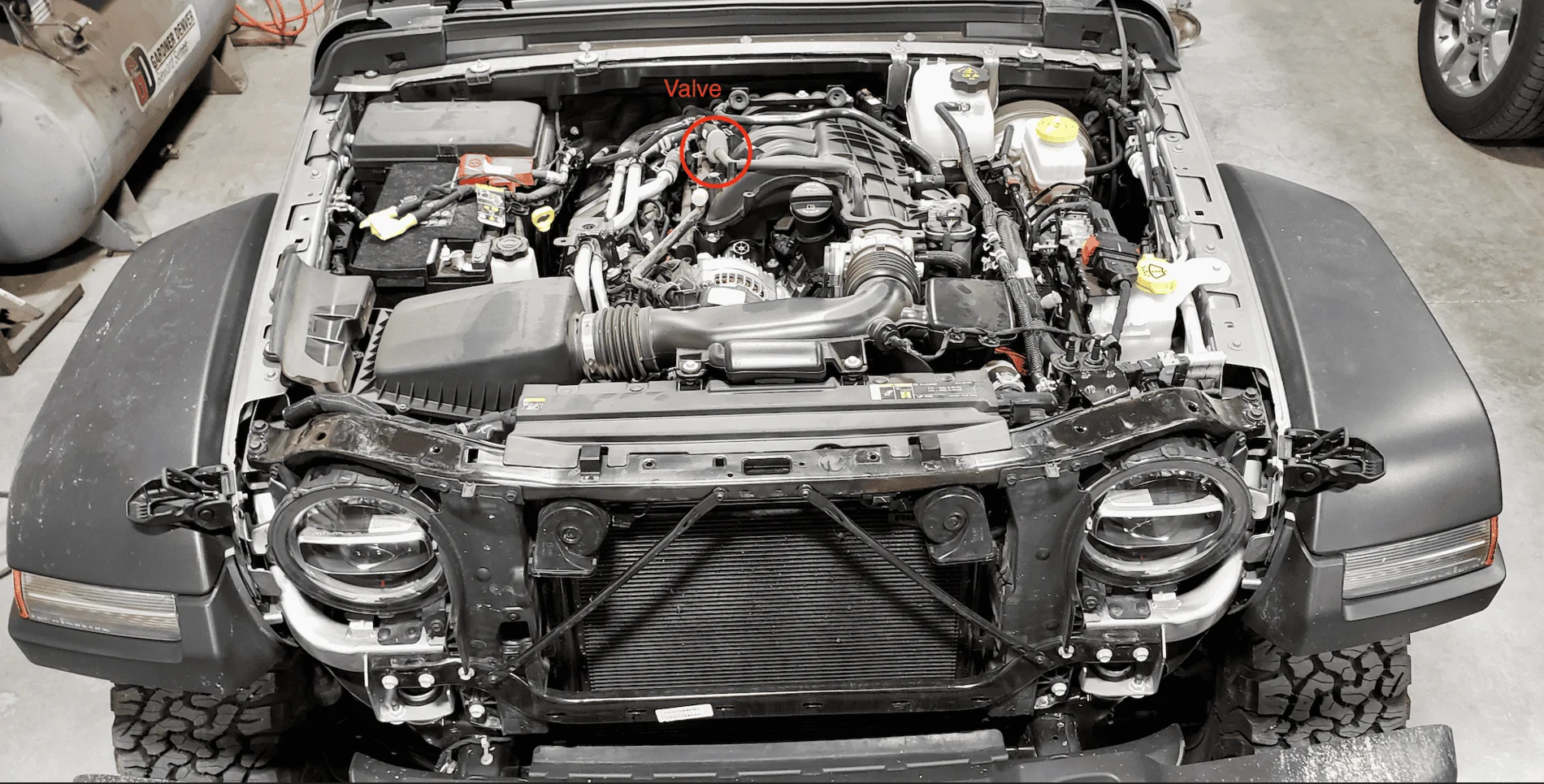

I noticed the EVAP purge valve ticks on mine after installing a supercharger that relocated it to the back of the engine, nearly up against the firewall. I had originally thought it was a lifter/rocker but monitoring the purge valve command, you could see the intermittent ticking line up with the valve actuating.
I cann't hear it over the engine noise with the hood open but sitting inside the Jeep, it is quite pronounced. Placing a finger on the valve, you could feel it perfectly lined up with the sound. Just something else to think about.

The irregular pattern, and impact from transmission gear, make me think it's outside the engine, but the sound seems like it's epicenter is the engine. I fancy myself quite good at isolating noises, but this one has me stumped for the time being. Anyway stay tuned, I'll either find it myself or the dealer will. The first correct guess still wins the prize, because why not have fun!
This seems very in line with my experience. Easiest to hear from the cab, challenging when the hood is open. Is the purge valve located on the EVAP canister itself? I recall it was near the battery in my old JK, because I broke it once putting in a new battery.
It's located on the passenger side of the intake plenum (pictured).
