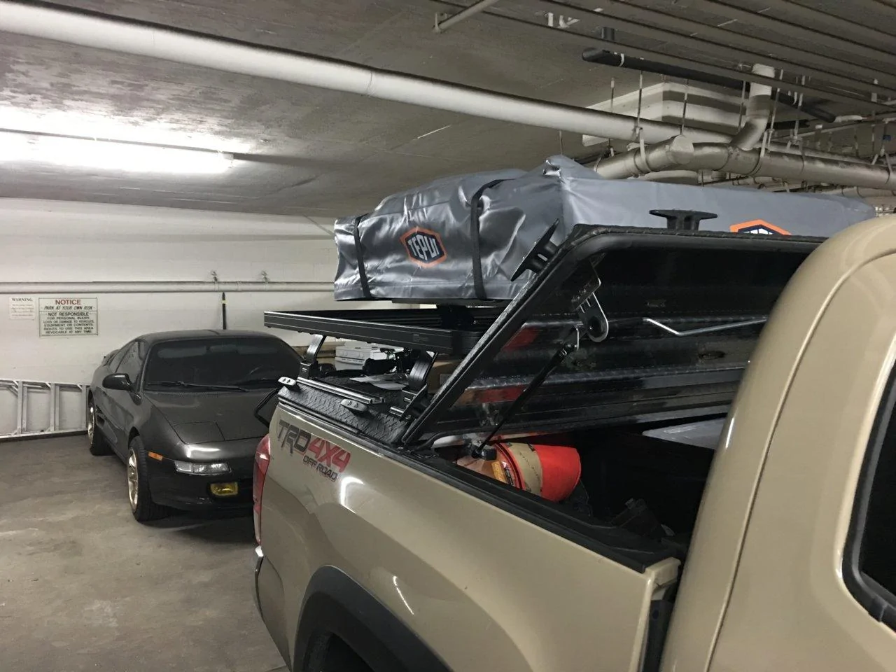

Another point for Diamondback over Ace is the capability to still gain quick access to the front of the bed even with things mounted on top. The only other thing I can see that would give this level of access would be to have a full topper (albeit needing to climb into the bed to get to it). I found this picture for a Tacoma to show what I mean.
I feel between the two the Diamondback may be the better grab. A downfall that I have is that I wouldn't be able to mount an awning like a full topper unless I can find a way to mount it to the hardtop only (leaving the capability to remove the Freedom Panels still).

I have seen that tacoma image as well. It looks cool, but I don't know how easy it would be to pull off in practice. The options for mounting a rack are limited unless you are ok with drilling through a very expensive cover. Diamondback sells a rack but it is stupid expensive.
Don't get me wrong I love mine, I just wish there was an easier way to mount a rack.

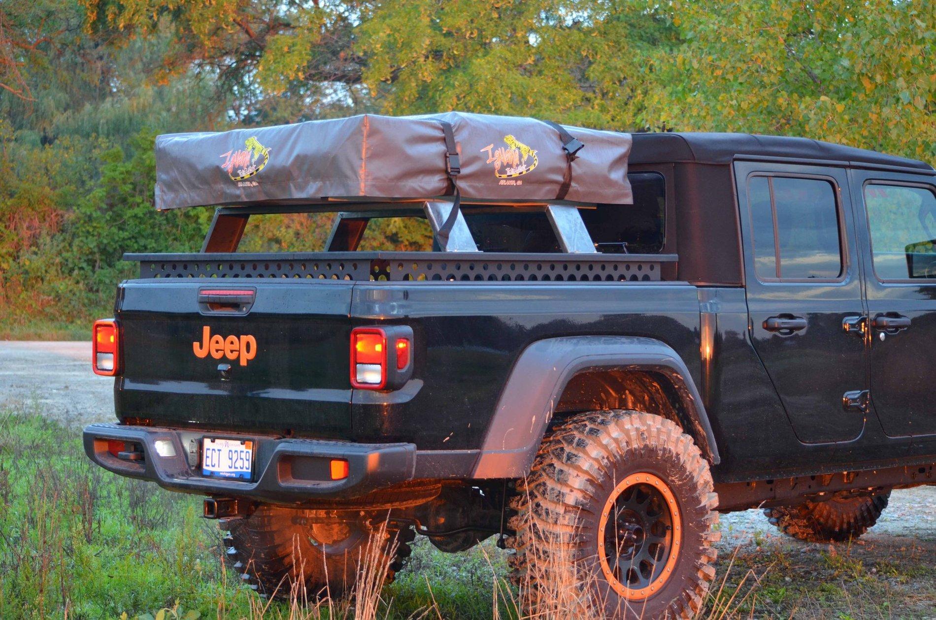

Ace's cover has provisions put in place to accept most racks / mounts without the need to drill any holes. It was certainly a plus for me for that exact reason.
BUT once you start pricing everything out if you intend on putting a rack on top, you really start to approach topper prices. If ARE comes out to say that it can handle a decent dynamic load, I may be going that route. Otherwise, the price of a Diamondback with the proprietary ($$) racks/mounts that you have to drill through start to rapidly approach the price of things like RLD or Alucab with a lot more to offer at that pricepoint.

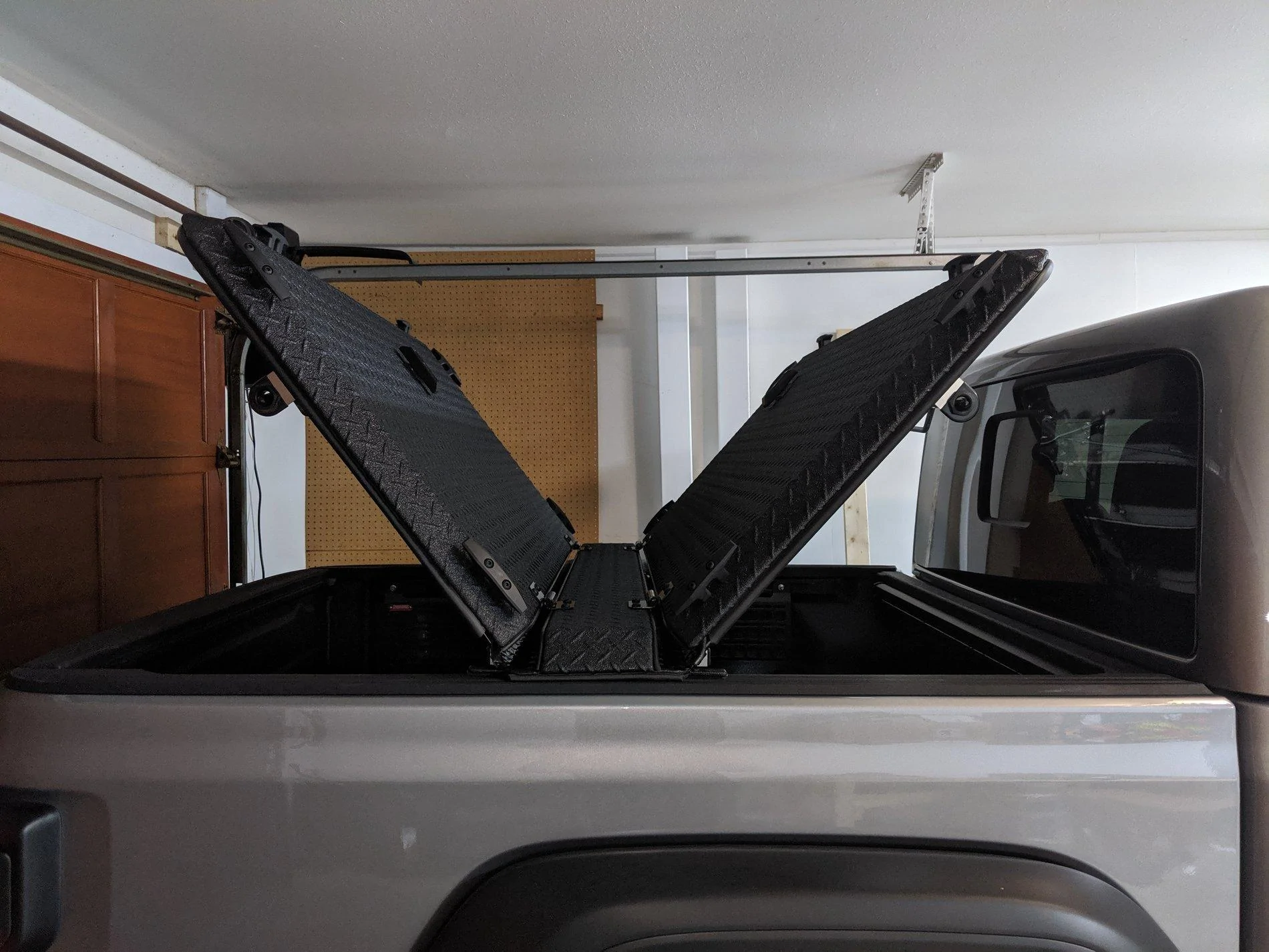

So I going to mount rails on top of the diamondback, that the cross bars slide onto (then tent on them). The rails will stay on the diamondback all the time, but cross bars and tent won't. Icantfi d a good picture for you, andfo t have I e setup yet. But if you youtu.be search for "overland last line of defense" there is a good video on it with a Toyota truck.
That's exactly right. I also copied the Tacoma from the youtube video. It's really no big deal to drill the holes. The Front Runner tracks come with a rubber base and I also squeezed some silicone sealant into the holes before I added the screws/washers/nusts. I have had ZERO leaks. The improvement in versatility and utility are well worth the hassle of drilling.
I like the idea of adding a piece of track to the center section to allow a load bar to be mounted there and the front to be opened even with a load across both bars.

To me the Ace would be the choice for dedicated overlanding with tent mounted and other stuff that bolts onto the lip. For general coverage and flexibility to remove or access the bed front the DB gets the win. As well as looks. I love the look of my DB SE but the rim around the Ace is a certain statement you may or may not permanently want. I've been thinking about drilling the DB to mount a bike/ski rack system, no qualms about a few new holes and they will seal fine with some silicon and a bolt through. Maybe in the Spring.
