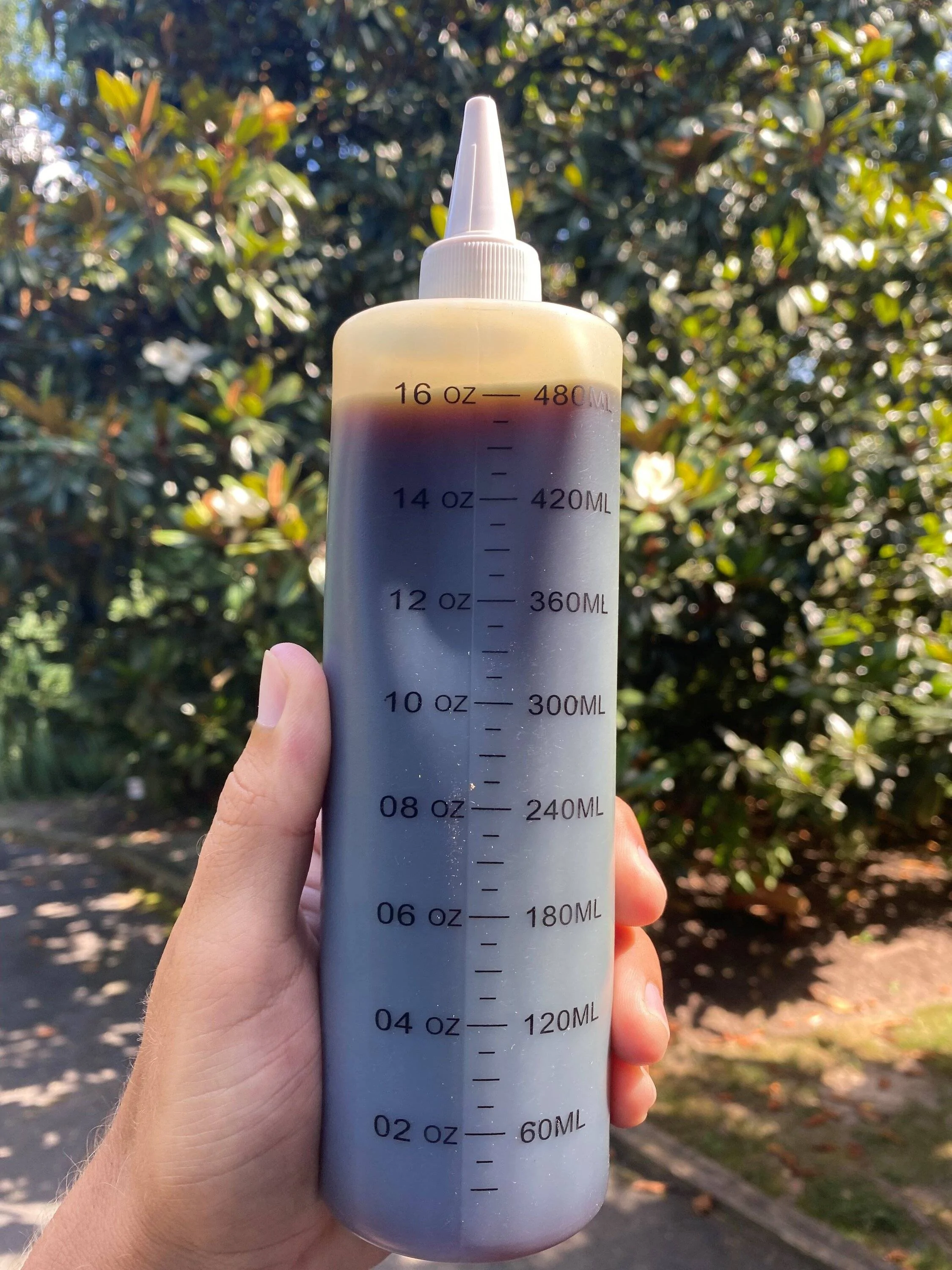

Hotshots EDT. You can't overdose it and the more you put it the more lubricity it adds. Cetane will plateau which is why the "performance" dose is just double the regular at 2oz per 25 gallons. I put 1.5-2oz in when I fuel up. I squirt it right on the flap and it goes in. No need to get your heads smelly with a funnel.
I buy it by the gallon because it's way cheaper and pour it in to these handy 16 oz squirt bottles I found on Amazon with a screw on leak proof cap.

@Almost can you post a link to the bottles you got? They are handling the chemicals ok? I've seen a few post on another board where the bottles broke down and started to split.
