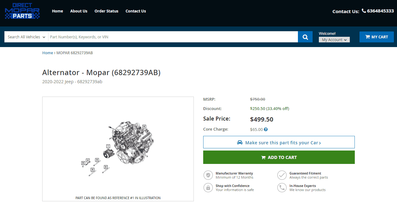

well i done broke my alternator. part 68292739AB is the replacement, but unknown backorder at this time. anyone know of any aftermarket or upgrades? I have an order in, but no jeep till then is a huge sad panda.

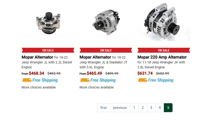

Well, looks like you are looking for a different animal............
I can check but bet even my supplier doesn't have much for parts for anything in the last 5 years. Anything older, I can get.
This supply chain bullcrap is messing with my jeepin lol. if you can get something let me know! Thanks!

Hmmm, this site doesn't say "out of stock" like the others - might be worth a call????

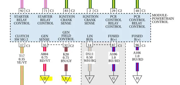

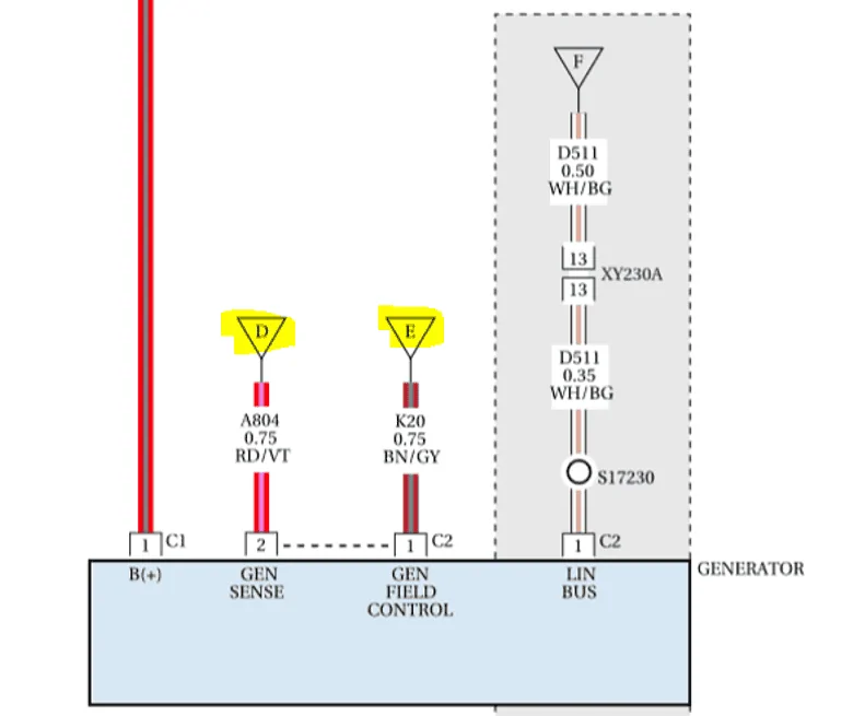

glad you are owning the damage, but what happened to the days you could dunk your alt and not worry about it? These newer alts have switching in them to turn them on and off as needed to save MPG, I wonder if you can retro fit a simpler setup?
Getting some mud on the alt isn't that uncommon, you are the second person I read about with a dead alt after some mud.
180
29,526
35,131
I thought that was the PCM that did the switching since it's controlling the field on these things........
The PCM does this based on information from the IBS. The control isn't in the alternator, it's in the PCM - 35 senses system voltage, 32 controls the field and the PCM bases things on the info gathered and charted (literally) by the IBS over the LINbus.
Jeep Gladiator Diesel - Alternator huge backorder options 1649288971386
The LIN bus is the same bus the IBS rides -
Jeep Gladiator Diesel - Alternator huge backorder options 1649289082691

Good logic!!
The PCM does this based on information from the IBS. The control isn't in the alternator, it's in the PCM - 35 senses system voltage, 32 controls the field and the PCM bases things on the info gathered and charted (literally) by the IBS.
