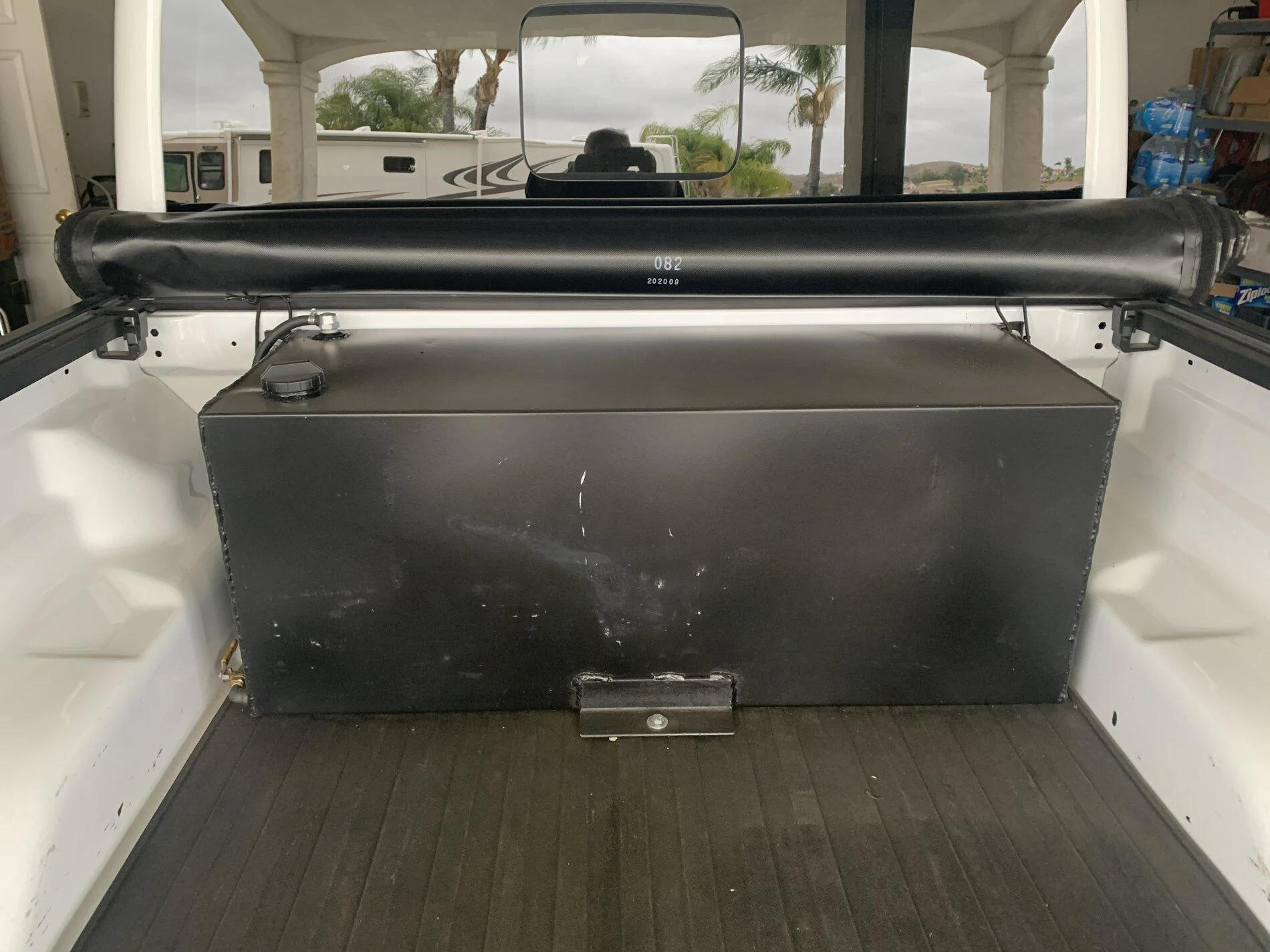

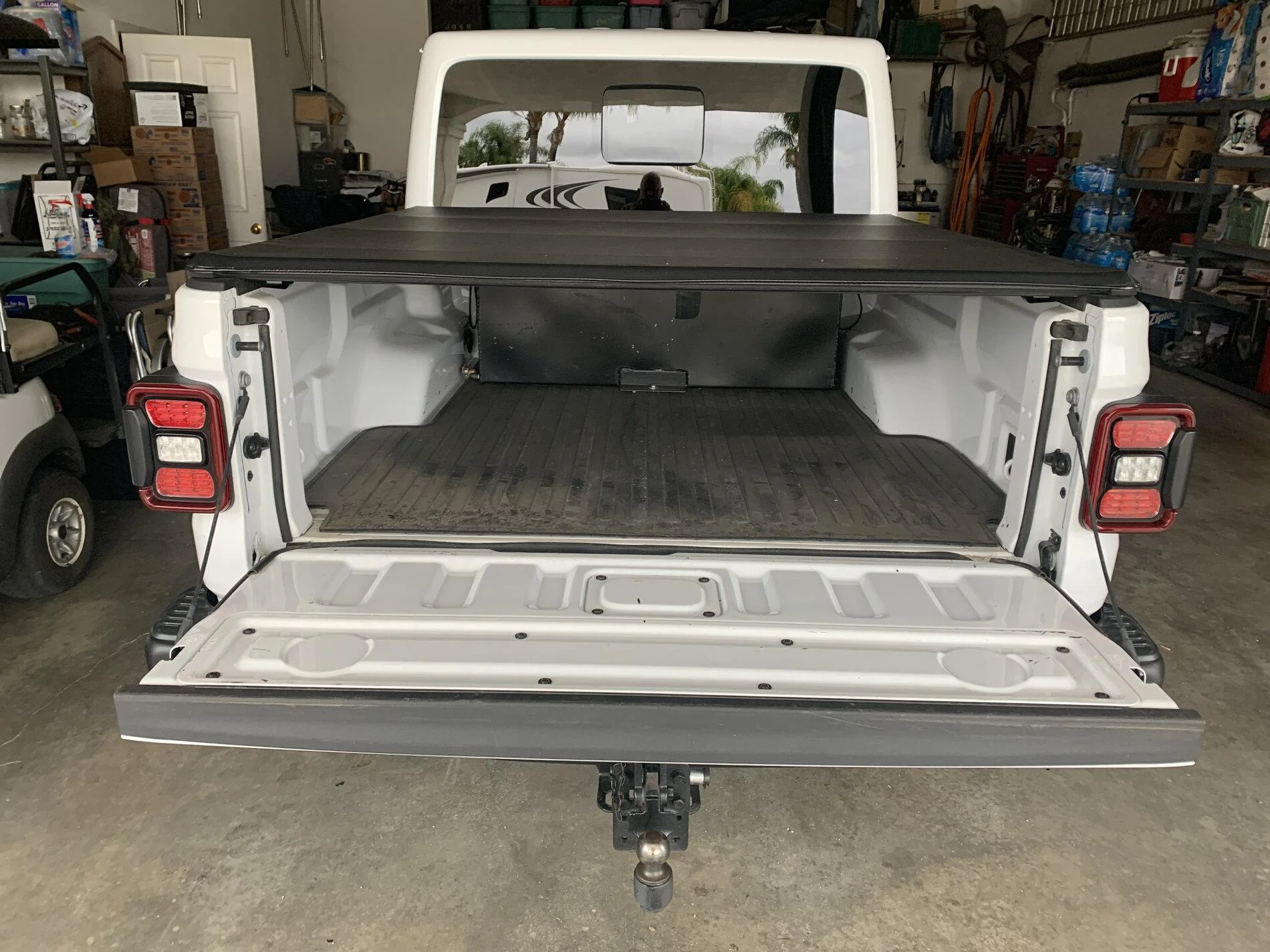

No part # the tank was custom made and installed by aero tank. Super simple open valve feeds stock tank you can use 100% of bed tank 35 + gal I fill every 6 to 8 weeks jus love it. Aero has my measurements:

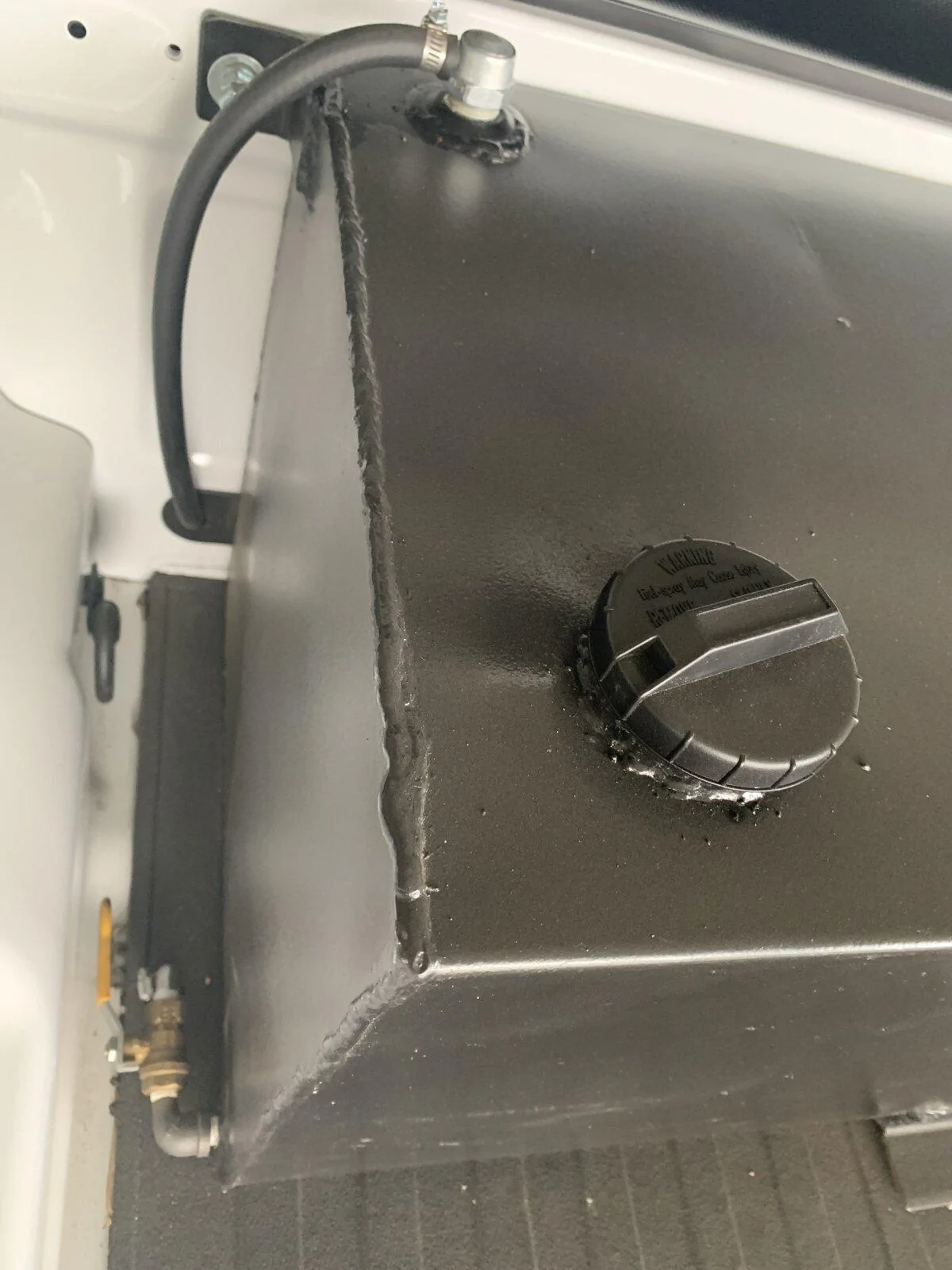

I chose not to do install but they tie into the rubber filler line between stock tank and def tank w/3/8 hose to aux tank

Thanks for the pictures. I’ve installed a few transfer tanks on other trucks and always used a RDS install kit that includes the T-fitting into the main line. Is this what you used?
Also, any issues with the fuel gauge staying full as you are driving when the auxiliary tank is filling the main tank? One of the trucks I did the gauge dropped to empty because the computer thought there was an issue after driving 100 miles with no fuel used in the main tank.
I love the idea of adding a few more gallons of fuel. I’d probably stay around 22 gallons if possible.
There is a nearby company that makes tanks that I’ve been eying. I’m just curious how it is tied into the fill line.

It shouldn’t overfill if you are using a check ball valve in the T connection at the main line. Of course this needs to be positioned correctly in order to work properly. It is designed to close the fuel supply from the auxiliary tank when the fuel is full in the main line where the connection is. This is why I asked if you used a RDS kit.
