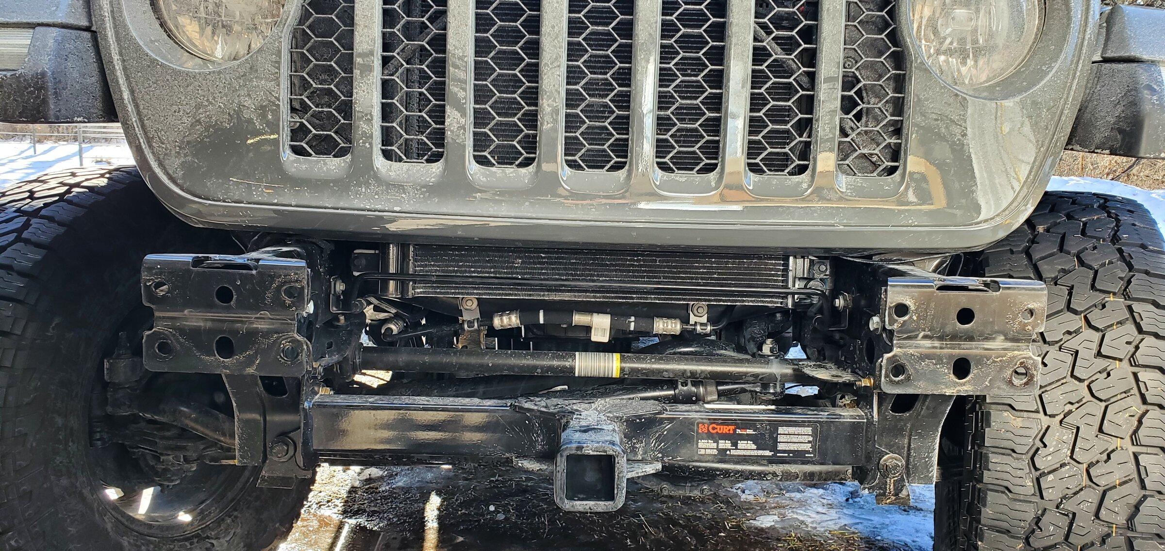

Now that summer is here, it is clear that the Diesel Gladiators will get hot if you push them ( towing ), and a LOT of us are pissed about it. Before I sell mine I want to do everything I can to see if I can make something work.

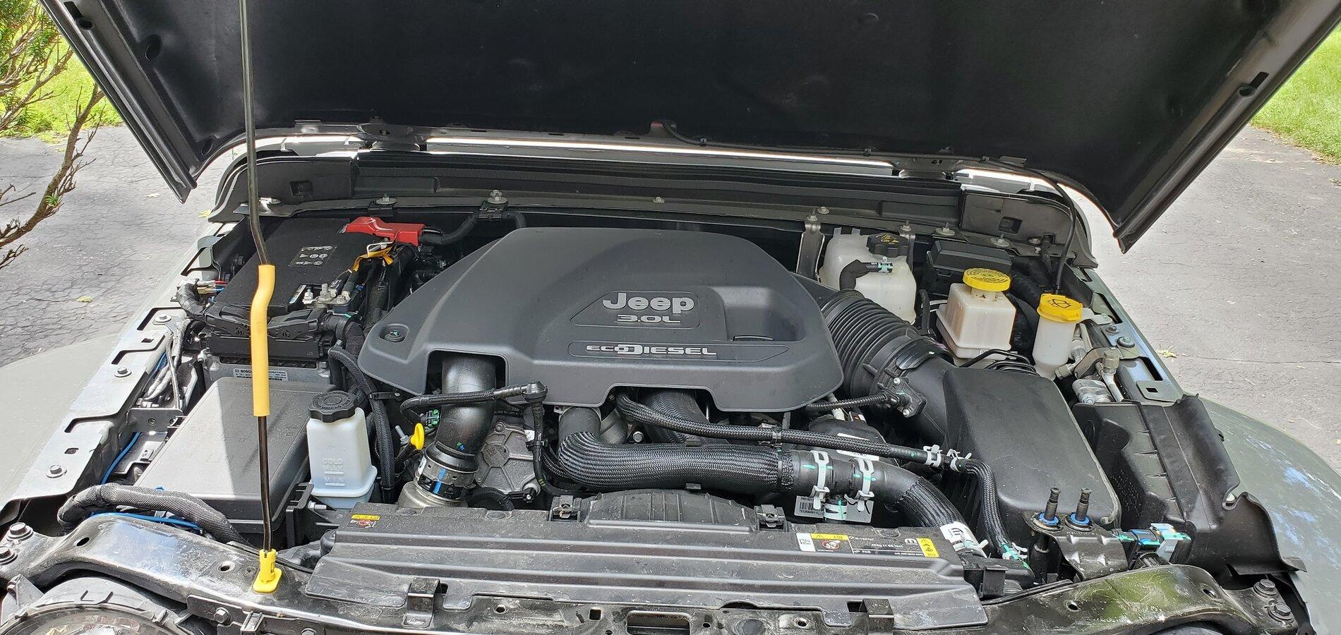

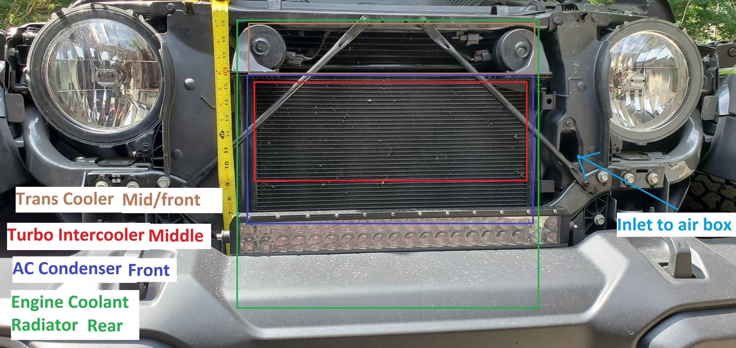

We have all heard FCA mention that the 3.0L was limited by its cooling and that is likely because they were not going to redesign the front end. Once I started dissecting mine it was clear there are plenty of issues with this current setup.

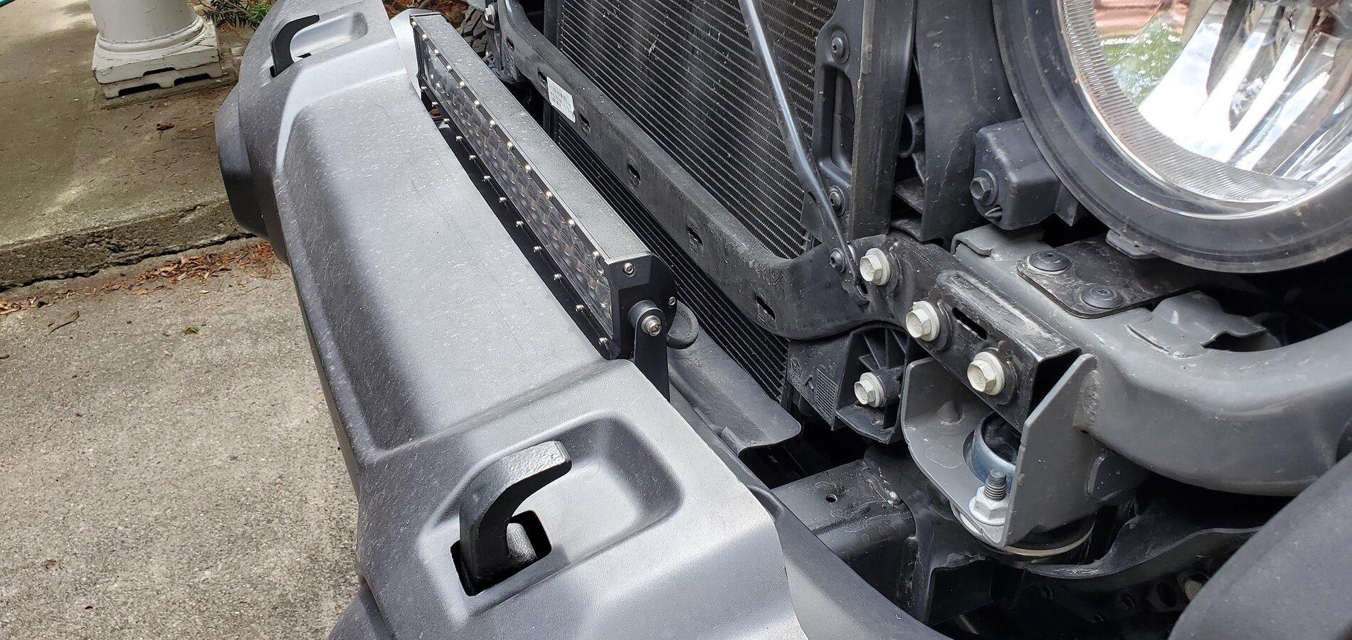

First off all the bottom 6" of the radiator is blocked by the plastic bumper.
Second, the horns should go somewhere else. Why block perfectly good airflow

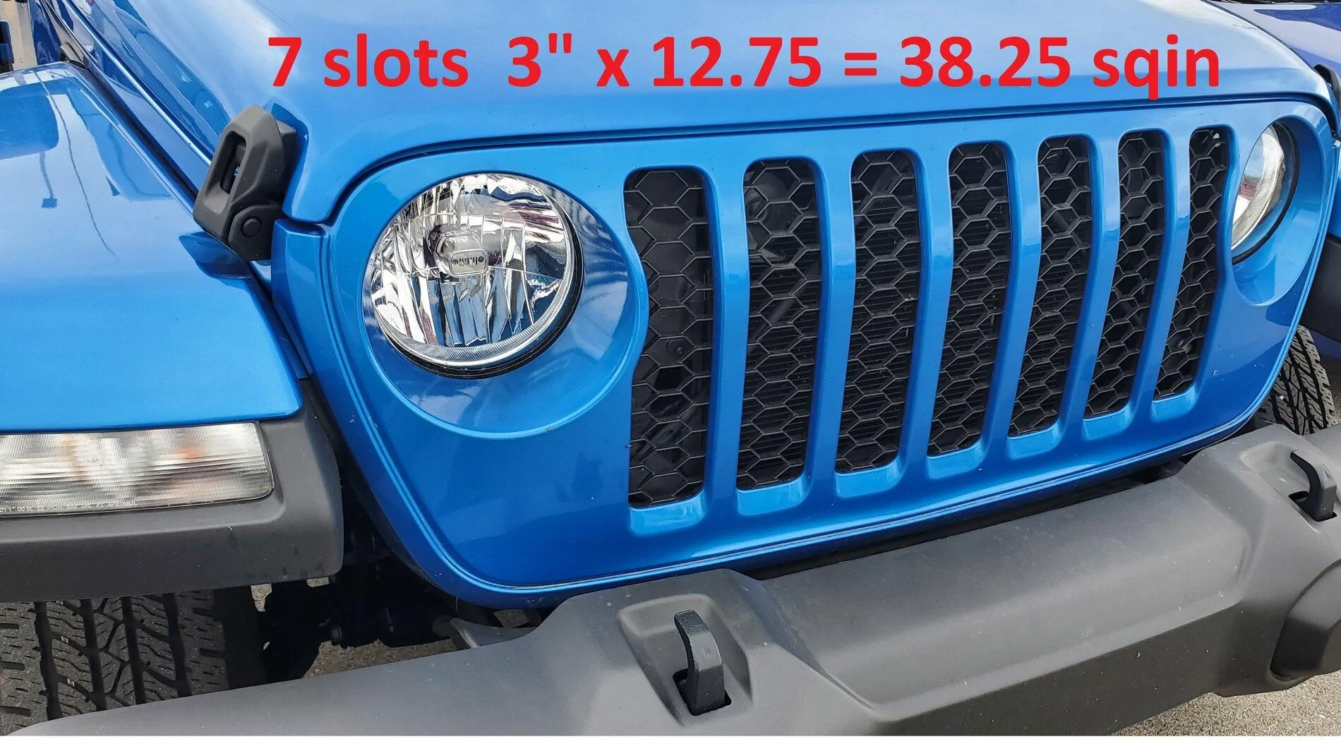

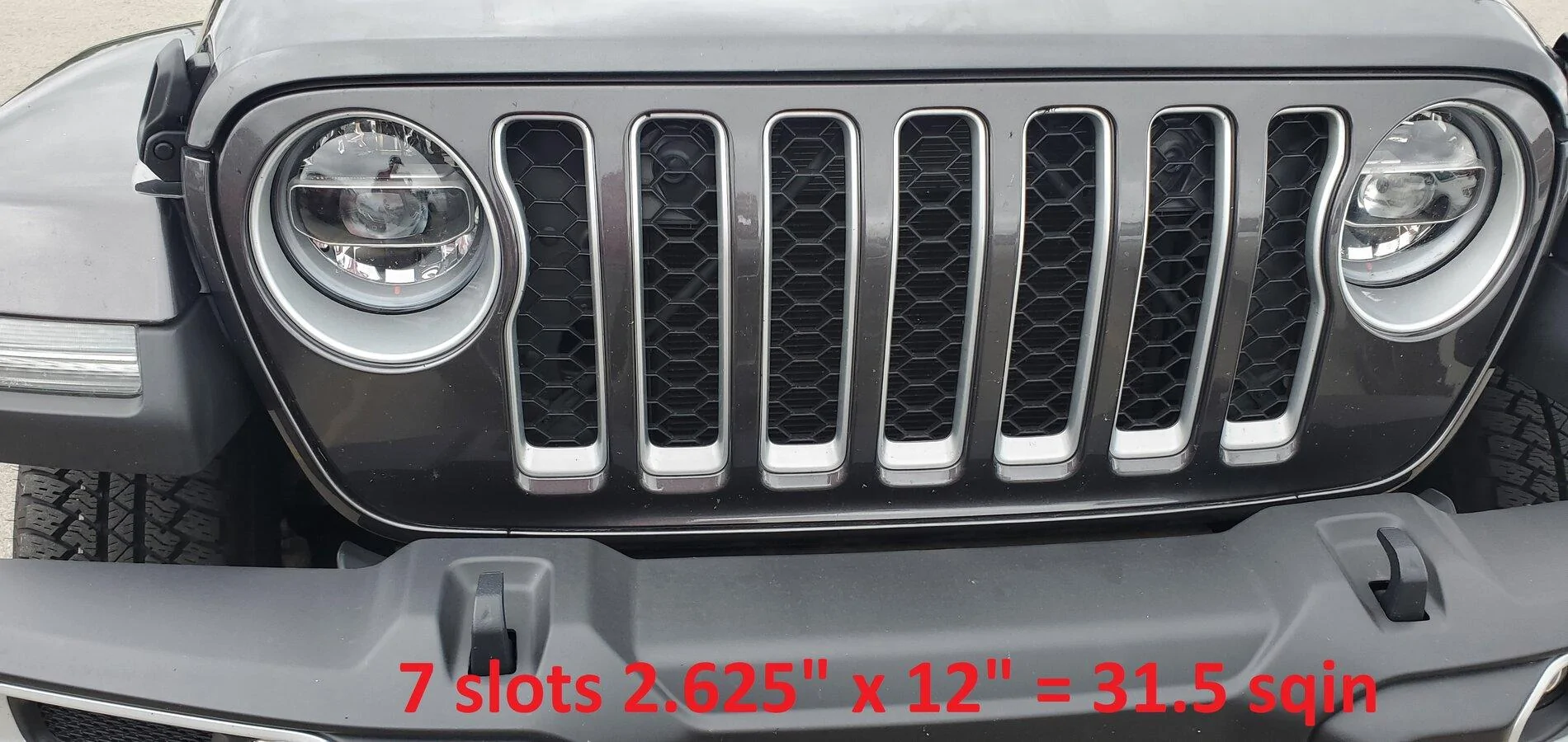

Third, there are multiple types of grills that may help air flow. The Overland and Rubicon grills have decorative bezels that narrow the slots. The Sports and black grill option have narrow slots which adds 15% area.
The next hot day I get I am going to do a 30 mile out and back trip and document my Engine Coolant, Oil Temp, Trans Temp, and add another thermocouple under the hood somewhere. I will be towing my 5600 lb camper and try to hold 70mph.
Test 1 - Remove the grill completely and compare.
Test 2 - If changes were not significant I will add to it by cracking the hood open with spacers and straps to hold it in place. Hopefully it will allow more air movement around the engine.
From here I think the results will determine if grill modifications or hood vends will do anything and what the best case scenario would be. If either work I will consider removing the front bumper.
To get an idea of "best case" I would say start looking at the RAM eco diesel forums. They have much bigger radiators and the engine is basically the same. If they are doing well and not having towing issues than maybe we can hope for that. If they are also struggling with overheating while towing than it will be a sign to sell and move on šŸ˜¢.
I would like to keep this thread solution based if possible so if you have any ideas, lets get testing.

I look forward to the results of your testing. Sadly, I doubt that you will come up with anything better than what the Jeep Engineers have already done.

After relocating the horns, can you move the front cooler forward and create a space between the two?
It would be tough because so many of the hoses are rigid and I dont know if it would be beneficial. My understanding is that you want them close so the air goes through the different coolers and not between.

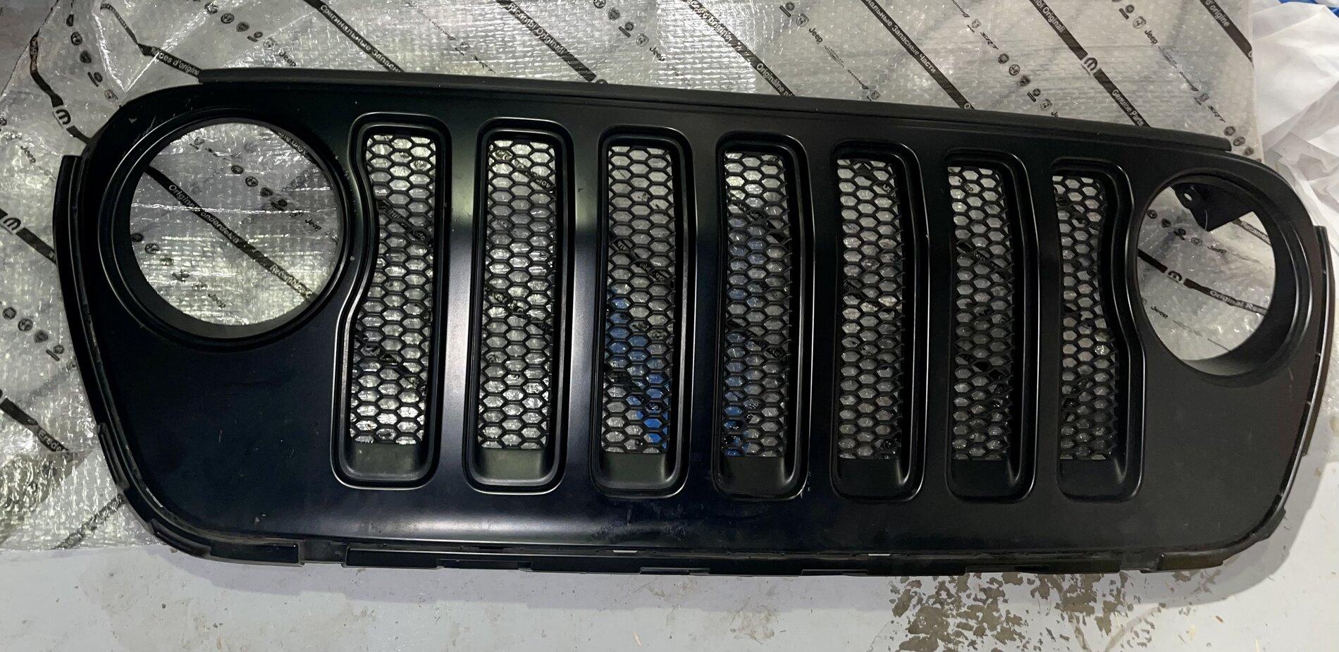

I have a used black matte grill. Took it off my JL before I sold it, had it on for two years. If you have a rubicon or model other than sport variants you already have the grill surround trim for it. Iā€™d let it go for a decent price if you want it. Pm me if interested.

I have a used black matte grill. Took it off my JL before I sold it, had it on for two years. If you have a rubicon or model other than sport variants you already have the grill surrounds for it. Iā€™d let it go for a decent price if you want it. Pm me if interested.
Jeep Gladiator Diesel cooling options and ideas 02283A53-C684-4465-B607-C24913568496
It looks like it has the ā€œdecorativeā€ parts molded in, doesnā€™t it?
Absolutely we can. We arenā€™t limited by material quality, cost, time or the need for symmetry/modularity. Itā€™s quite common to see an increase of 40% more capacity on an aftermarket intercooler because we can ditch the plastic end caps for cast aluminum. We can ditch legacy veins for a proper bar and plate config. All that applies to radiators as well. Tie in a quality active oil cooler etc. Donā€™t lose hope!
I should have clarified my statement, cost is a big issue. Can you come up with something better for a reasonable price that the typical JT owner will be able to afford?

Havenā€™t checked yet but the 392 wrangler is suppposed to have a bigger fan so dont know if itā€™s the same as ours. Or copy any of the other mods on it for cooling

Take a hole saw to the cross brace in front of the radiator.
