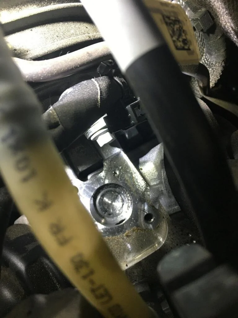

Same damn thing here! Metal shavings in the circular area. Injector pump catastrophically failed. Just happened last Friday. Dealer is telling me 45+ days for parts. 4581 miles on odometer.
Jeep Gladiator Diesel Gladiator Fuel System issues IMG_20210722_122459
