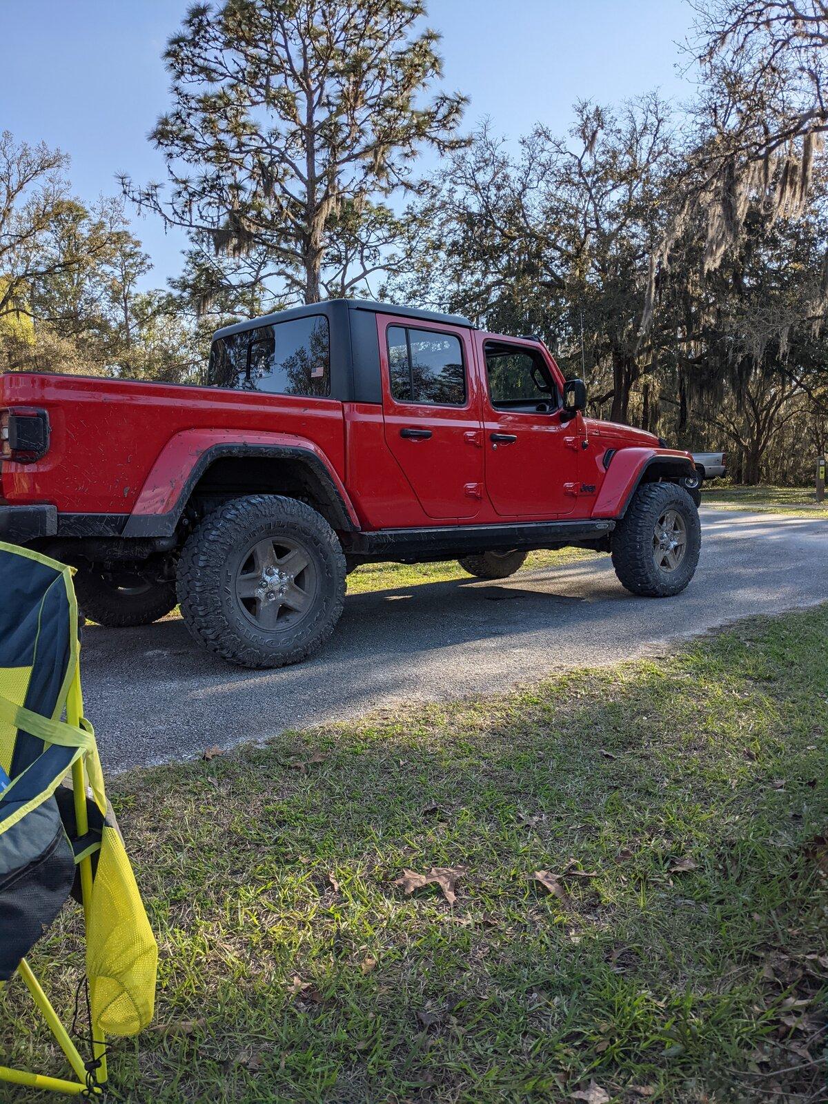

My jeep guy recommended wheel spacers and I used the stock wheels,added the Mopar 2 inch lift with 315/70/17 tires.. stock feel to the ride,no rubbing yet off road..
