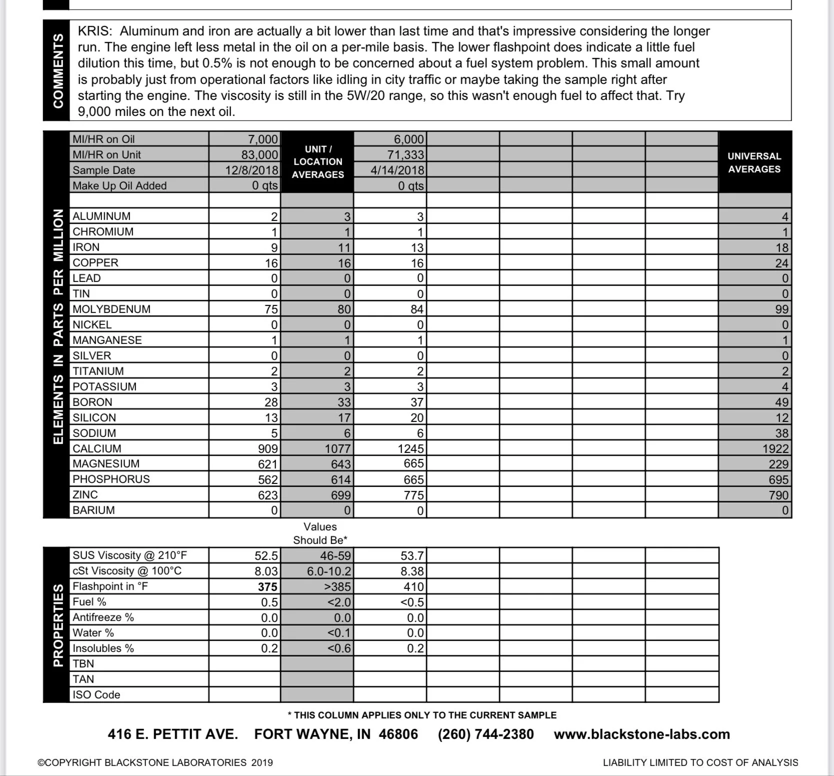

Everyone has their own voodoo on how they do oil changes, maintenance, etc but I try to follow the KISS method after doing ludicrous things like oil changes at 3k along with plug changes and really being nuts about my vehicles until the Jeep.
This was my JKU oil report from Blackstone at the 83k mile mark. Take it for what it’s worth but with my JKU, I ran Mopar filters and 5w20 Pennzoil Pure Platinum…
as for fuel, I’m in South Fl so yeah…idling in traffic.

Was your JKU a diesel? You know we are talking diesel right? Diesel with a EGR that dump soot back into the engine...
you Mojave is a gas burner and as such does way different things to oil then a what a diesel does.
