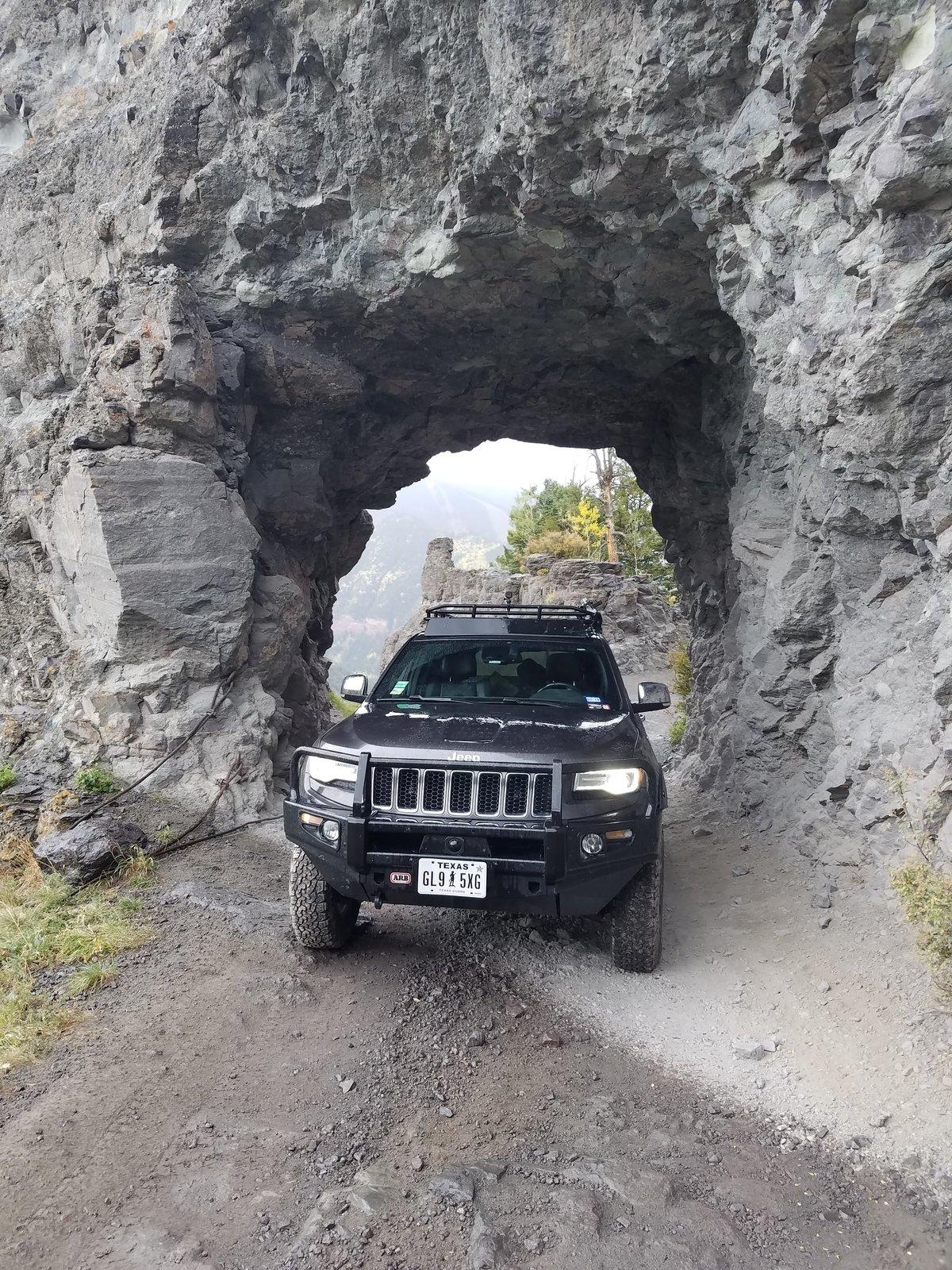

I thought that too, but my mild ecodiesel wk2 (tuned) build dropped the mpgs from 28-29 highway to 22-23 highway by just going up 1.5" in tire size (32" AT), adding a steel bumper and gobi roof rack. No actual lift on the Jeep. Now the city mpgs didn't really take much of a hit though.
I still want the diesel though. That chug sound and the low end power are great.
