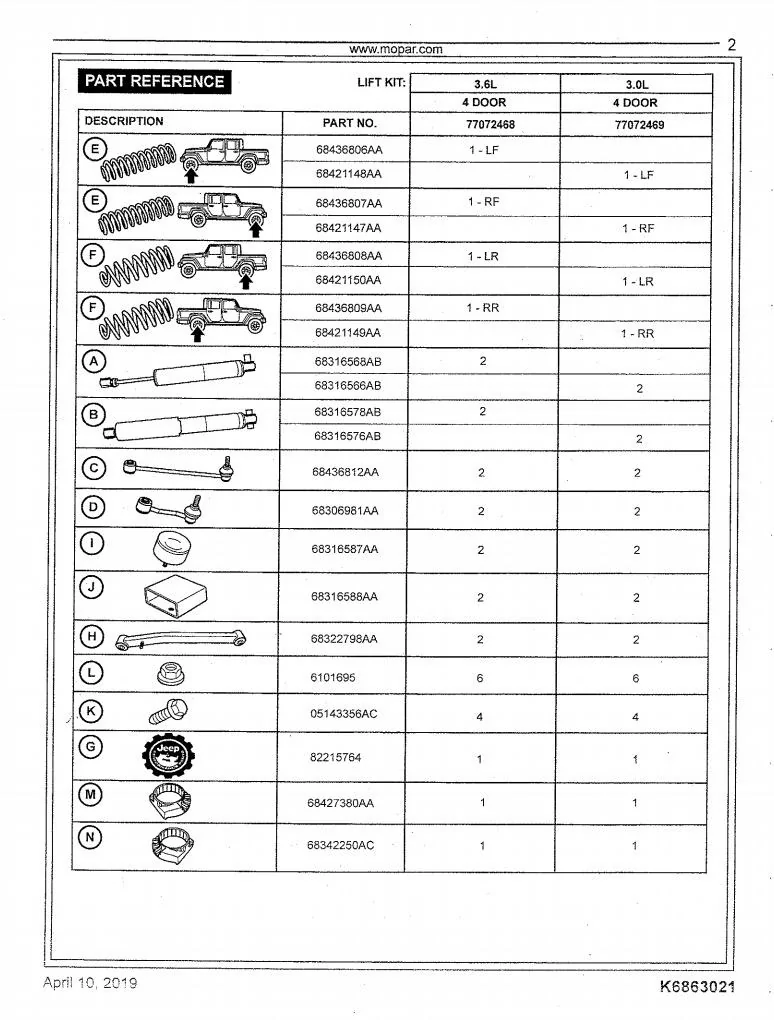

i know the springs are different in the front, but what other parts in the lift are different? i found a take off lift from a gasser. dude wants 500 for his 2 inch mopar lift he had on his gasser for 13k miles. if its just new front springs i need to find this might be a decent deal.

The springs and shocks are different:
Jeep Gladiator difference between mopar 2 inch lift between the gas and diesel? Screen Shot 2021-07-26 at 8.42.54 AM
Even for $500, I wouldn't put the gas 2" Mopar lift on a diesel, but that's just me. You can give it a shot, but since the shocks/springs are different, don't expect the lift to be 2", the ride to be better, etc.
