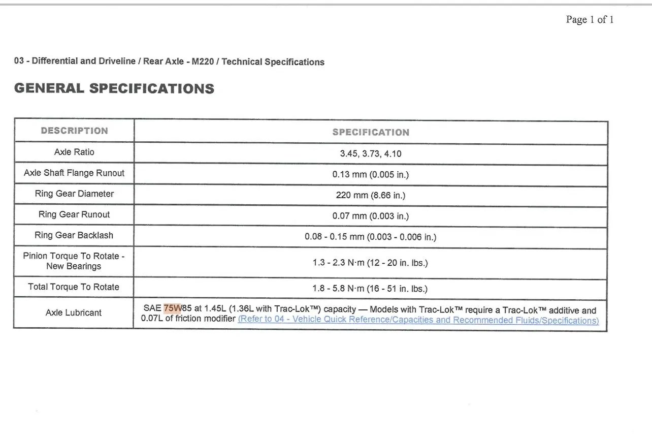

So not wanting to spend $150 to replace differential fluid for both axles (need slightly 5.25pts, so need to buy 3qts to get the needed 2.625pts), what SAE 75W85 API GL-5 Gear and Axle Oil/Lubricant is good?
I was looking at the Red Line 50105 75W85 GL-5 Gear Oil, $60 for 1gal, but the label states it is for hypoid limited slip diffs, and my Sport has open diffs.
Will that work or is there an alternative I should use
Jeep Gladiator Differential/Axle Fluid 9BFD91AB-415F-48D2-99C5-C096880164BE

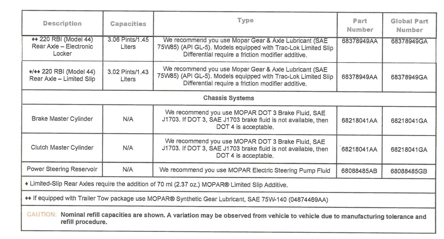

ETA: from the Factory Service Manual
Jeep Gladiator Differential/Axle Fluid def40e1e-11c6-468c-9c27-cf6ab723f4f7-jpe
Jeep Gladiator Differential/Axle Fluid f0bd6d6b-b91d-49fc-be90-f6879314d5fa-jpe
End Original Post
ETA/Update: Looks like I am getting 2 different answers from 2 different technical folks involved with the JT development.
The correct weight for my vehicle, according to the list of fluids given and a Project Manager at Jeep, is 75W-140. It is because of the two diamonds saying if the vehicle has the towing package, not necessarily the Max Tow package, to use the 75W-140. Initially he stated 75W-85, but upon further looking tow package, or in my case max tow, it meant 75W-140
Glad I checked, before changing the diff fluid.

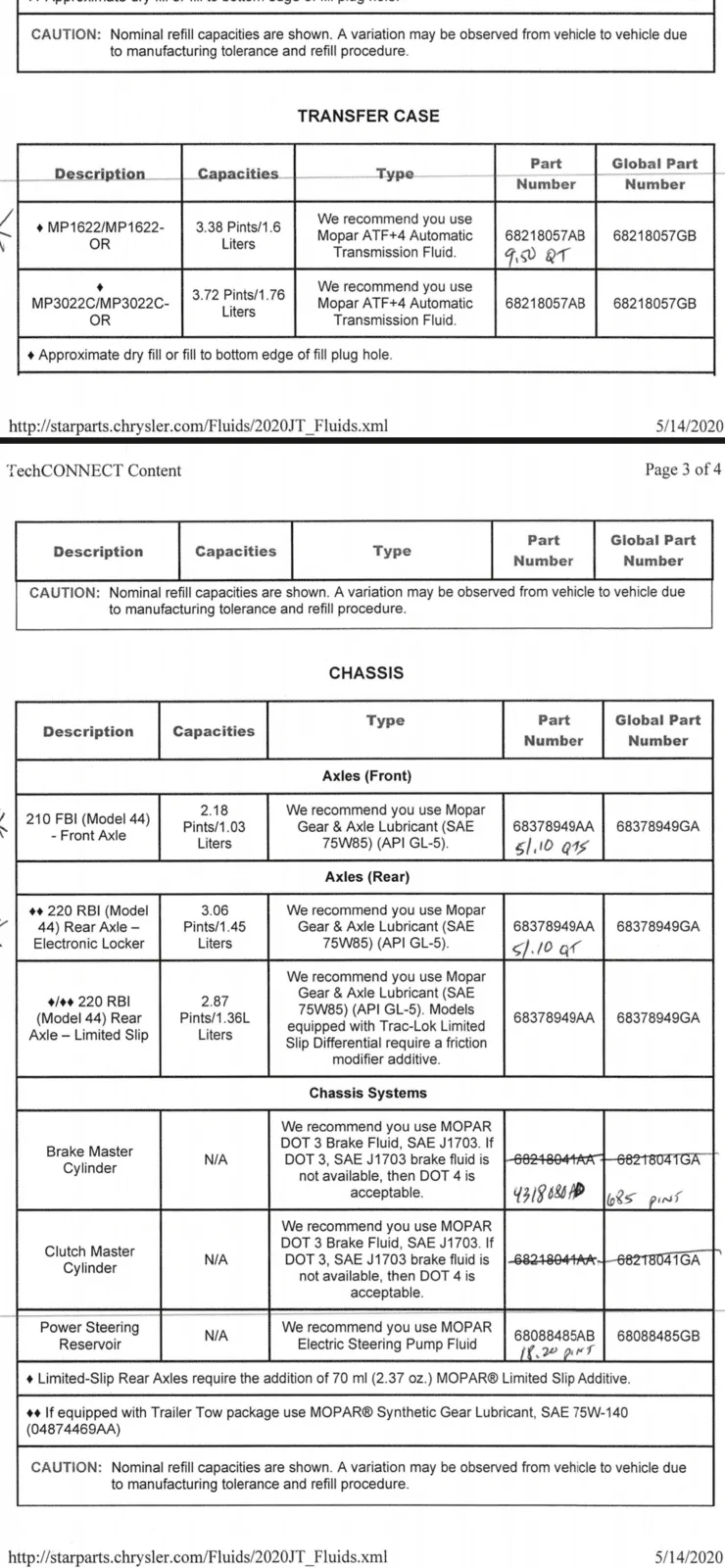

According to the dealership I use 75W85 for both front and year, this is based on the dealership looking up the correct fluid based on VIN. I understand why it would seem that the "for towing" oil would be used in the Max Tow, I just think it is meant to use that oil if you frequently tow heavy loads. Otherwise, why use a vastly different weight/viscosity for norma conditions?

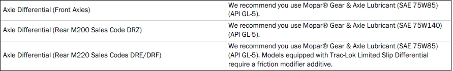

Per the manual, 75w140 is only used in the M200 rear axle (Dana 35,only exists on the JL, not JT's)

Because ramps make things easier. Why wouldn't I use ramps? Get more clearance to slide under, hands have more room to work, see things better, and the oil drains out more completely. But sure, just assume I'm a lard butt. Most guys/gals I know use ramps to change oil, Jeep or otherwise, hell even the online vids on Jeep oil changes have folks putting their rigs on stands. But you keep making life harder for yourself, go you!
You should do YOUR homework and check for details. My dealer didn't "spew" anything. They certainly didn't state 75W80, the parts department gave me a printout that stated, according to FCA, the correct weight was 75W-85. This is what they would put in to my vehicle based on my VIN, should I change out the diff fluid, chose the optional 40k maintenance of replacing axle fluid, or had the axles replaced. The 75W-140 is for folks who do a lot of heavy towing, it is not the default factory lubricant for my vehicle. I am waiting for a response from Jeep to confirm this.
Exactly.
From the factory service manual, not the user manual, not some armchair expert, the official Jeep publication:
Jeep Gladiator Differential/Axle Fluid DEF40E1E-11C6-468C-9C27-CF6AB723F4F7
Jeep Gladiator Differential/Axle Fluid F0BD6D6B-B91D-49FC-BE90-F6879314D5FA
I wonder whose "research" folks will decide to follow.
And yes, the FlexFills are available in those weights, that's exactly what I said. You gave the strong impression that they came in others, which they don't.
FlexFills are great, but not available in 75W-85, only 75W-90 and 75W-140 grades.
