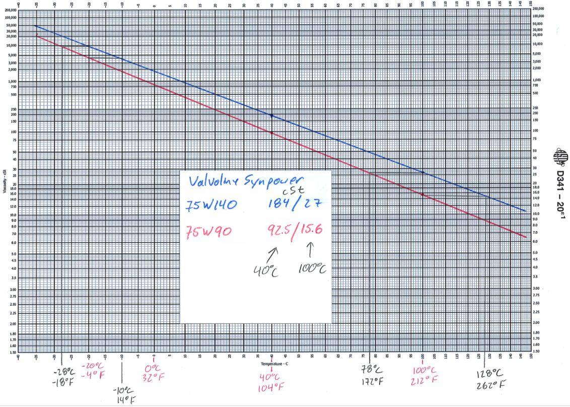

One other thing I looked at when I decided to go with 75W140 in my JTM rear diff was the viscosity versus temperature chart per ASTM D341. Over on the JL forums, there was data posted by CarbonSteel on rear diff operating temperatures, showing fairly high operating temperatures: https://www.jlwranglerforums.com/forum/threads/diff-fluid-wrangler-jl.97387/
Looking at Valvoline Synpower 75W90 versus 75W140 at 100C (212F):
75W140 provides the same viscosity at 262F as 75W90 at 212F
75W140 provides the same viscosity at 212F as 75W90 at 172F
So, using 75W140 is like decreasing the diff temp when using 75W90 by 40-50F at the 'high end' operating temperature. IMO, the increase in viscosity at operating temperature is only a good thing.
But, low temperature viscosity also needs to be considered. Since I live in CT, I focused on -20C (-4F) as my low temperature point.
75W140 provides the same viscosity at 14F as 75W90 at -4F
75W140 provides the same viscosity at -4F as 75W90 at -18F
So, using 75W140 is like decreasing the diff temp when using 75W90 by 14-18F at 'cold start'.
Excessive viscosity is not necessarily a good thing at cold start. But, IMO (for my use case), the increase in viscosity from using 75W140 falls within the viscosity range for 75W90 at design low-end temperatures.
Jeep Gladiator differential fluid for towing rubicon 50 towing. 1730992520244-mq
