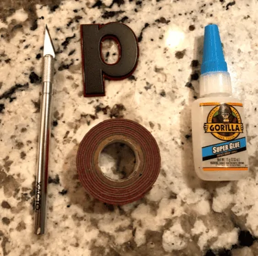

Now for the fun part, the supplies and tools you will need for this are pretty limited:
~Utility knife with extra blades
~Gorilla Glue
~ Removed (or preferably newly purchased(links at bottom)) emblems
~ Outdoor use double sided sticky tape

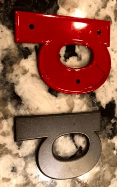

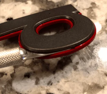

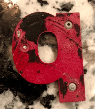

The Emblems are actually composed of 2 separate layers that are held together by several pins. If you turn the emblem over (after the adhesive is stripped away) you are able to see the locations of the pins.
You are able to wiggle a utility knife between the layers. Once in-between slide the knife around until you are up against the first pin, gently twist the utility knife and pop out or break the pin to separate. Work your way around the letter until you have done this to all the pins and the 2 layers come apart.

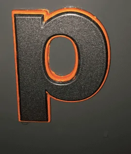

Paint. I painted mine with Mopar PL4 or Orange Crush paint. I will probably do this again in a few months with some new emblems and start with a nice coat of primer and then go into the colored paint. I think my finish is "good" but I would not qualify it as "great". I certainly learned a lot with the 3 separate sets I have done. My first attempt I had painted the whole emblem orange and attempted to remove the top section of paint. This is when I found out that the 2 broke apart. I essentially did this set all over and the results are better. Long story short, take your time, do it right and learn from my process and they will look great the first time.

Once you have applied 3-5 coats of paint to the bottom layer, let them dry for about 24 hours. After they have dried, put few drops of Gorilla glue on the center of the freshly colored lettering and line the granite top pice up before lowering it onto the glue. Recenter the top and hold it together with clamps as the 2 pieces permanently bond together.

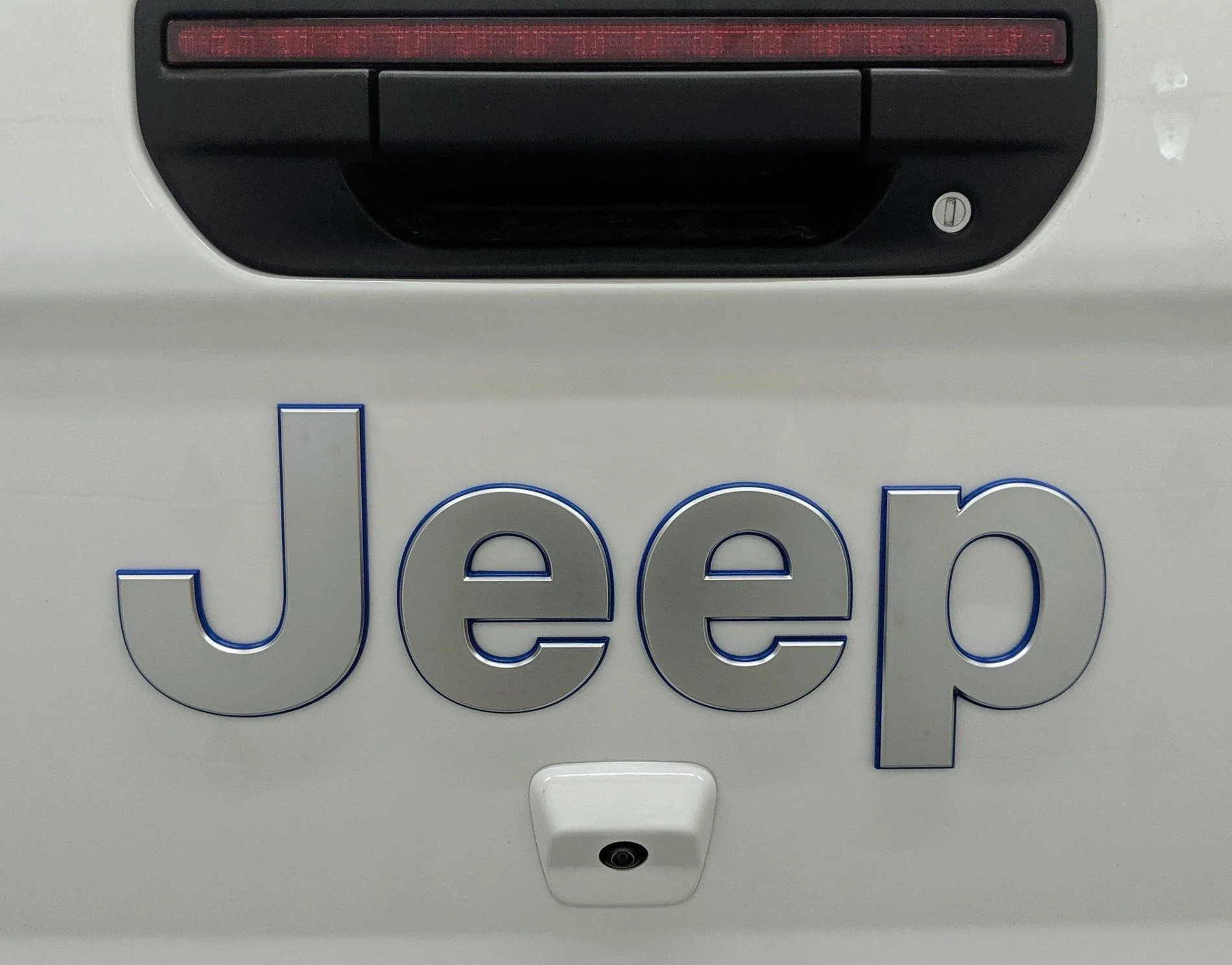

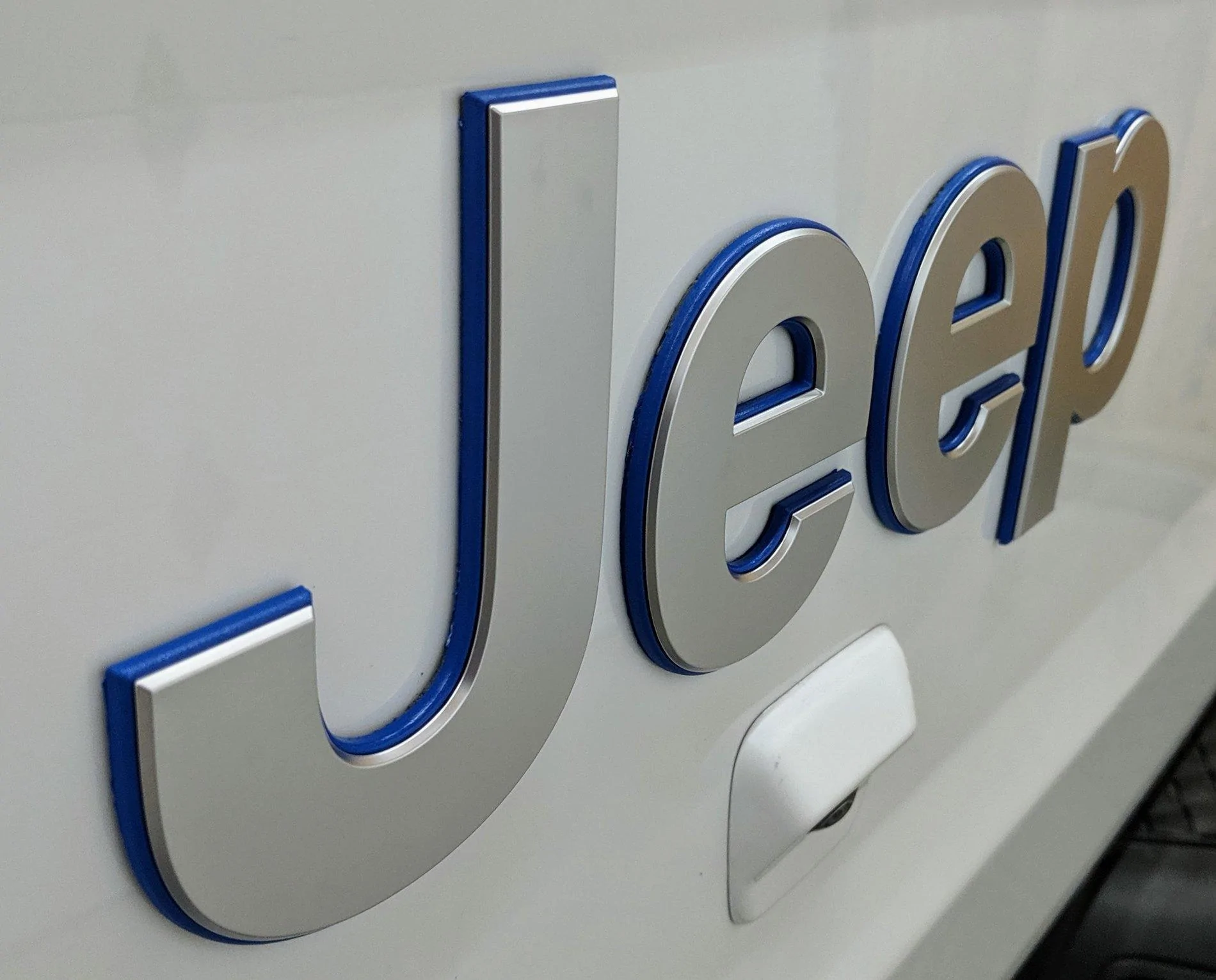

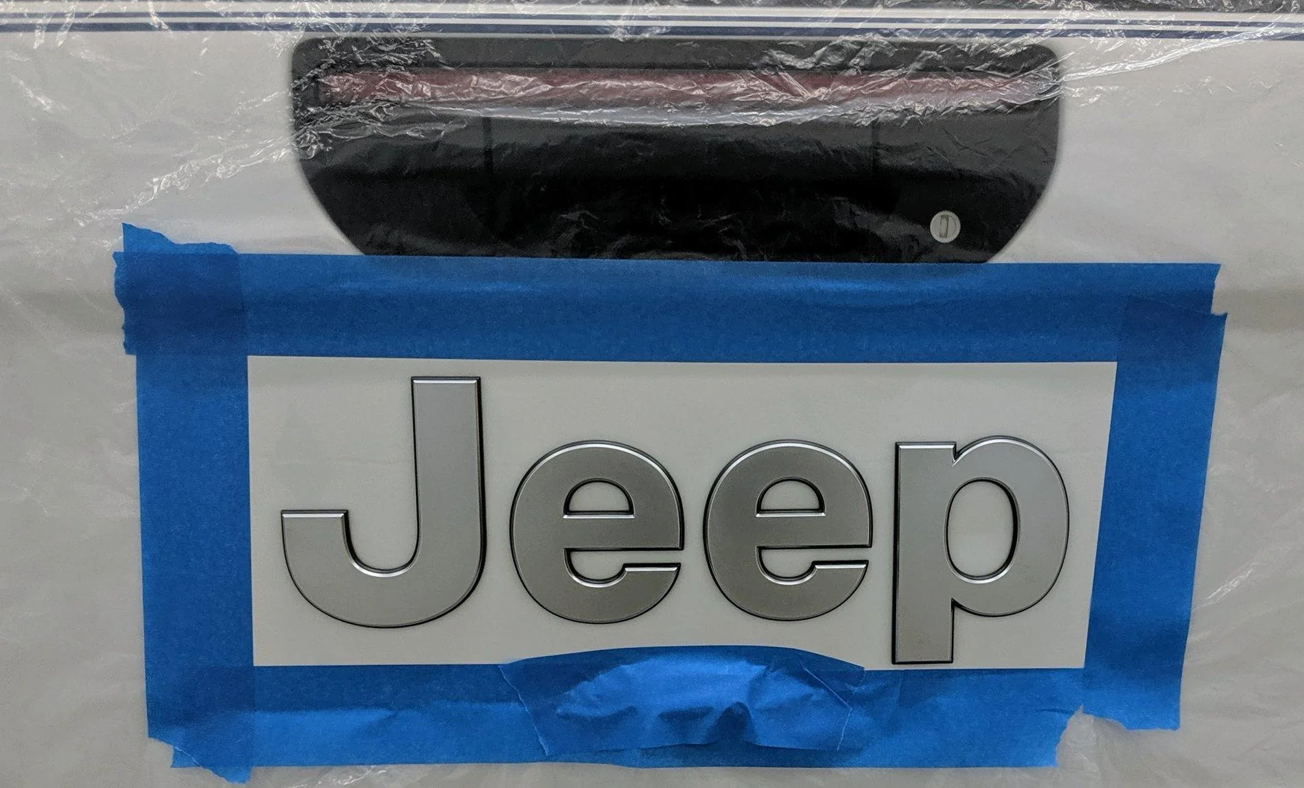

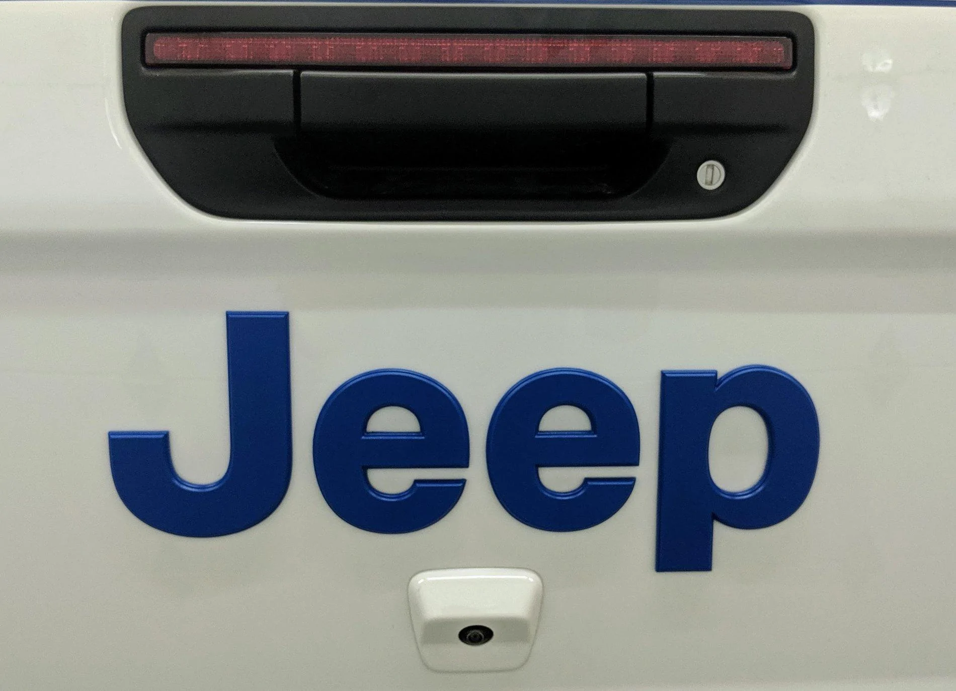

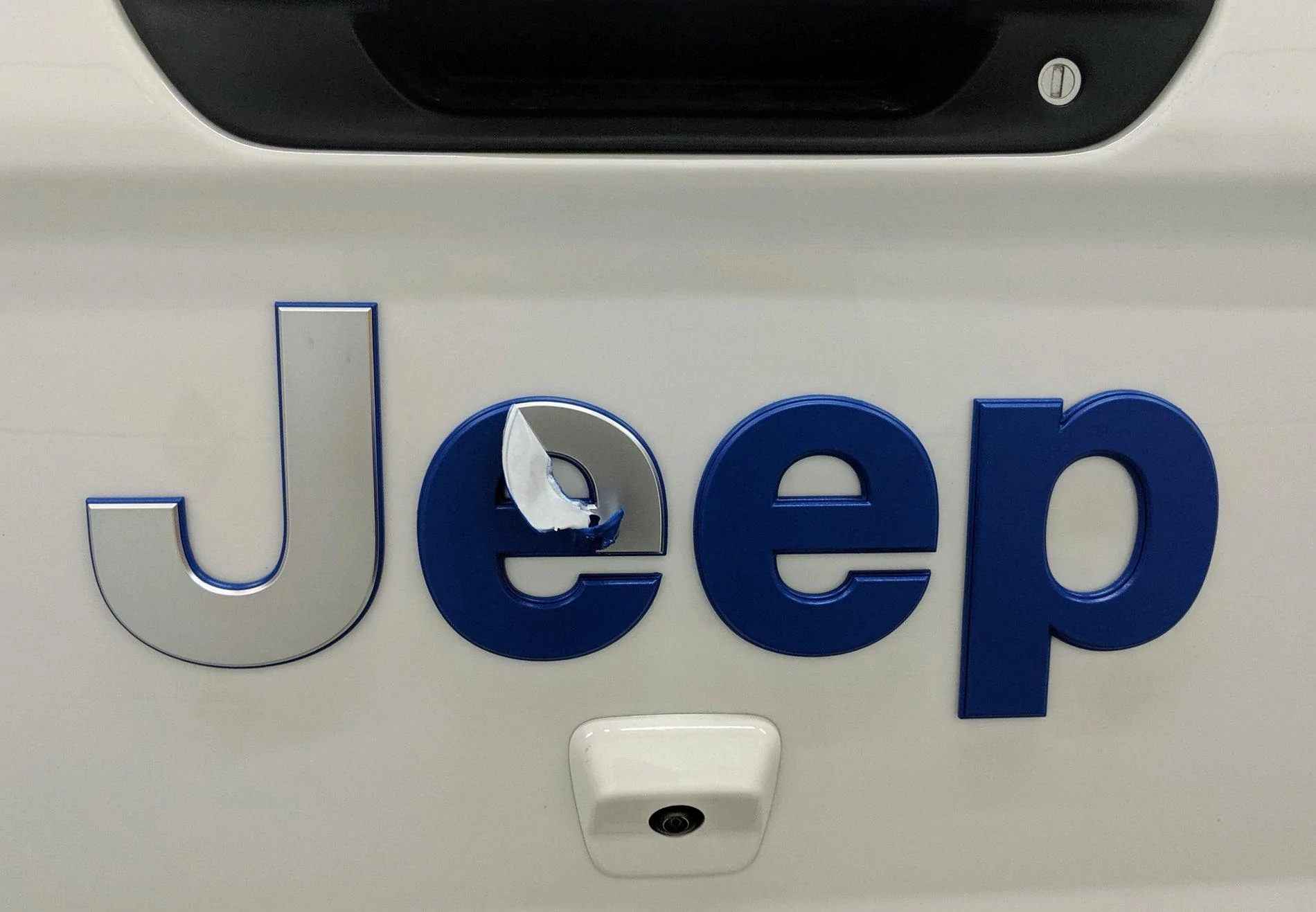

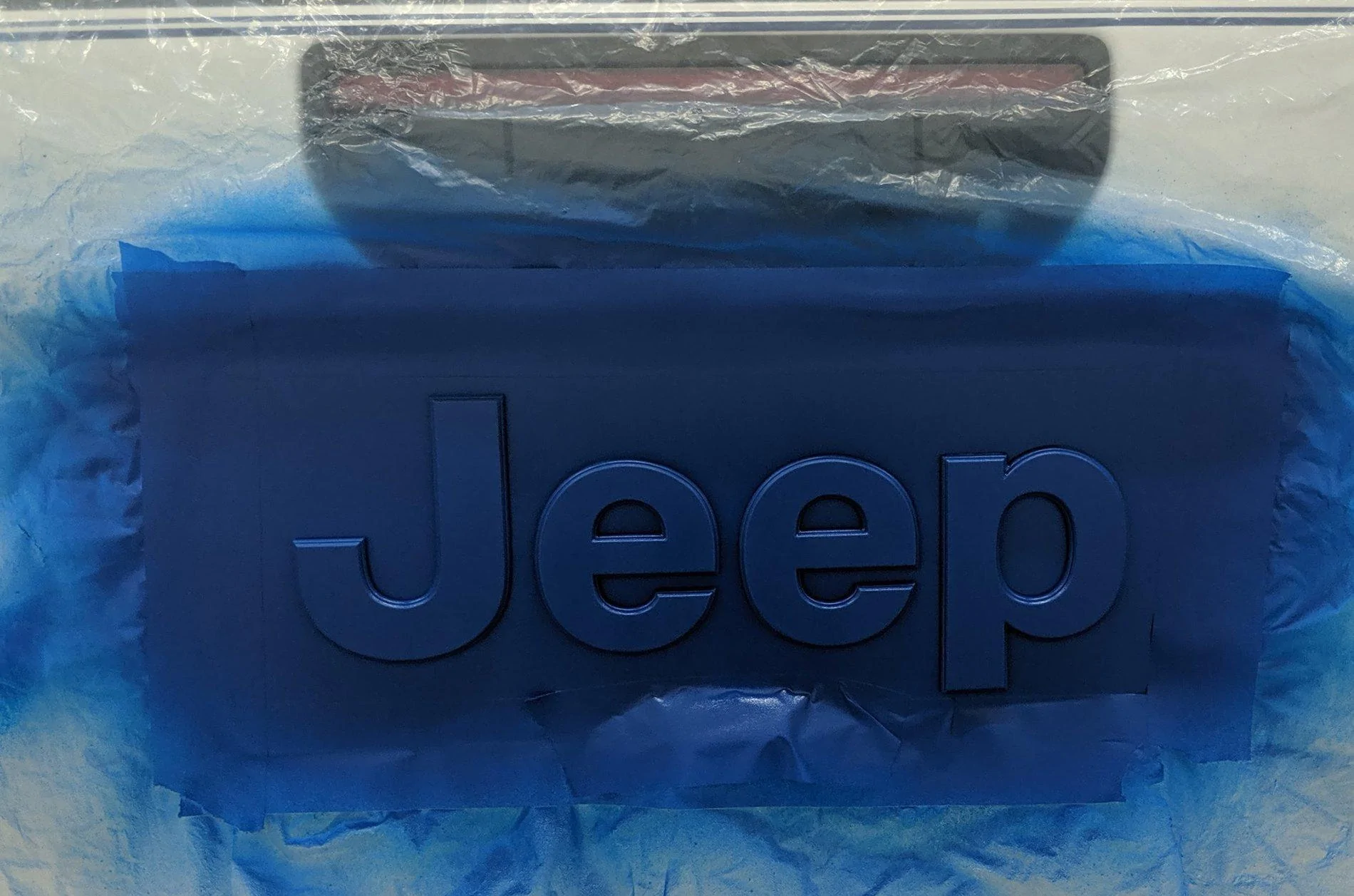

I really like that subtle outline around the letters. I successfully attempted to do the same without removing the letters by using Plasti-dip spray.
Here's what I did:
1. Tape off the area around the letters. Note you WANT to spray on the tailgate so you can peel it off the letters (step 3 below).
2. Spray around six good even coats of Plasti-dip and let dry. Hedge on spaying too many coats than too few.
3. Peel away the background. It will easily peel at the edges of the letters
4. Peel away the top layer. Again, this will easily peel away where the two plastic parts meet.
It's very subtle, but matches the rest of the blue around my JT very well. Thanks for the idea @bangolia !
