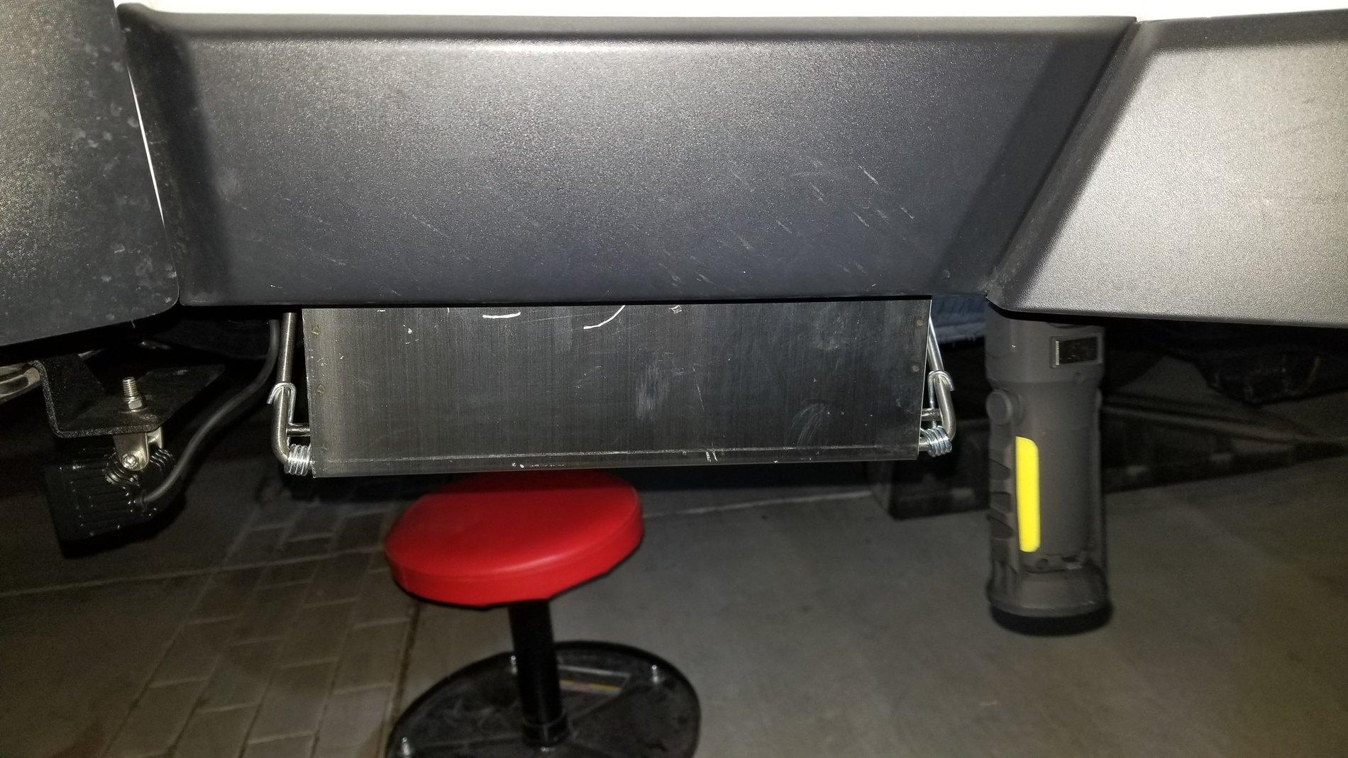

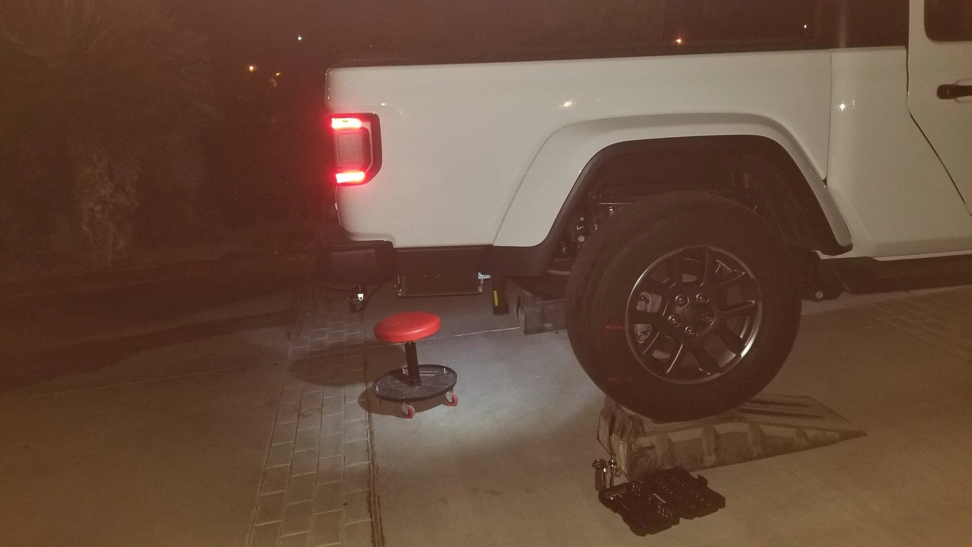

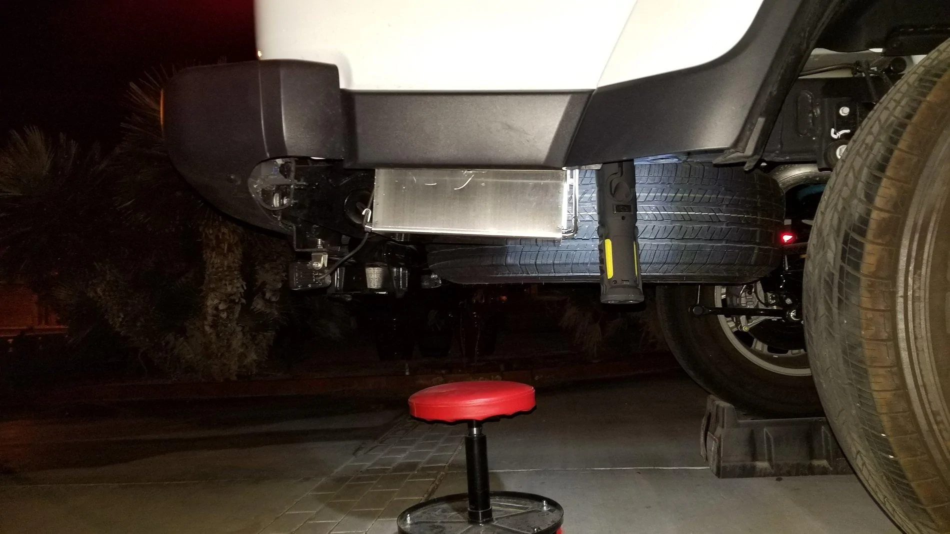

I'm putting in an Auxiliary Battery. Technically, this is a triple battery system, as the stock batteries will remain where they are. I'm going to post some pictures and update it as I work through the install.
I found a stainless steel battery box that fits behind the right rear wheel. I'll be using the Cole Hersee Smart Isolator that is in the Genesis Dual Battery System. I'll be adding a dual voltage display in the cab, and a button to activate the battery boost function. The wiring is probably more expensive than necessary, since I'll be using Warn pre-terminated cables with Quick Plugs to connect the battery in the back to the Isolator mounted by the battery. The battery will be a 34M deep-cycle Marine style.
I've now got the battery box mounted, and have ordered the smart Isolator and cables.

My plan was to provide a separate battery to power the winch and lights, and possibly other items in the future. I didn't want issues with running the main battery too low, but wasn't willing to put out the $1200 for the Genesis kit and two new batteries. I also didn't really like the idea of removing the ESS battery from the system. I decided to try something a little more flexible, and hopefully less expensive.
The 'brains' of the setup is the Cole Hersee Smart Isolator. It allows front and rear batteries to be charged, use of both batteries for accessories, and prevents the main battery from being discharged too low to start the truck. Genesis uses a version of this in their dual battery kit. They even sell a model of their G Screen to work with this isolator.

I used Warn cables with Quick Connect Plugs to power my winch, which is installed on a removable front receiver mount. They sell a cable kit (20 and 24 foot long) to put a Quick Plug at the rear of the vehicle. I'm using one of these to connect the battery in the rear box to the Smart Isolator and Winch in the front. The short version (usually attached to a winch) is connected to the rear battery, and the 7 foot version (used to provide a Quick Plug at the front) could also be used to connect to the rear battery and provide a Quick Plug at the hitch. I'm using the relay that comes in the long cable kit with an AUX button to control power to the Quick Plug for the winch. I also used a SimpleAUX kit to make wiring to the lights and relay easier.

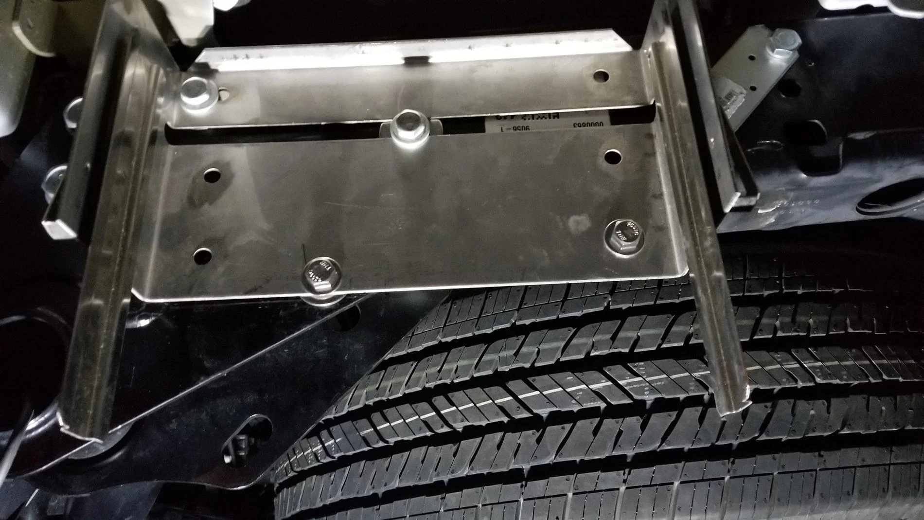

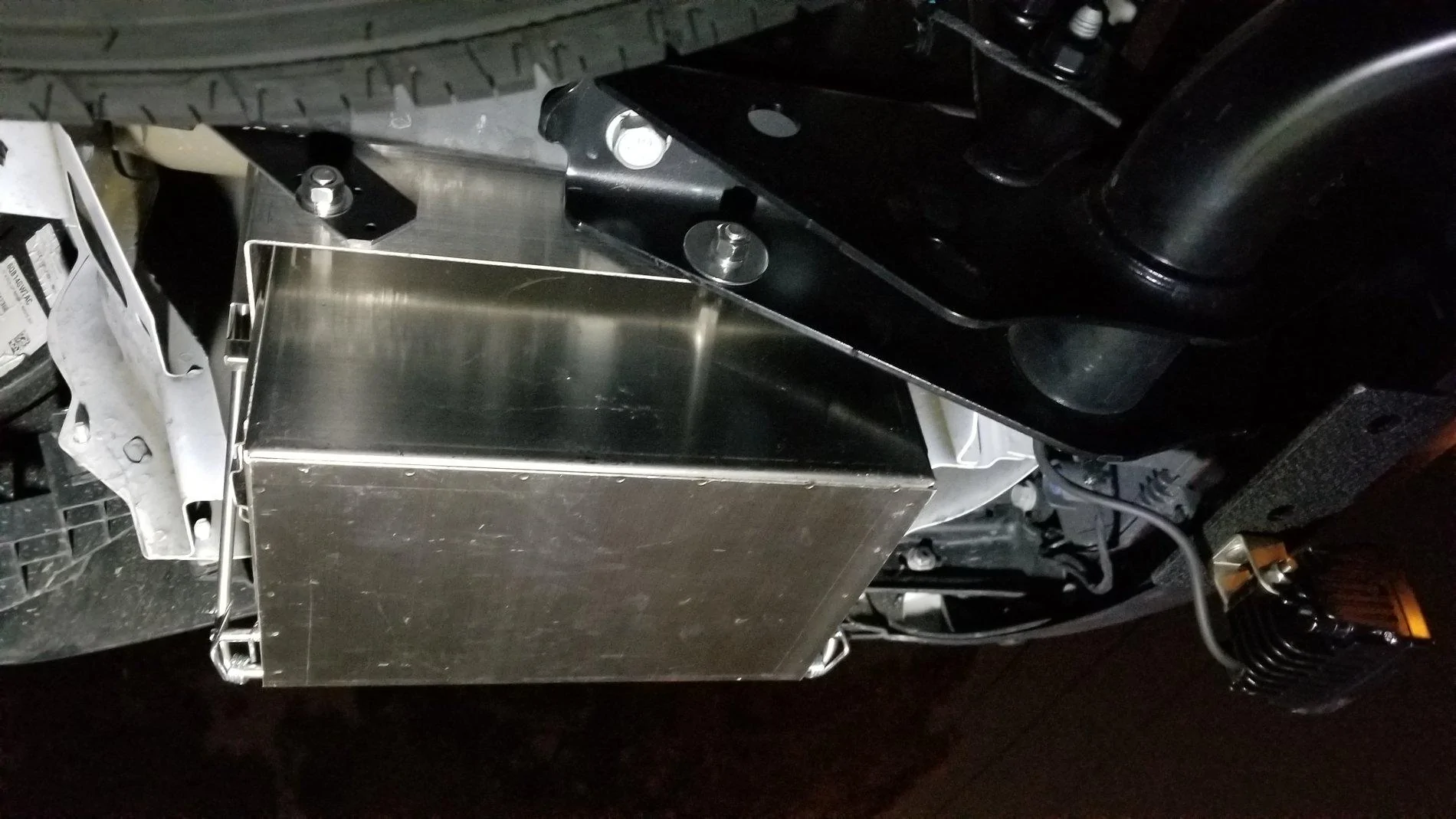

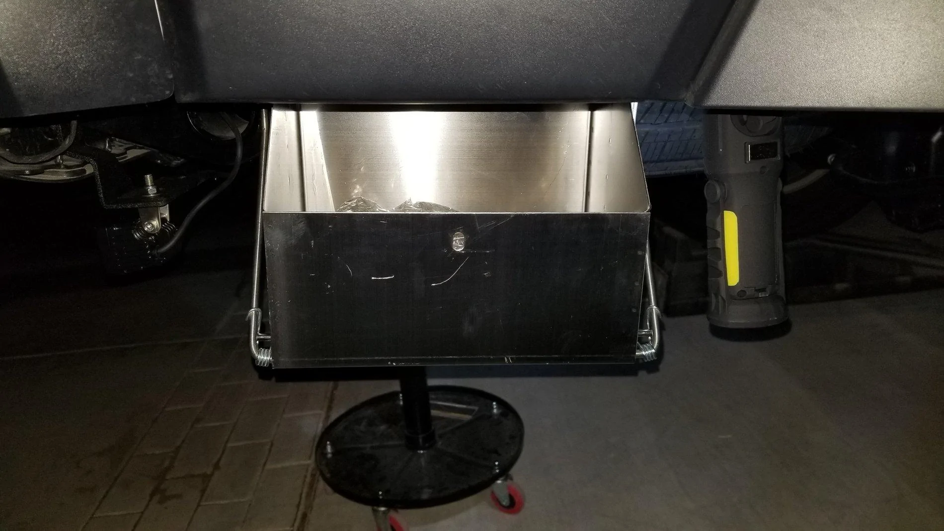

I searched quite a while, did a lot of measuring and comparing, and finally found a battery box that would attach to the frame behind the right rear wheel. I went with a 34M Marine style (deep-cycle) AGM battery that is intended for draining and recharging (which regular automotive batteries are not), and fits snug inside the battery box. I used the two 10mm bolts left over from the front receiver install to attach the battery box to the bolt holes already in the frame, with some fender washers behind to level it out. I used a nutsert to add another 10mm bolt and strap for additional support, and some 3/8" hardware to secure it.

The 'Boost' button allows for the Isolator function to be overridden and ties the two batteries together for 60 seconds. Essentially, a built-in jump starter if the primary battery gets discharged too low to start the engine.
Under normal operation, the isolator monitors the voltage and keeps the auxiliary battery disconnected from the system until the primary battery is charged. It then lets the juice flow to charge the auxiliary battery. After both are charged, it parallels them together increasing the available capacity. When the voltage drops to a certain level, it isolates the batteries so they both don't become discharged. The loads (lights, inverter, etc.) will operate until the battery they are connected to is discharged, or the device(s) turn off from a low voltage condition. If the loads were connected to the auxiliary battery, the primary battery is available to start the engine and begin the charging process. If the loads were connected to the primary battery, the boost feature can be activated to start the engine using the auxiliary battery. Using relays allows the loads to be powered by the auxiliary battery, but still be triggered by the AUX switches. Without using relays, all loads tied to the AUX switches are powered by the primary battery.

Great idea.... but isnt there a spot midship that would tuck higher. Like passenger side of the driveshaft? Im fairly sure I'd destroy that box in that location.

The bottom of the battery box sits higher than the spare tire and the hitch. There's really no other easily accessible place to put it. If you're doing things with your truck that would destroy the box in that location, then the Genesis Dual Battery kit would be a better option.

Bill, I'm curious - where did you run the cables from under the hood to the battery box? Got any pics of the underside?

I'll take some pictures when I start working on it again. The cable runs behind the fender liner, with the factory wiring, and down across the top of the frame rail. It goes over the back corner of the fuel tank and follows the brake lines around and then across the top of the frame behind the rear wheel. The wiring kit comes with about a dozen huge zip ties that made it easy to secure the wiring to the frame rail.

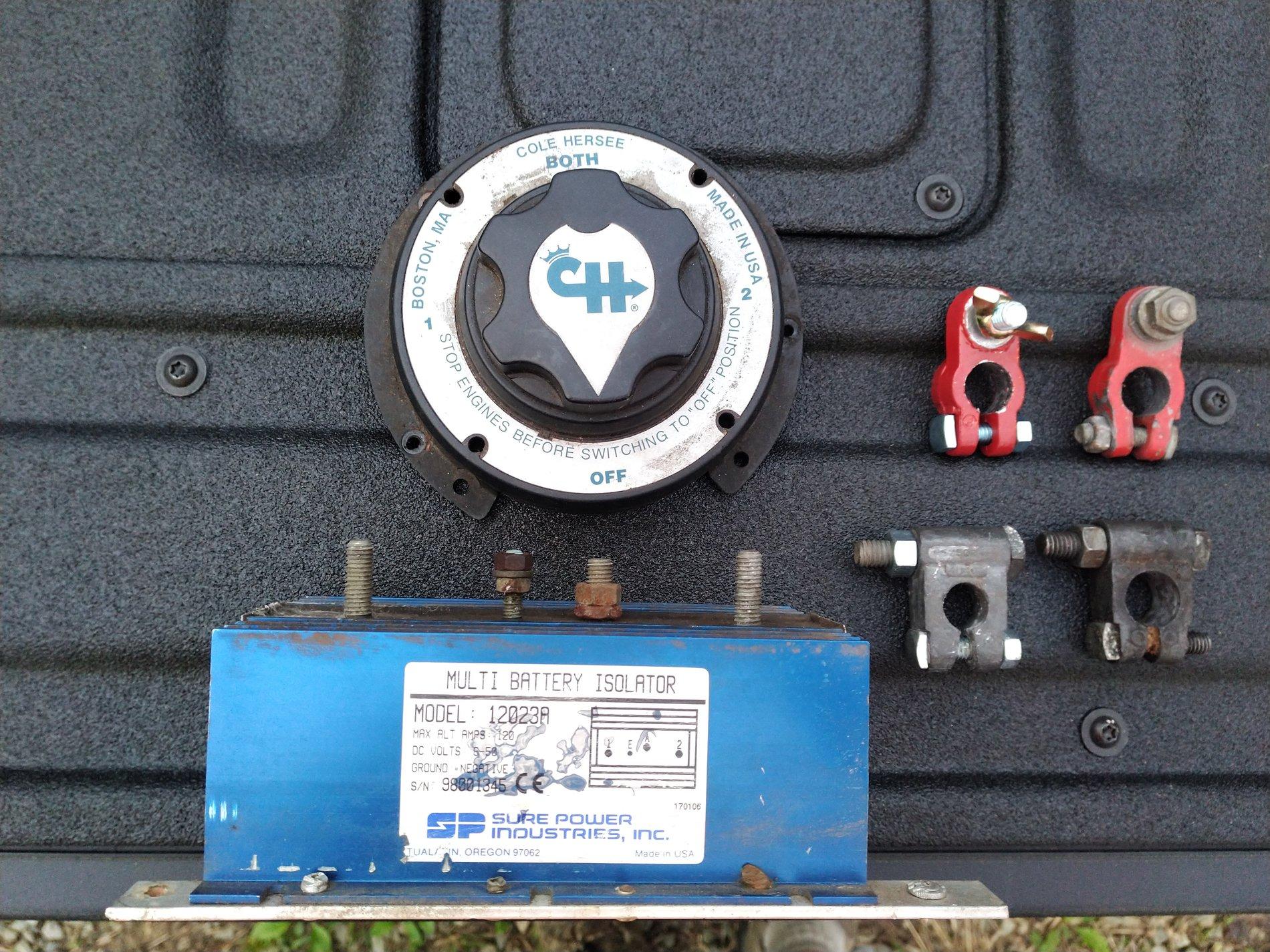

As I read this I started thinking about the setup I had in my XJ. It was very similar I was using the older Tec for battery splitting the (finned blue one) my second battery was in right rear end of XJ in the cubby hole. Warn winch power cable for winches and the cutoff. I had to "pop" the hood and have a duel battery switch for battery selection. But I did it back 20 years ago so nice update on available new tec. No canbus then.:like::like::like:
