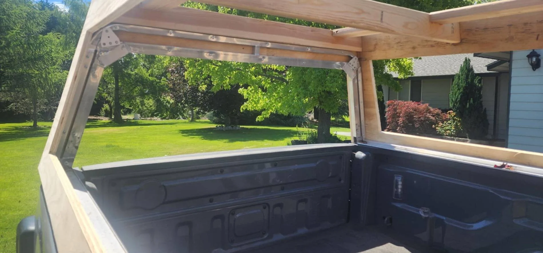

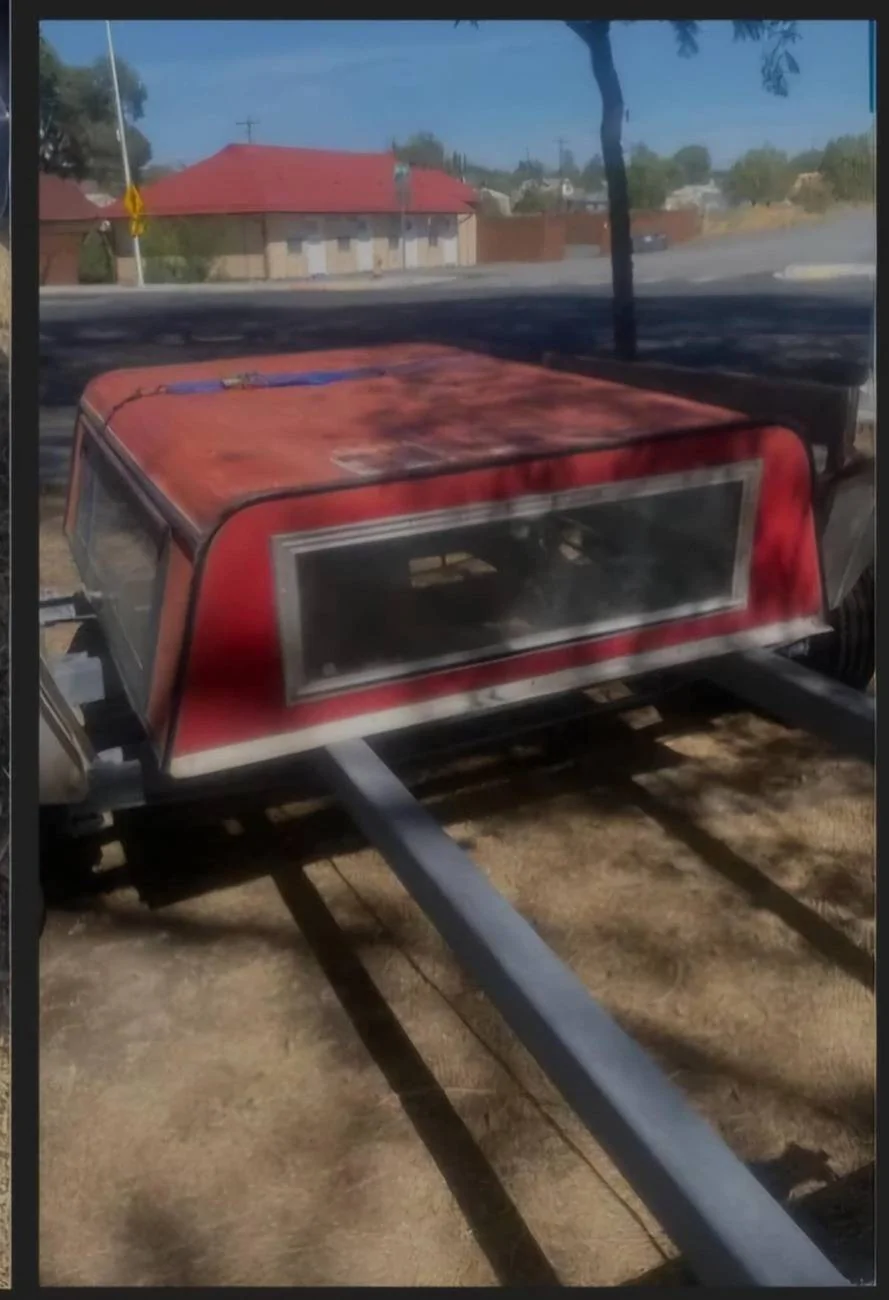

I have been wanting to get a camper shell for awhile now. I Just have not wanted the price tag that comes along with them. I want something heavy duty for a possible roof top tent build later this summer. So I found a 25 dollar s10 camper shell on Facebook market place and began to chop with a goal to keep this under 1k.

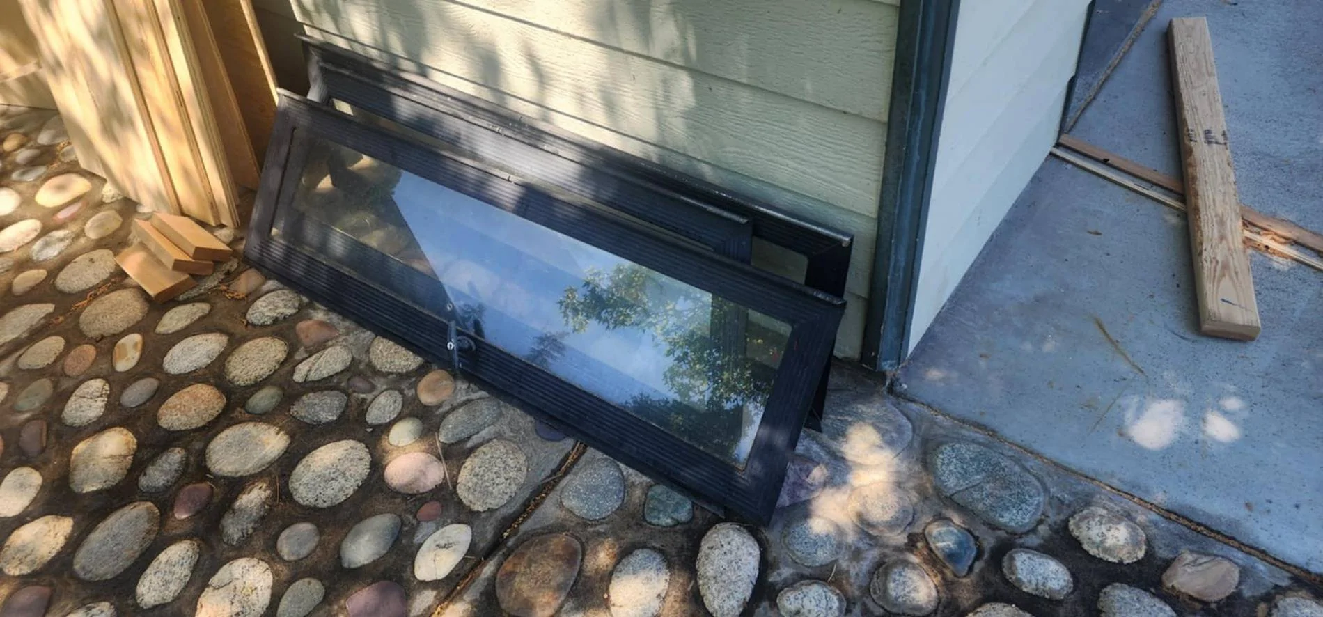

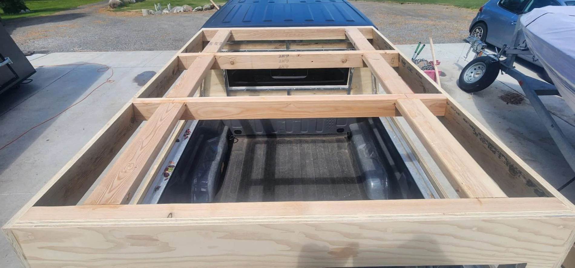

The plan is to shorten the frame, reuse the bed rail, front and rear sections, and the doors and window. Then use 3/4 plywood on the sides and 1/2 for the roof, reinforced with some 2x4's.

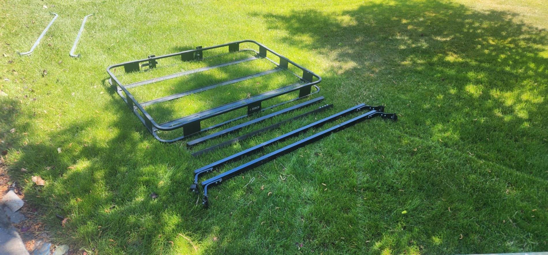

I have an old surco 45 x 60 roof rack basket sitting on an old XJ and will be using that. For the mounts I will be using some heavy duty 2x4 trailer stake pocket brackets. I will be spacing them out evenly 4 per side for my cross bars.

I should have the roof installed today. Then I will be rounding off the corners and edges and filling in the cracks and such with wood filler. Then It will paint prep and waiting for it to get here. Going to be about 12 hours or so worth of work when finished and around 600 bucks.

I think it's looking good.
I hope you glued and screwed all those joints. There's gonna be a lot of lateral forces pushing and pulling this thing apart from every conceivable angle. (And probably a few you would never conceive of LOL)

Yes everything was glued to oblivion and back. And most everything is screwed from the inside going through the aluminum tubing. Everything screwed from the outside has already been covered up with wood filler and sanded down so you can't see much.

Do you know the name of the company that made the original S10 shell?
Sorry, I'm not sure. I looked when I bought it and didn't find any markings anywhere.

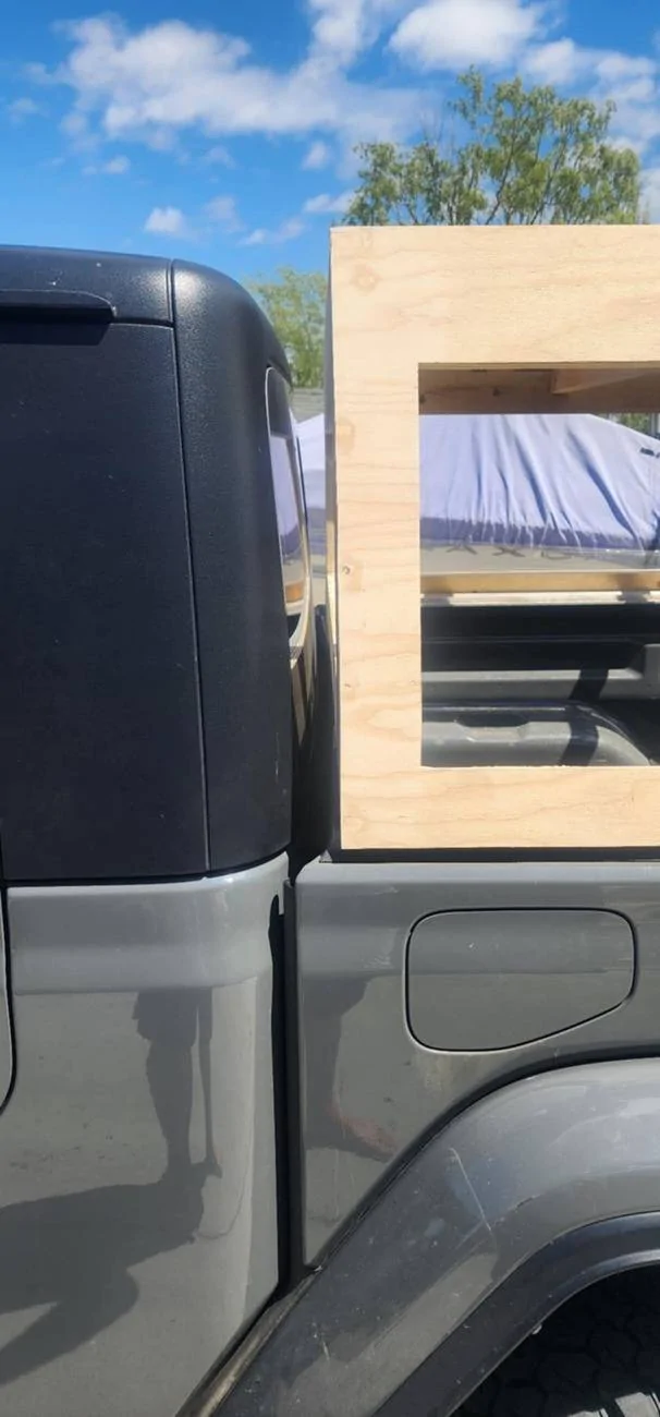

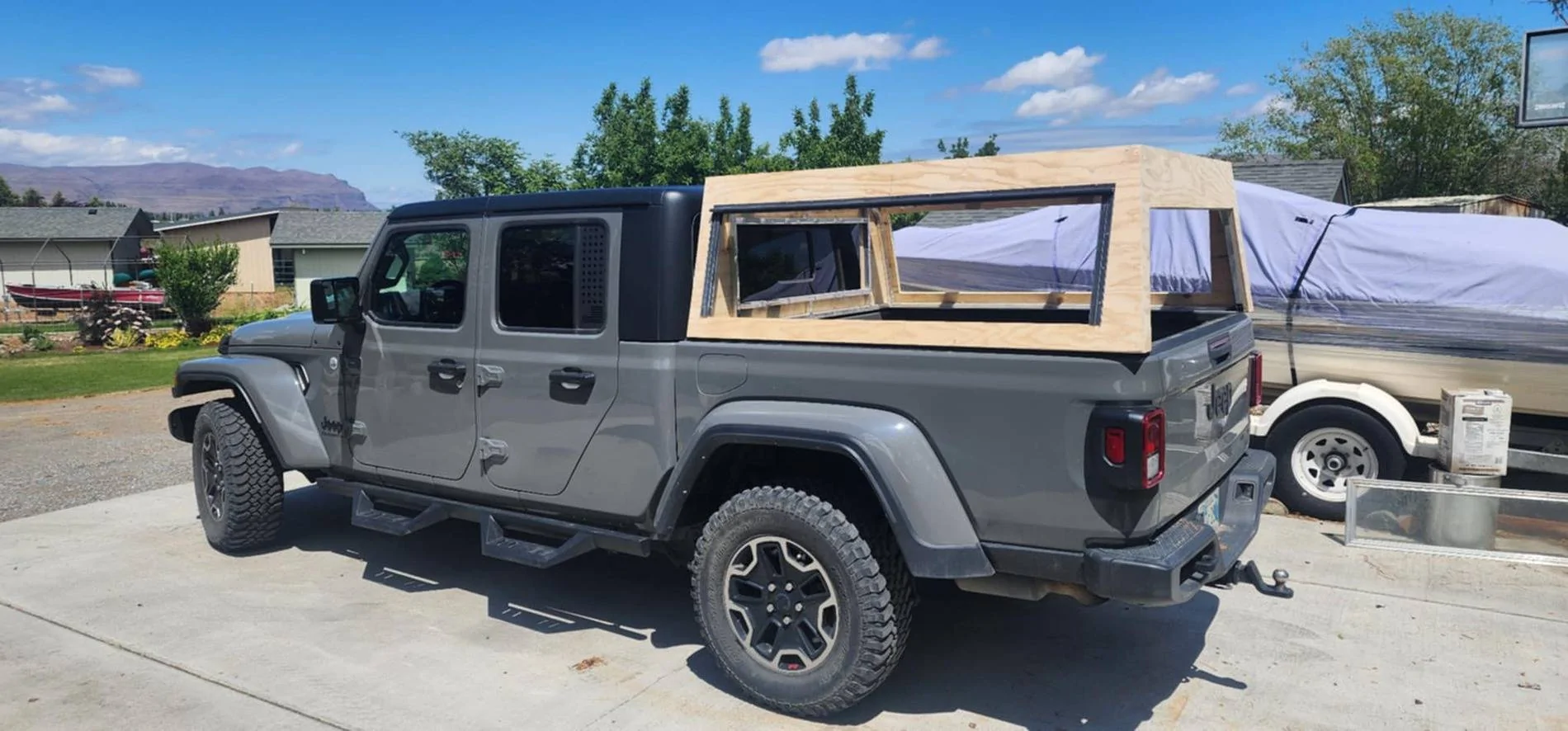

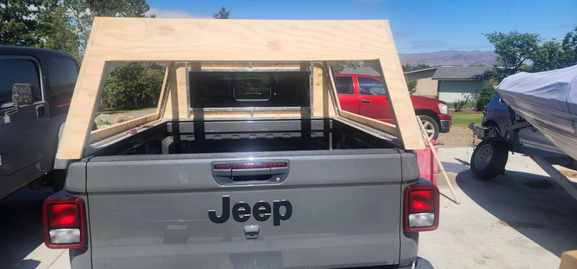

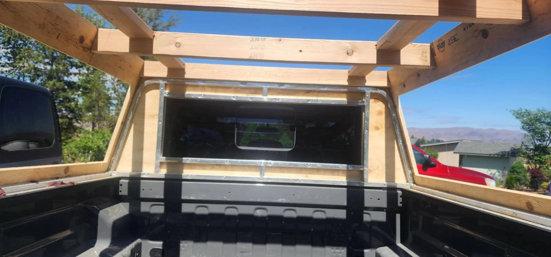

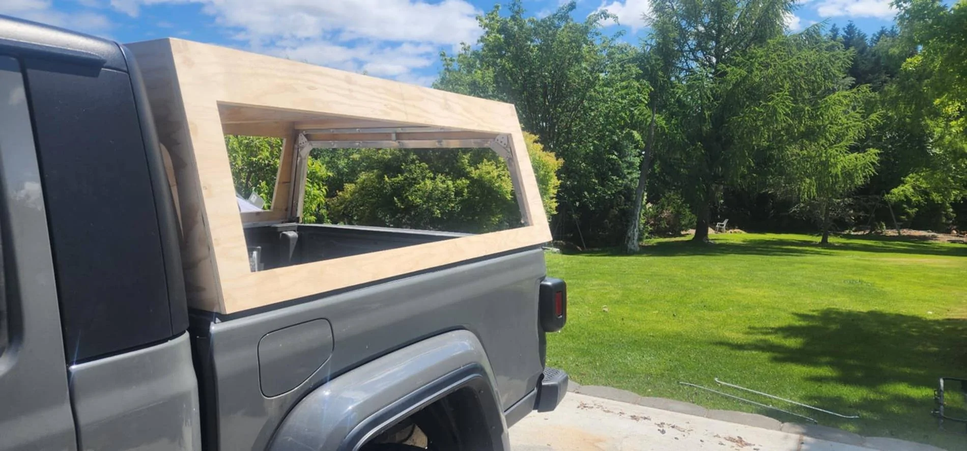

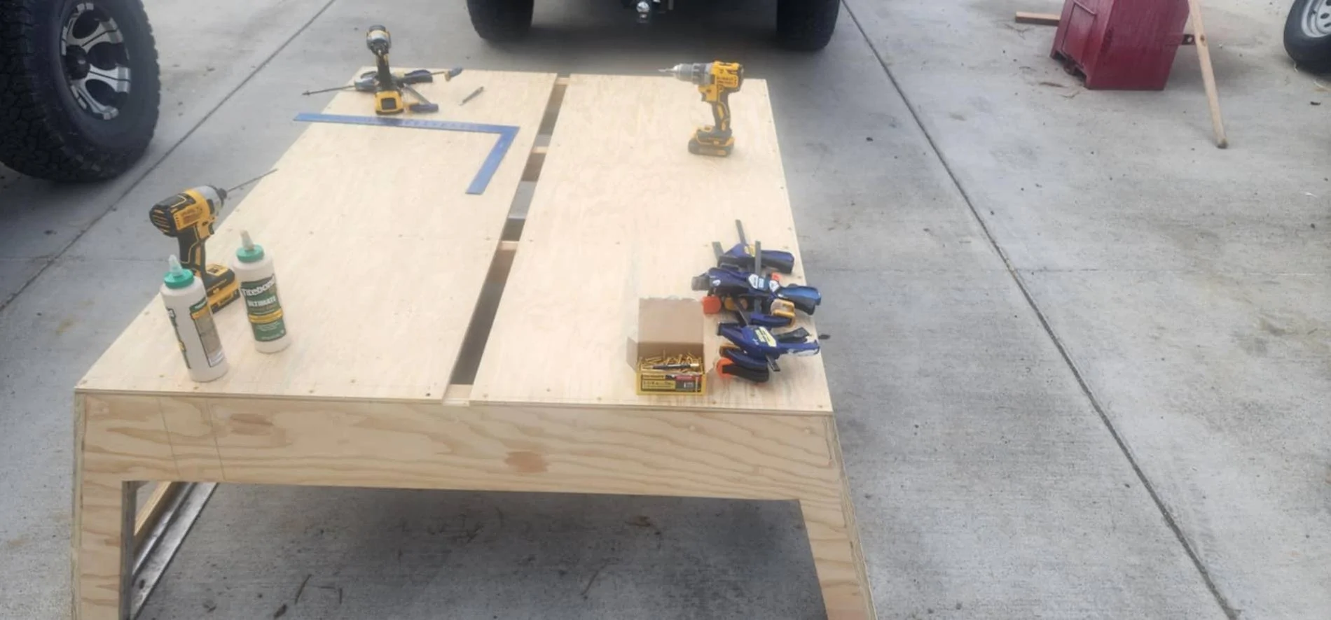

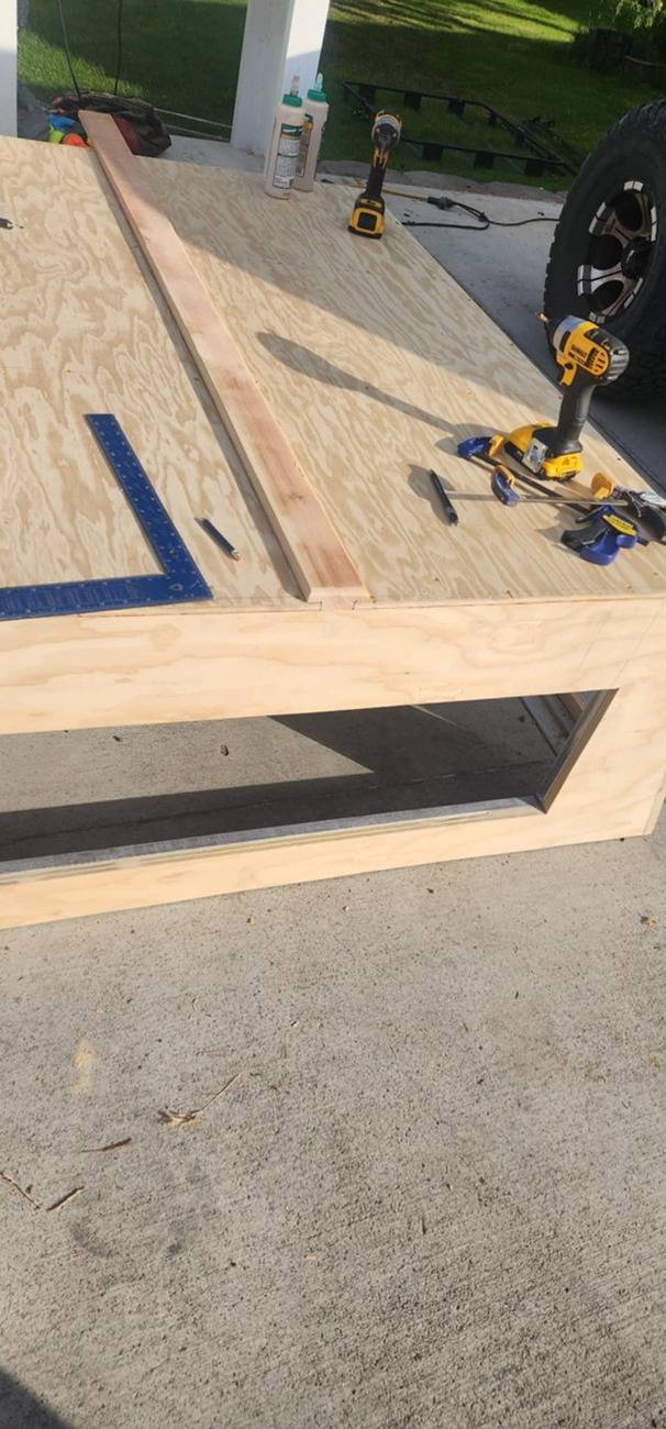

Roof was just a bit too wide for a full sheet of plywood, so I had to make a little T joint out of a 2x4. Coming together pretty well. I can easily put it on the jeep myself for now. Bed liner will add a bit more weight. Luckily the doors can easily slide off their frames so I can remove them while I install.
