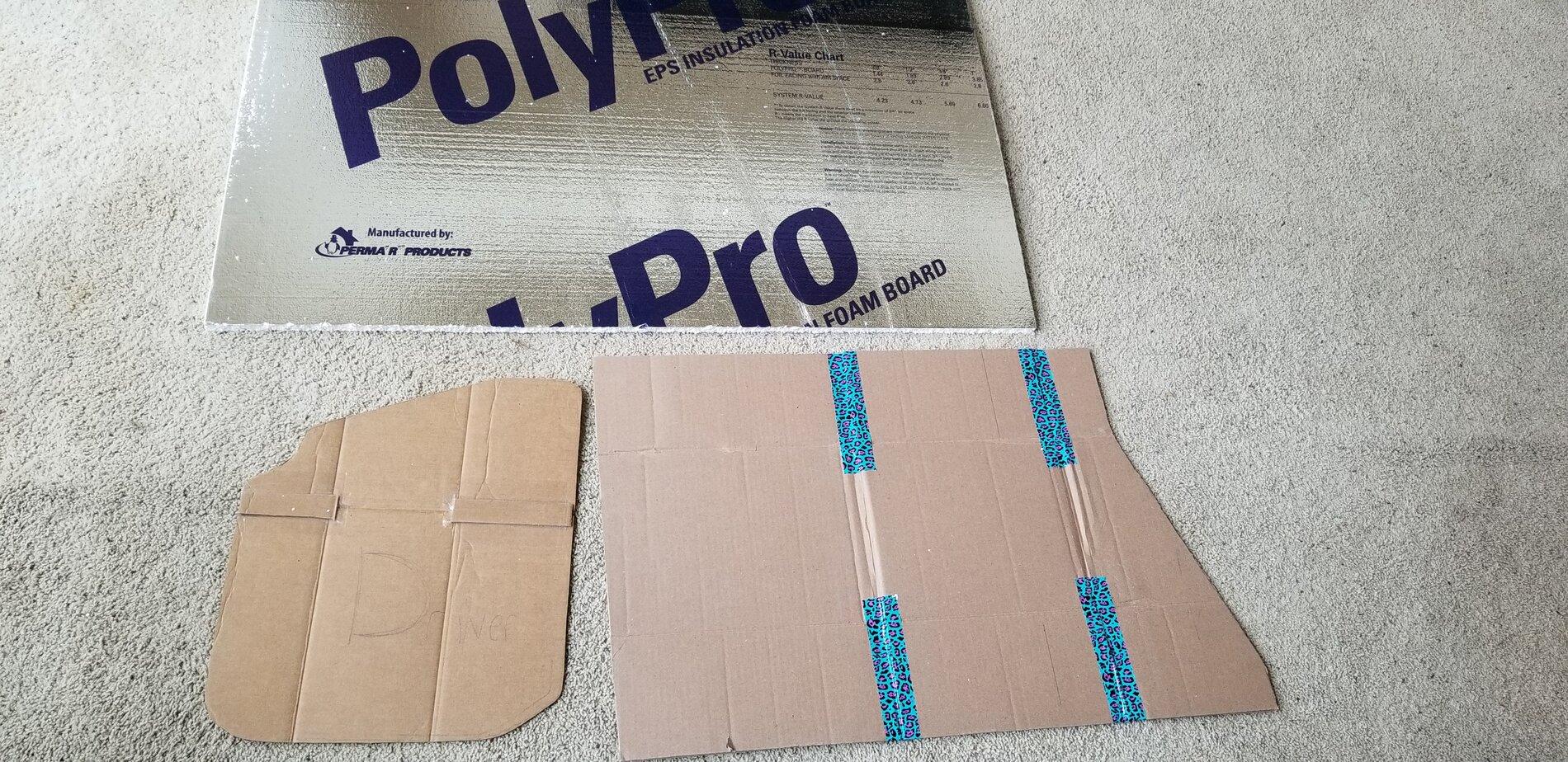

Started by creating some templates out of cardboard. Only needed to do 1 side and you can flip them over for the other - no difference from side to side:

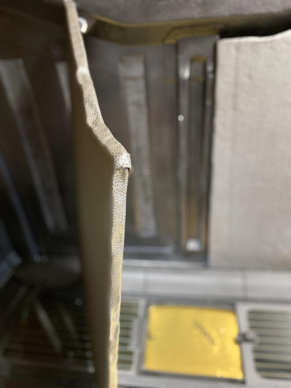

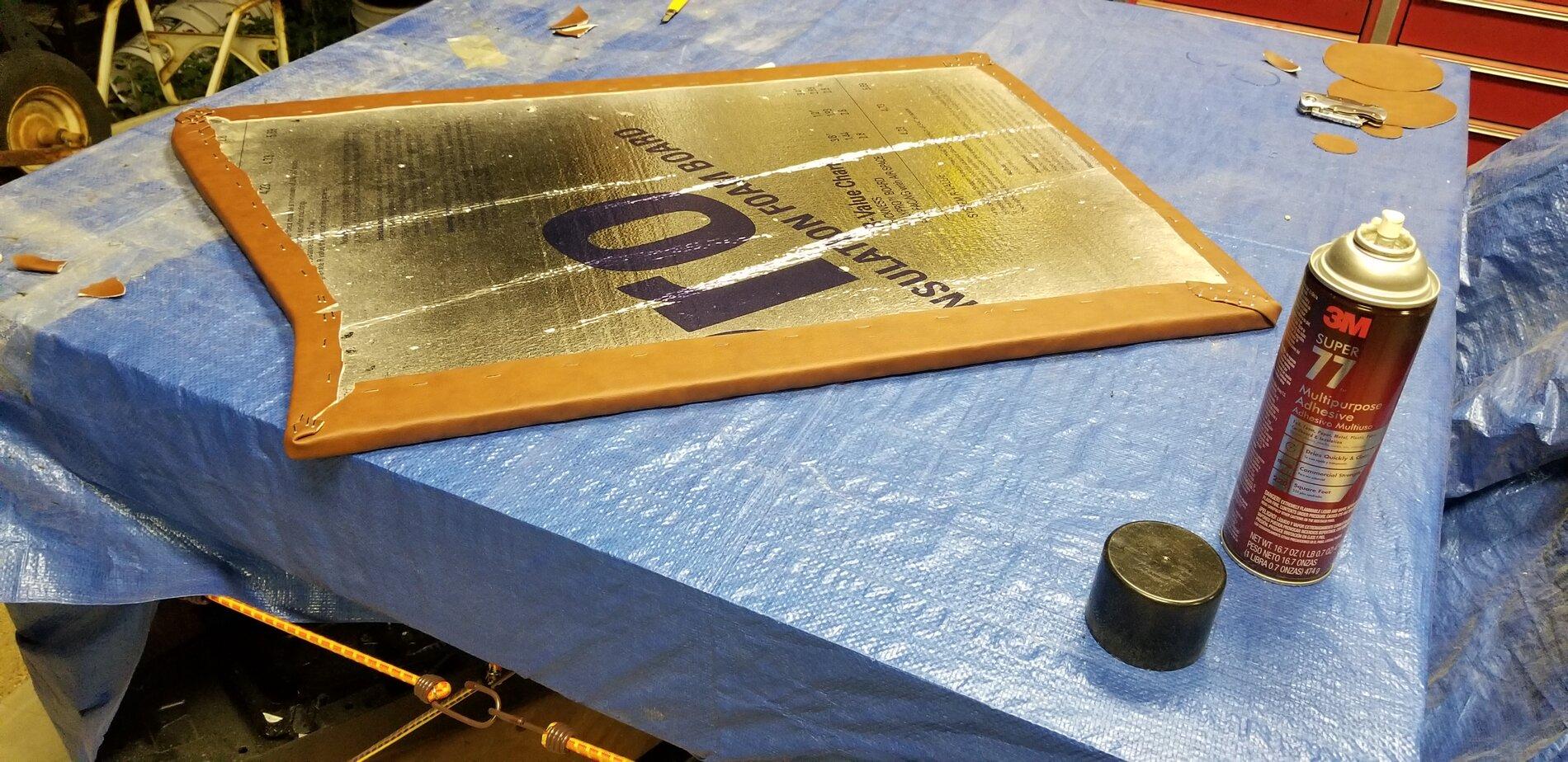

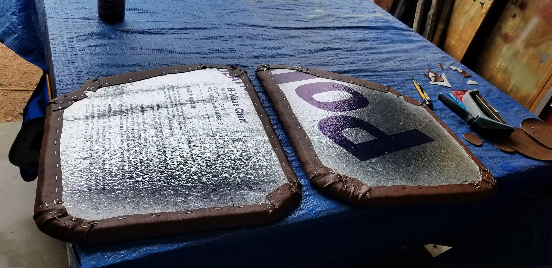

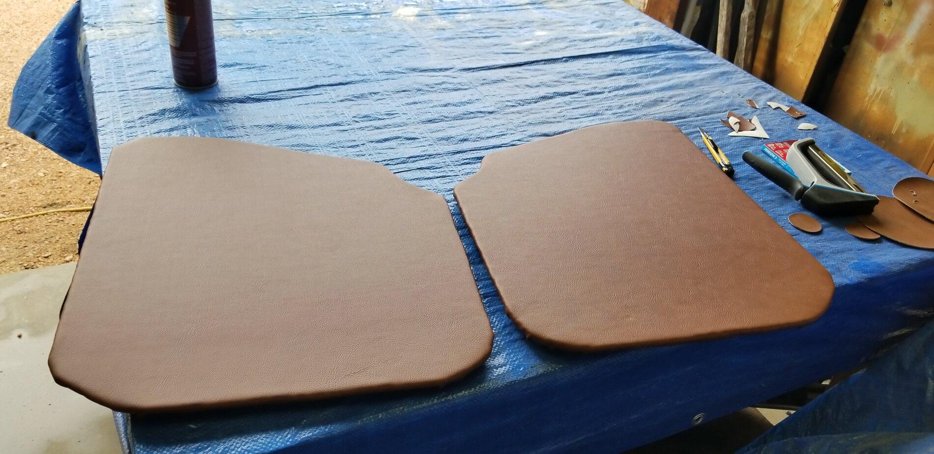

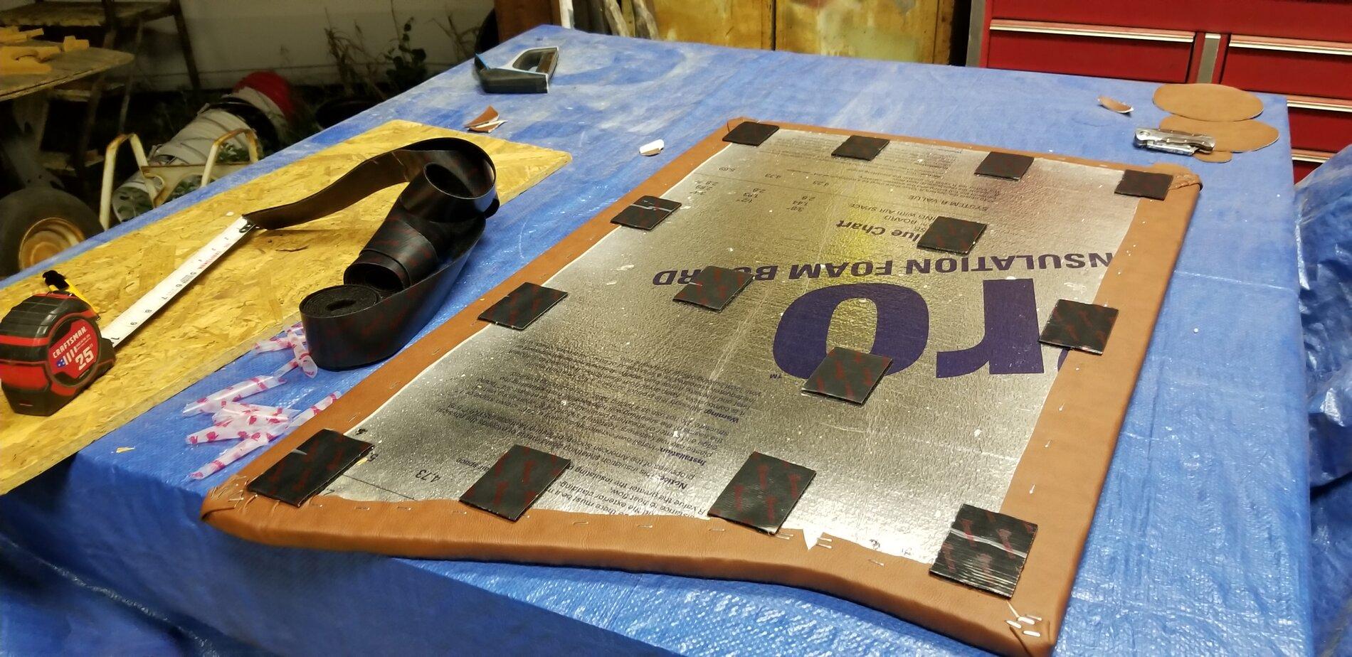

Transfer that to your foam board and cut your panels. I beveled the edges of my front panels so they would fit snug all the way around. Reminder to keep up with which side faces what direction since you are cutting some things from the back side at times. Keep the foil side up on the panels (back side) and vinyl wrap the non-foiled side. Straight cuts on the rear panels worked fine. Space them out on your vinyl and cut allowing approximately 2" extra around the perimeters to roll over the sides and staple on the back. Spray adhesive the vinyl and foam board (white side), give it a few minutes to tack up, and center up the foam panel on the vinyl and stick it down. Flip it over and smooth it all out so you don't have any wrinkles, shoot another pass of spray adhesive along the edges, allow to tack, and start folding the vinyl up and over. I wasn't overly concerned with how pretty it looked since it wont be seen once installed. Even the corners don't have to be perfect since the panels are fitted to the roof. Based on my experience with this cheap spray adhesive, I didn't want to stretch the vinyl very much and I went overkill and stapled the crap out of it along the edges in hopes that it doesn't come apart over time:
Jeep Gladiator DIY Headliner for Dummies 20210412_214306
Jeep Gladiator DIY Headliner for Dummies 20210415_163216
Jeep Gladiator DIY Headliner for Dummies 20210415_163232

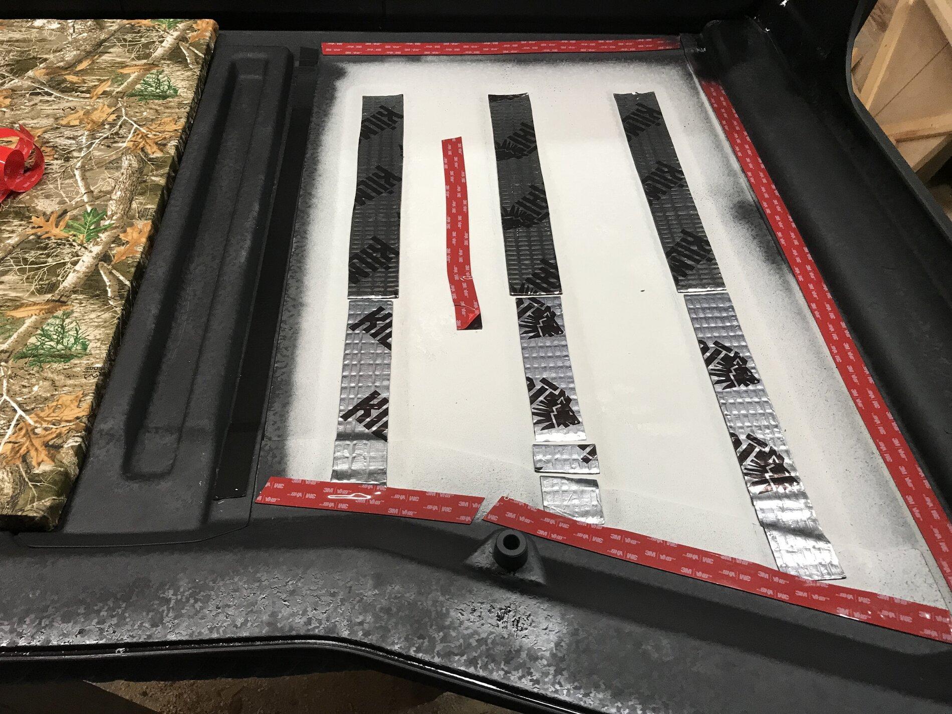

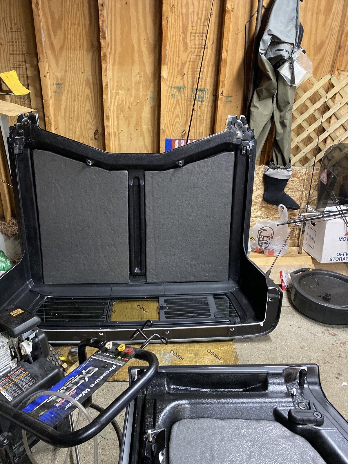

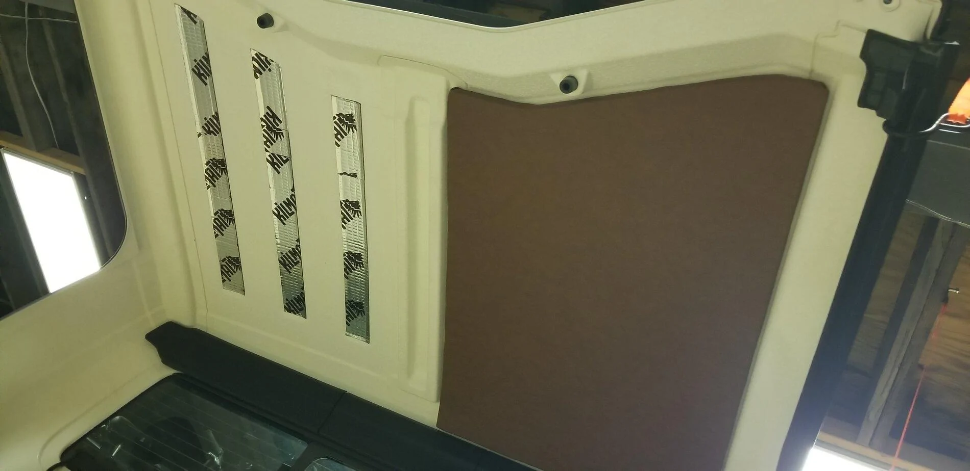

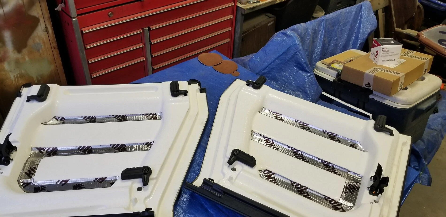

Cut 2-1/2" wide strips of the Kilmat and fill in the recessed areas of the rear roof and use 2" wide strips in the front panels. Much easier to do with the roof removed (mine was hanging in the garage):
Jeep Gladiator DIY Headliner for Dummies 20210412_212351
Jeep Gladiator DIY Headliner for Dummies 20210415_183547

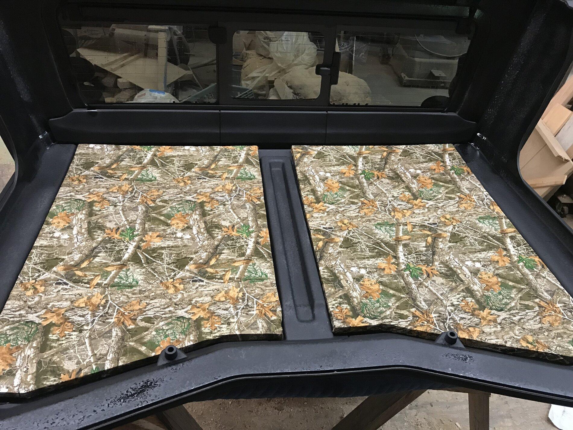

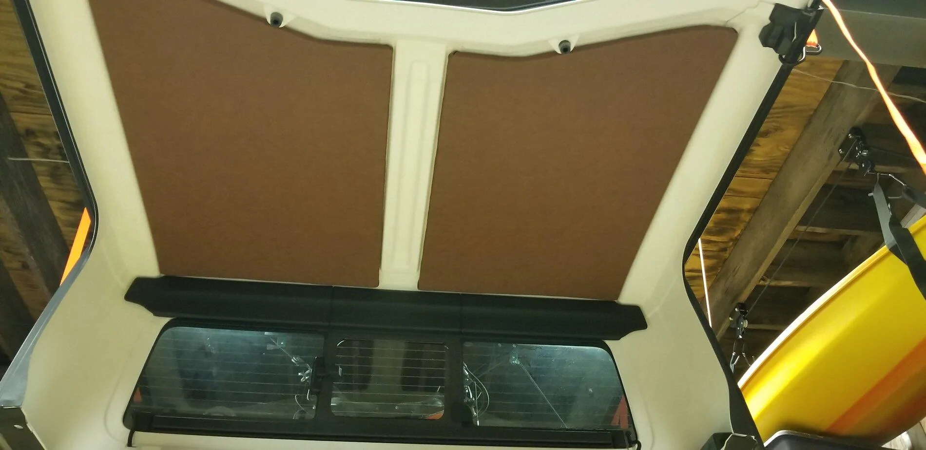

Cut your velcro or 'hook and loop' into short strips and align on the raised areas of the roof. I applied these to the rear panels first and then pressed the panels into place in the roof. Did the opposite on the fronts since they are smaller and easier to eyeball and align the panels. This velcro seems very strong, so if you think you might want to remove the panels at a later time, be conservative on how long and how many strips you use:
Jeep Gladiator DIY Headliner for Dummies 20210412_215211

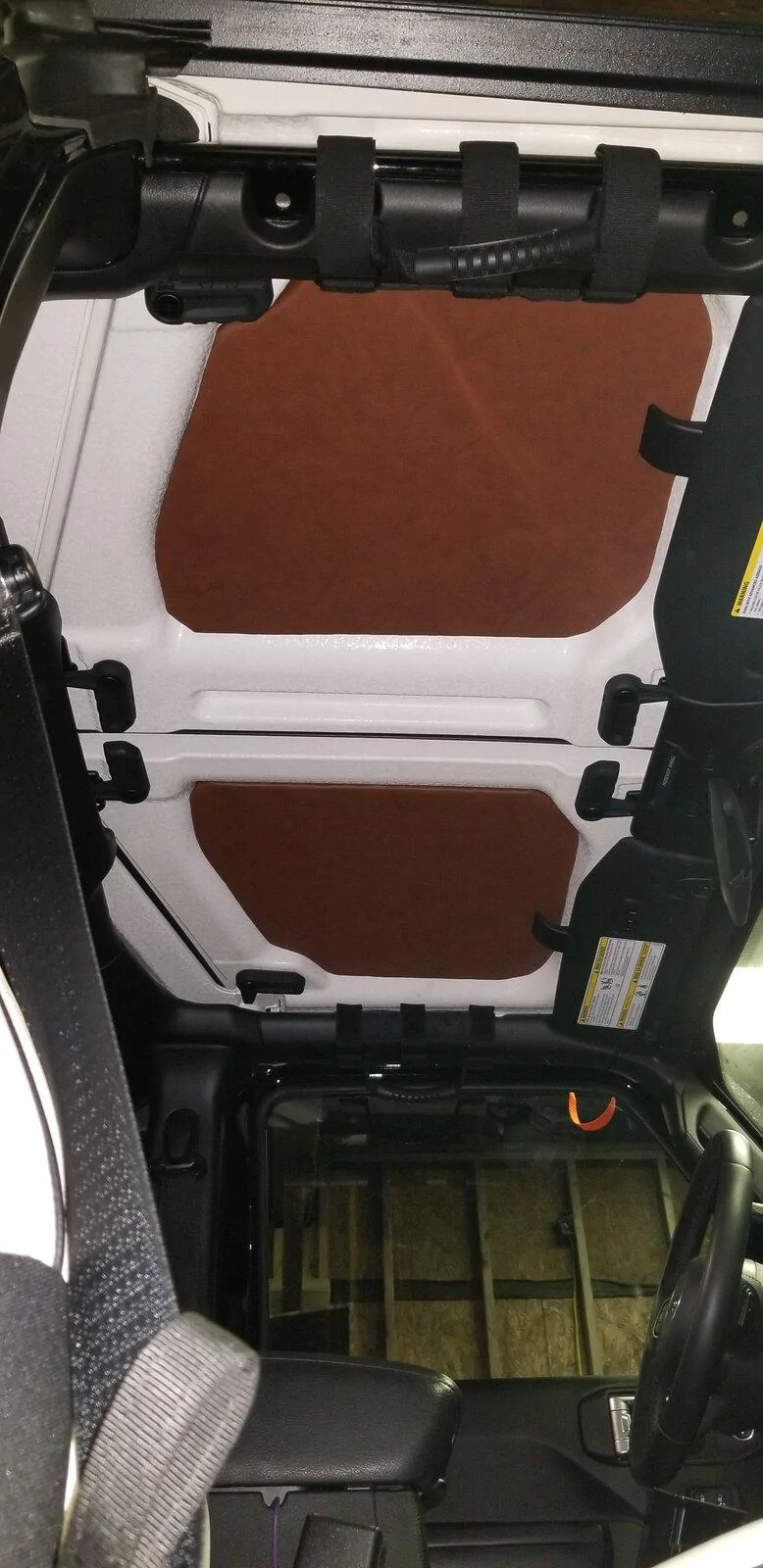

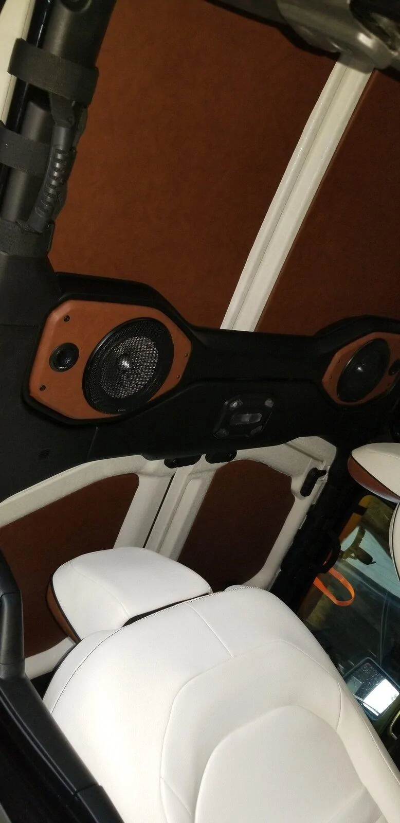

Align your panels, press into place with the palms of your hands (not knuckles or you will leave indentations on your foam board - ask me how I know), and that's all there is to it! So easy I plan to do the sides of the top behind the rear doors as well when I can get to it:
Jeep Gladiator DIY Headliner for Dummies 20210416_112711
Jeep Gladiator DIY Headliner for Dummies 20210415_222722
Jeep Gladiator DIY Headliner for Dummies 20210412_215735

I did the same install last week, however I also added egg crate foam on the non-reflective side. I have nothing to compare it to obviously, but the interior noise is dramatically better. The only area where the extra width causes issue is with the front clamp on the rooftop panel, but since it is foam, the foam just gives in. Very happy with the outcome, especially coming in under $70 for front and rear.
I went with the 3/4" foam board to clear that clamp and the fit is just right. No sun out here today to test the heat protection, but it has definitely quieted the cab noise and changed the sound of my Focal system for the better by dampening the harsher sounds that I was having to tune down previously.

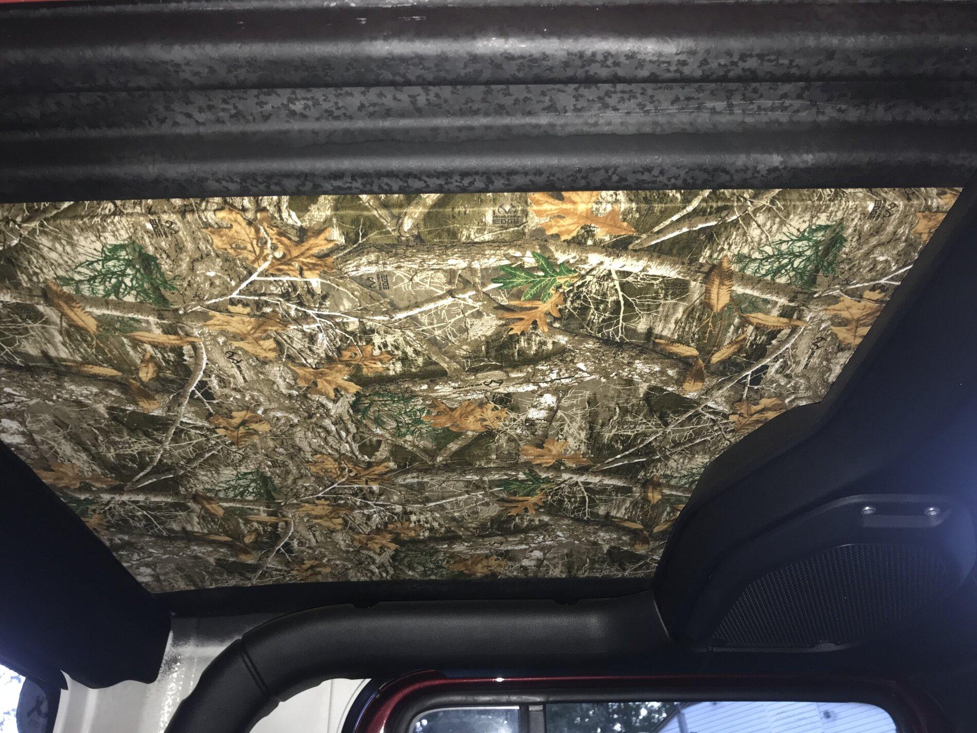

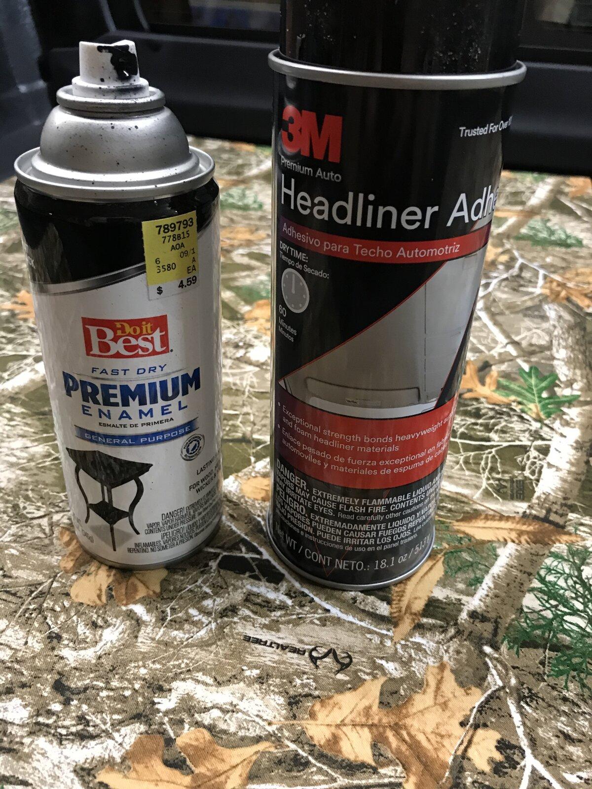

Thanks for the write up
Jeep Gladiator DIY Headliner for Dummies 7CB70CC3-A238-4D78-9311-DBCF2EE5A8B3
Jeep Gladiator DIY Headliner for Dummies 96F7801C-4278-4916-995D-35F647BC214F
Jeep Gladiator DIY Headliner for Dummies 3B074C30-4B25-4B58-8AE3-781058D8895A

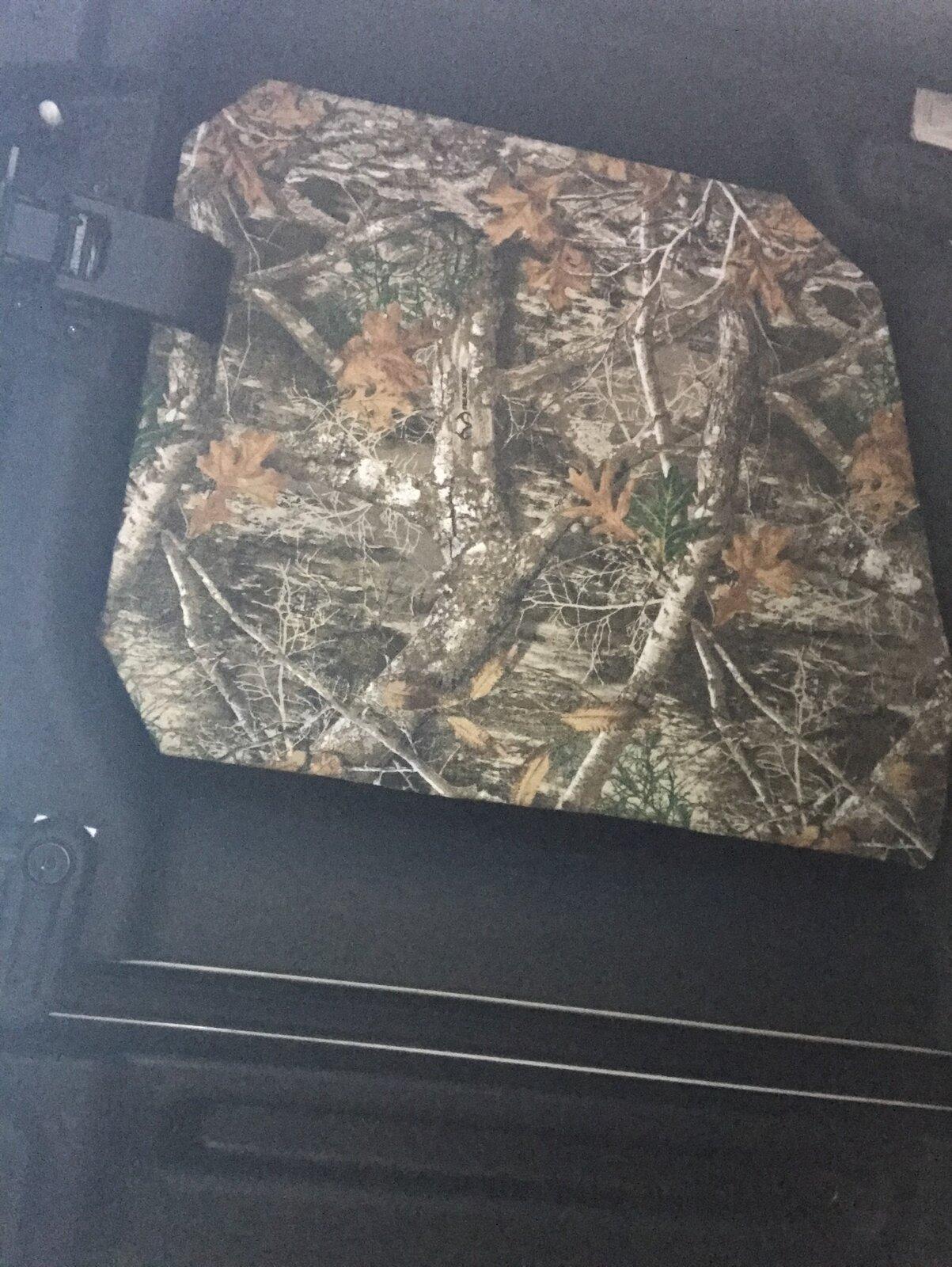

Just did mine using McMaster-Carr "loop" velcro sheets so I can put all my patches on it.. Bonus, the McMaster loop is unlike any I've ever seen before, very soft and close to what normal fabric would look like, so it just looks like normal headliner. It's not stiff, coarse and plasticky like you might imagine normal velcro loop to be. Also pretty pliable and easy to work with. Grippy enough I'll bet it could even hold a small flashlight or first aid kit, so a cheaper alternative to those Molle headliner panels.
I am interested in doing this. I was thinking about using felt, as I thought maybe some patches would hold well enough on it. I am unfamiliar with McMaster-Carr "loop" velcro sheets, what is it? Where can I find it? Do you mind sharing a photo or two? How has it held up for you over the last few months?

I used 2 sheets of this stuff from McMaster, 55"w x 3' l:
https://www.mcmaster.com/catalog/94975K82
Held up great over the winter. No issues whatsoever.
Took the hardtop off early March, so it's still hanging in my garage.
Sorry, no pics, and I can't really get any as I'm away with the reserves until probably mid-July. But, it looks like a black cloth headliner covered in military patches. I used self-adhesive 1" velcro strips to attach it to my top (painted the inside of the top black) and while I haven't tried pulling panels down again once they've been on, they hold up pulling patches off and stuff.
