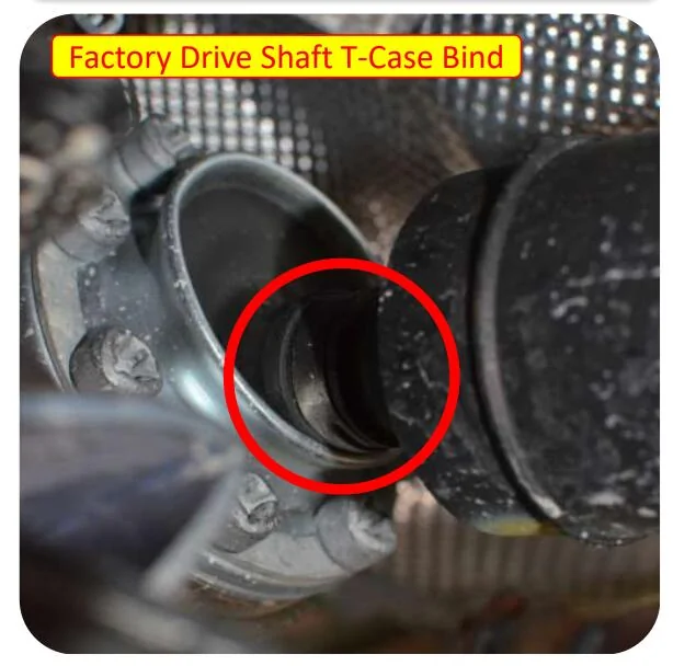

So, the need for a different front DS relates to the droop capability of the lift. For example, Metal Cloak is known for lots of downward flex (downward dog for you yoga folk). So, some lift companies will recommend replacing the front DS because the stock unit will contact part of the transfer case during max droop. This pic shows what I'm talking about...
Jeep Gladiator Do I need a different front drive shaft when I lift 2.5" 1739927680077-1s
Unsure if a particular 2.5" lift you're considering will result in this. However, if it does, you'll potentially chew through that rubber boot in no time during max flex. That being said, Teraflex offers a replacement front Rezeppa joint which is significantly cheaper than a new driveshaft.
