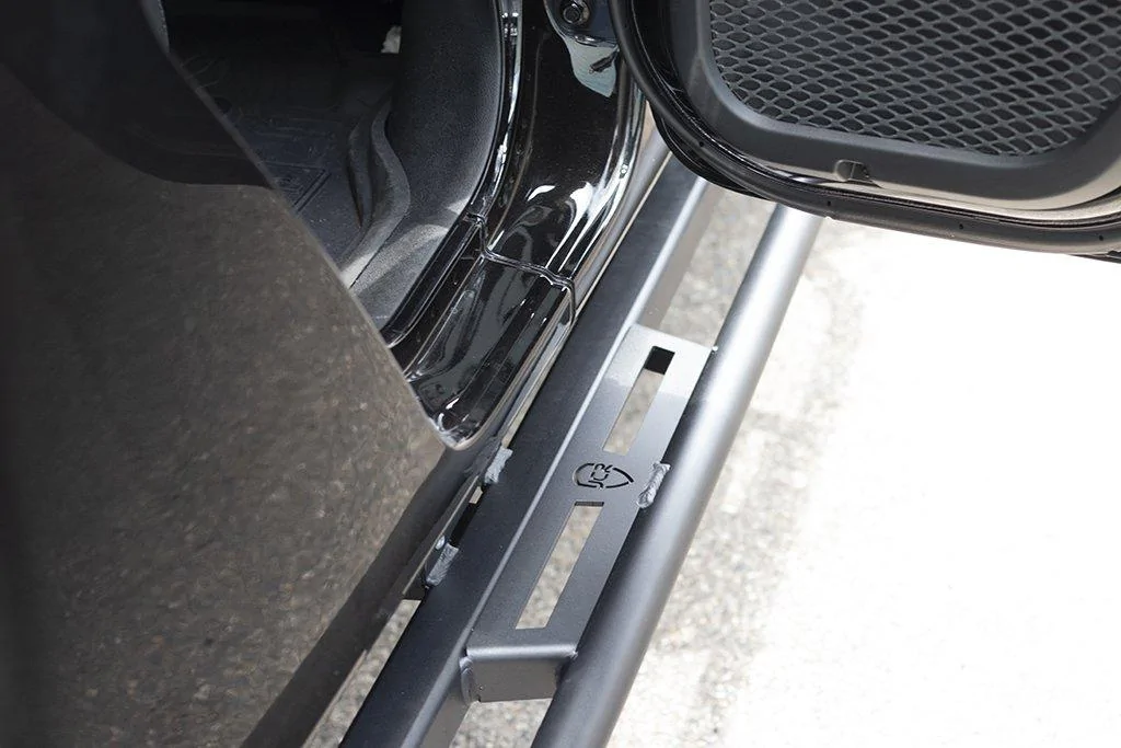

https://aceengineeringandfab.com/collections/gladiator/products/ace-jt-gladiator-rock-sliders
I’ve had Ace sliders on my JK for 4 years. Checked around for the Gladiator to see if anything new looked better. It didn’t. 20% off this week so I ordered, even though my Gladiator build is still just in queue.
Be very CAREFUL with the bolt removals! The rear bolts are a fricking NIGHTMARE. Go ahead and ask me how I know LOL One side I was able to complete, I snapped off the other side rear bolt and is at the dealership now. The rear attaching bolt is at least 12" inches long. Word of advice, let the dealership install then for you.

Wow, that is a bummer! What kind of tool were you using, impact wrench or breaker bar? I've got to think that's some kind of fluke but really unfortunate. Was it just raw torque, did the head come off or bolt break part way up the shaft?
Any slider that needs to really take the full weight of the Jeep and not bear it on sheet metal of the body will need to mount to the frame, using the body bolts unless it is welded on. JCR, Rockhard4x4, I'm sure there are others... So removing frame bolts is not unique to ACE. On my JK you had to apply downward pressure on the washer to get the threaded portion up in the body to bite so its a little tricky. I'll definitely use some care, and will be interested to know how your dealer sorts your situation out.
