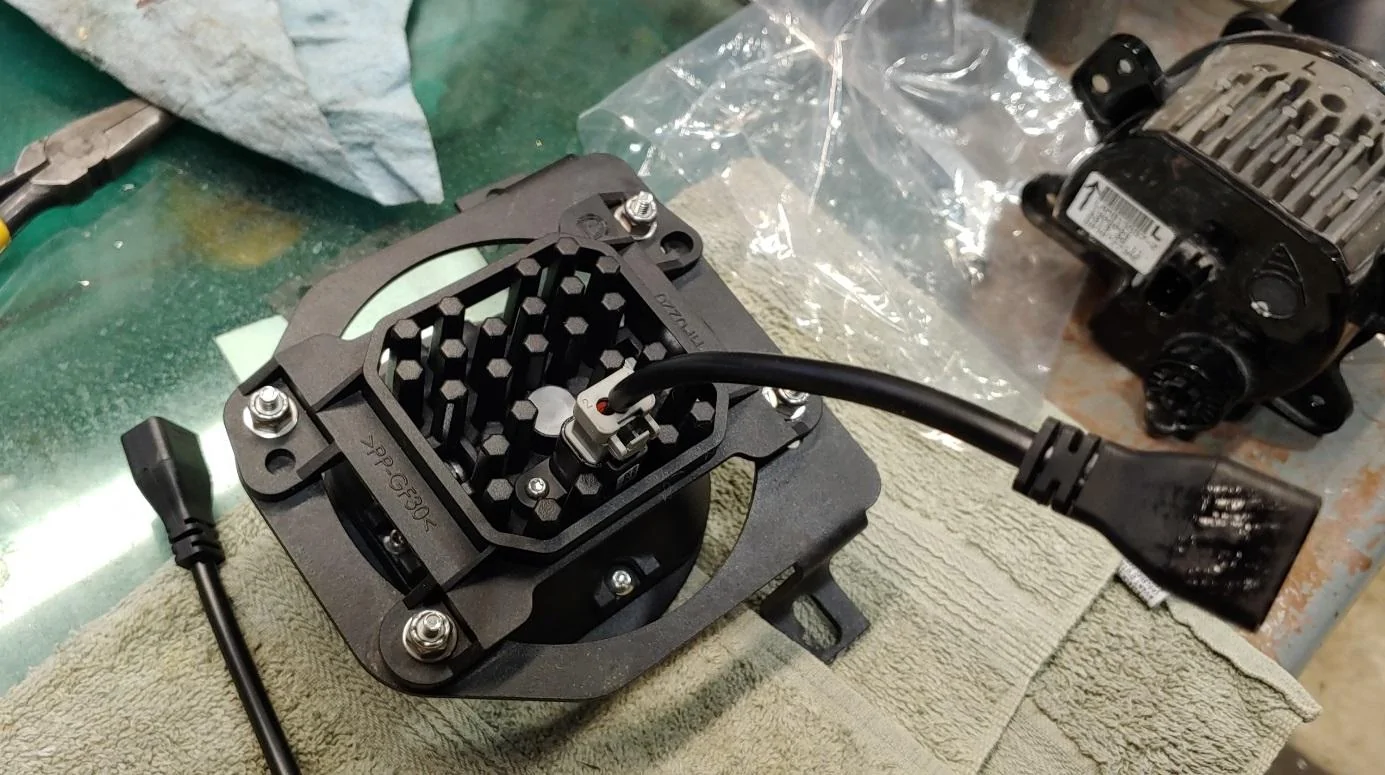

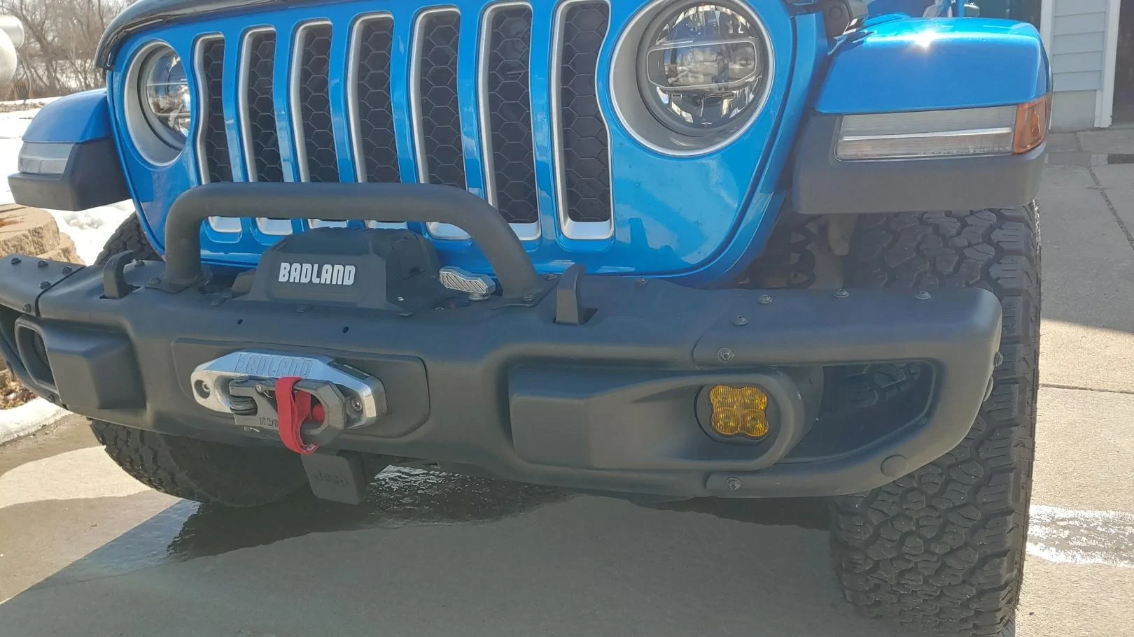

I put DiodeDynamics selective yellow LED fogs in the steel Rubicon-style bumper on my Overland.
Jeep Gladiator Do the halogen fog lights fit the steel Mopar bumper? LED upgrade recommendations? 20220208_122406_HDR

The copy-cat bumper I bought had brackets to use my Overland plastic bumper fog lights with the bumper (although it came with decent LED lights as well)
The Overland style fog light attaches to the bumper bracket using 4 screws, then 2 screws secure the bracket to the steel bumper like Rubicon steel bumper fog lights would attach.

Mine were LED.
I bought the eBay Rubicon steel bumper copy and put it on my Overland. The bumper had brackets that allowed me to use my LED fog lights in the bumper. Likely because the bumper is aimed at Rubicon and Overland people and they'd have the fog lights for the "plastic" bumper.
The brackets aren't anything to brag about, but they work fine.
I then bought DiodeDynamics SS3 Sport selective yellow fog lights for the Overland/Rubicon plastic bumper. You can buy those with the adapter brackets to allow them to go into the steel bumper but I didn't need the brackets since this bumper came with them.

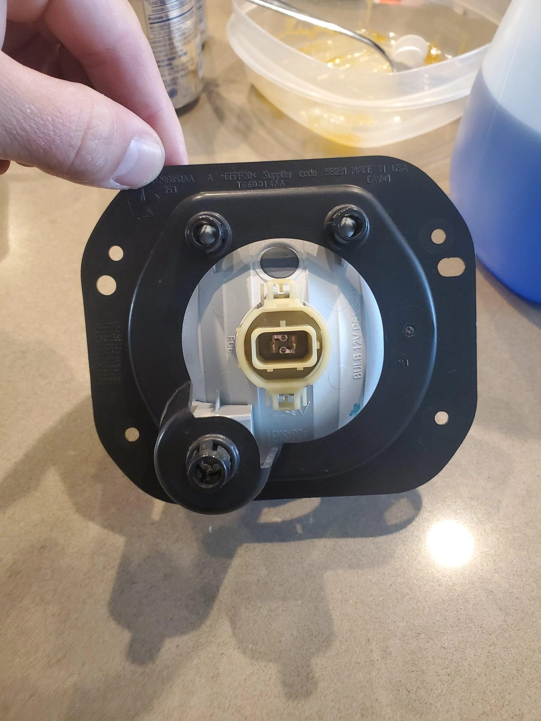

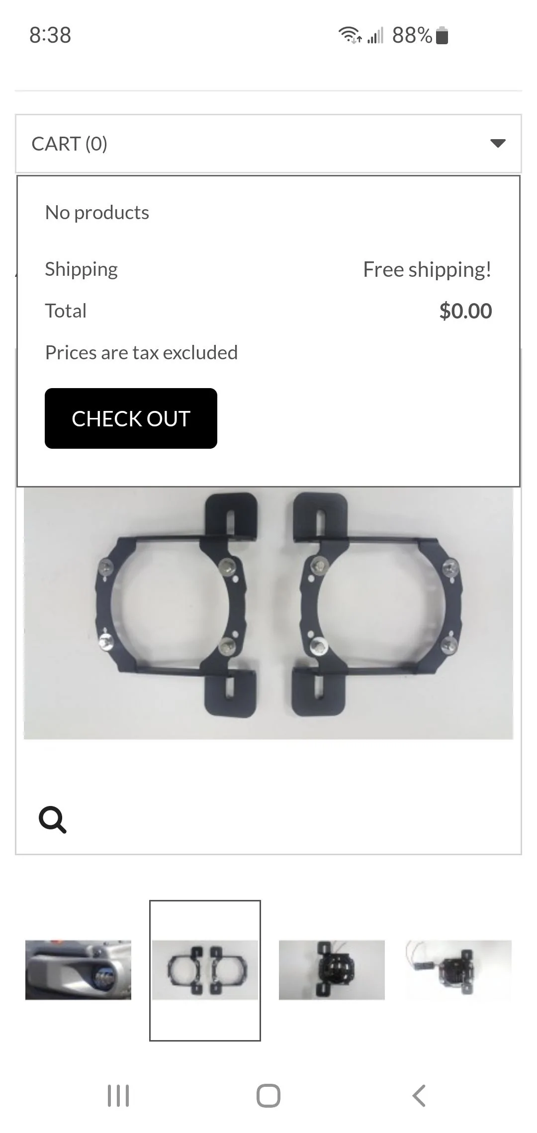

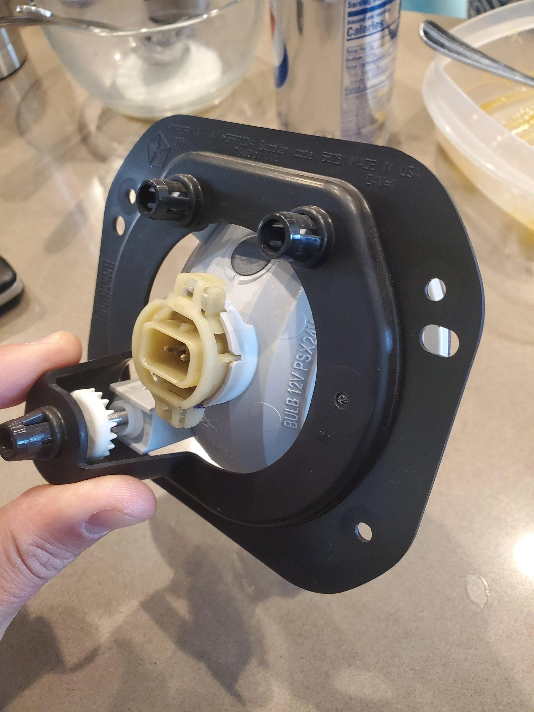

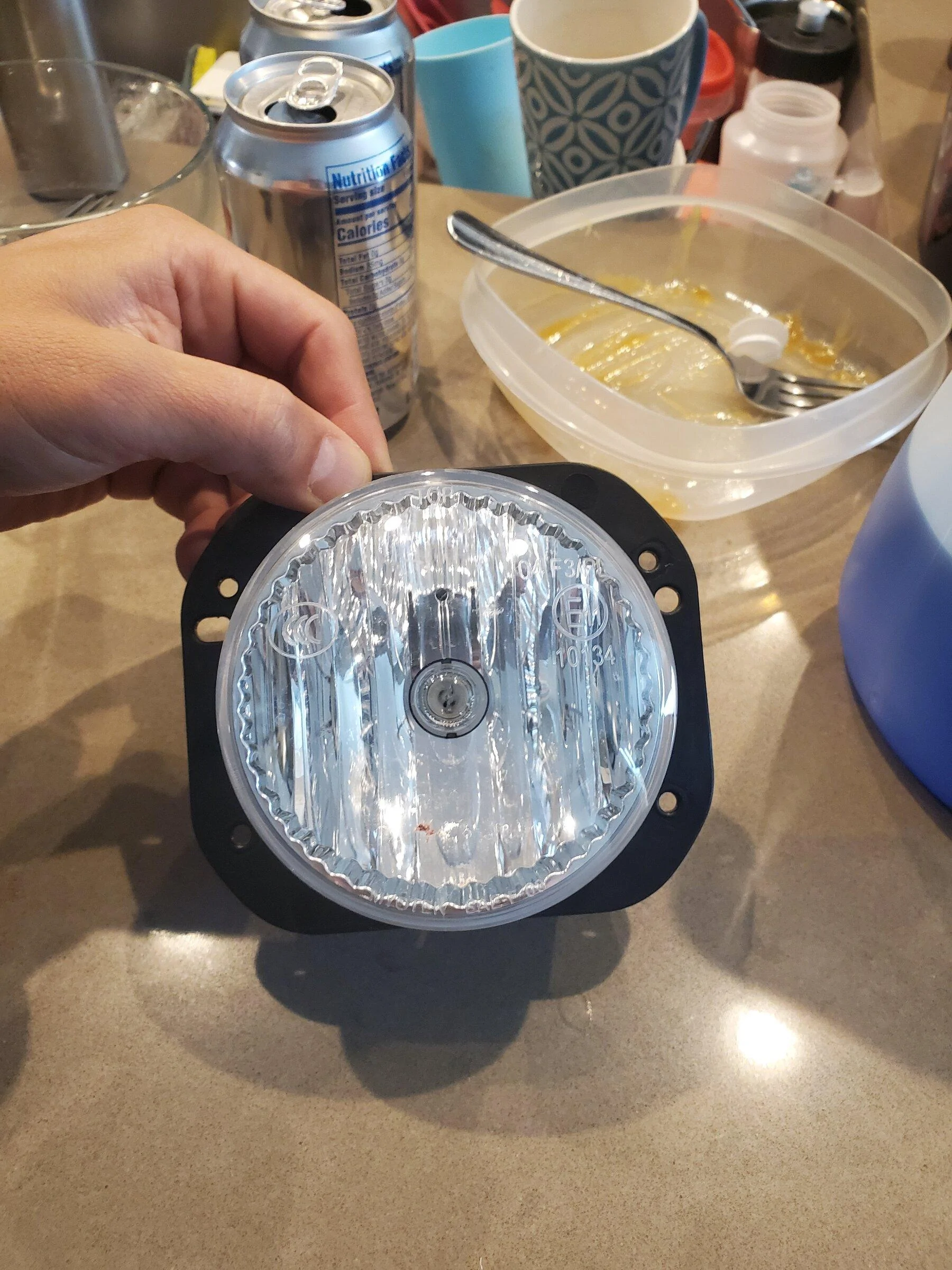

So i own a rubicon gladiator with halogen fogs and plastic bumper. Here are my fogs i just pulled out. If i want to fit my OEM halogen fogs to either the knock off 3 piece steel bumper or OEM mopar steel bumper these maximus brackets should work?
180
29,526
35,128
Yeah. Your halogens are simply in adapters that make them fit like my 4 screw LED lights.
