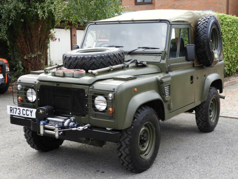

I am looking at something larger than this Wolf Defender pic I attached, but with a similar ratio. I have seen some 35x10.5 17 tires out there but once you get larger its seems impossible. Could there just be a limitation in tire construction like that, or just a too small market?
