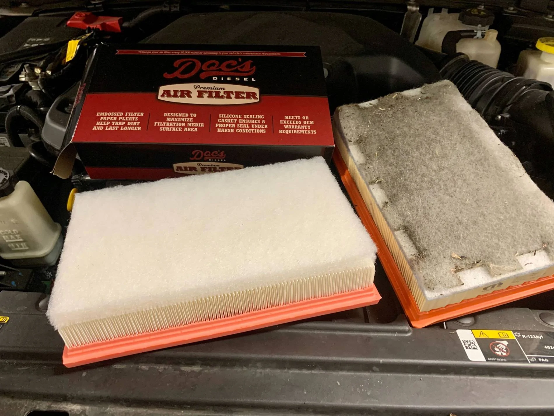

I've been running Doc's oil & fuel filters steadily for roughly 35k of the 45k miles on the truck. Their air filters have been hard to come by though so my last was a OEM back-up I had purchased when I bought the truck. I just swapped out that OEM for another DD (back in stock as of a few weeks ago) and figured I'd post a side-by-side comparison shot.
Doc's on the left, OEM on the right. Price on these are $27.
Jeep Gladiator Doc's Diesel Air Filter Docs_Diesel_OEM_Filters
OEM filter behind pre-filter fabric at 20k miles:
Jeep Gladiator Doc's Diesel Air Filter OEM_Filter_Dirt

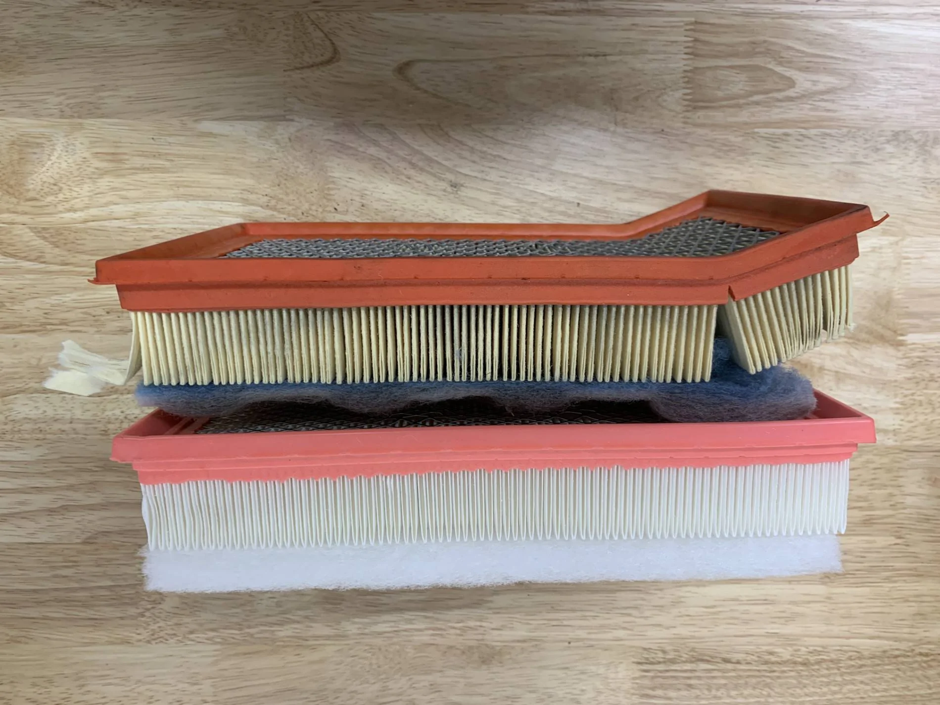

To Mike - have you compared "surface area" - ie number of pleats, depth of pleats, etc.?
I don't have a diesel, but am always curious about such things.

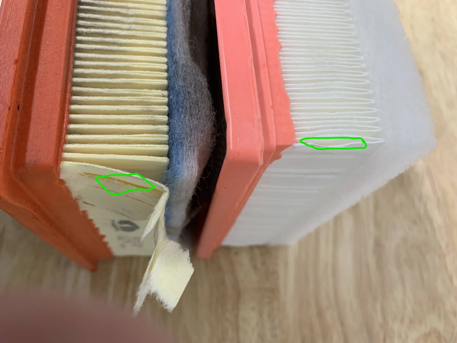

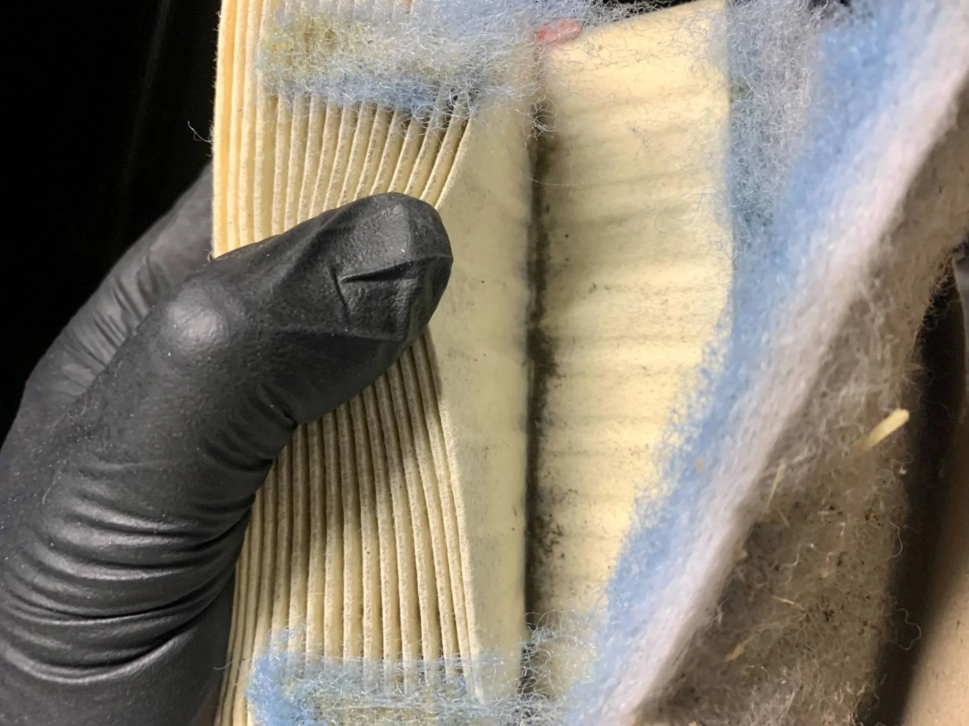

I didn't even think to count but I had to know after you mentioned it hah. I pulled another Doc's out of the box to better compare. Turns out the pleat count is exactly the same. Pleat depth is the same but more of the pleat is exposed on the DD because the Mopar's foam surround is taller on the inset. The pleat material feels the same. The metal mesh on top of the DD is a finer grate than the mopar but the Mopar's mesh is more stout.
Something I learned though while counting is they seal up the pleat ends, both Mopar and Docs. Mopar uses a yellow type of glue while the DD is clear. Its hard to tell on the DD, I didn't want to destroy the pleat to expose the glue but I drew circles around them. I never knew pleat ends where sealed like this. I wonder if its to make assembly easier when curing in the foam surround or if its to force all air through the pre-filter. Any idea @ShadowsPapa?
