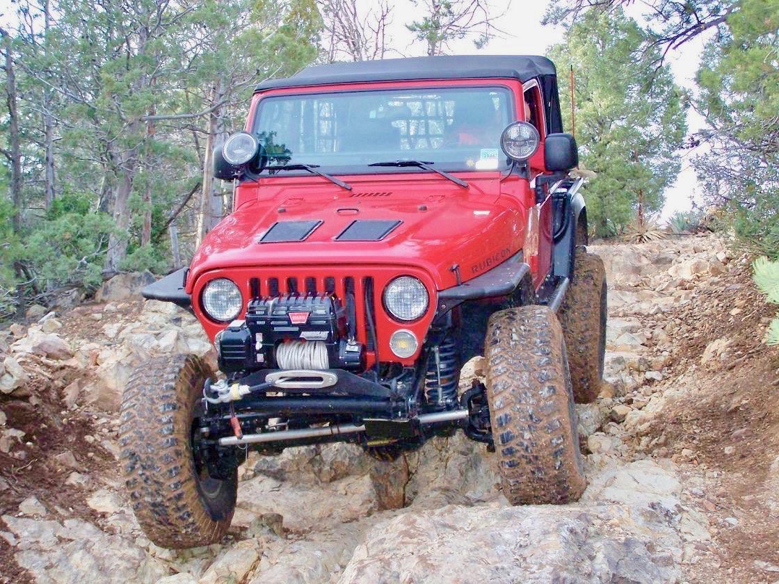

I read on another forum that if you lift your JL you should get wheels that will give you a wider stance due to the raised center of gravity.
Any truth to this?
YES!!!
Here is it by the numbers: Every 1 inch you go up, you have to go out on each side 1 1/2 inches. to equalize the CoG.
That said I do NOT recommend doing an offset wheel. You can gain additional width with wider tires. Offset affect the bearing life on your axle bearings.
You can also go with wider axles if you get that deep into offroading.
When I ordered my axles I extended them IIRC I did full 60 in axles, I did that to keep the load off of the axle bearings to prevent premature failure. The tires on there are Gy MTR's, I went to BFG KM2's which I got better performance out of them over the MTR's. I think the sidewalls were more flexible than the MTRs and I ran them at around 5 lbs.
The over all result was that I could lean my rig over at 55 degrees, you are not going to do that in stock form with big lift. FYI there is no need for any lift to go higher than 3 in IMO.

It's the old thigh bone is connected to the hip bone etc etc. I pushed out my tires about 2 1/2 in per side and never had issues with anything on the trail so narrow I could not get thru.
When used to lead runs in Moab I often ended up with a passenger due to their breakage (usually less than a 100 yds beyond the trailhead). A lot of stuff in Moab is extreme off camber, I almost always lost my passenger, they found another ride because I could lean my Jeep over so far.

But your vehicle was also much shorter than the JT, right? so manuvering around obstacles might not have been an issue, where now with a JT it might be with same width, because of extra length....
anyways, I know the JT isn't meant to be a dedicated crawler, if somebody is into that they should get a JL.
Good food for thought though Cowboy. I'm waiting to see how some of these LEs with 35" and aftermarket wheels look. Then I can compare number of inches the tires stick out.
I want optimum width on a 2" lift, but no more, as I don't like the "my tires stick out completely past my fenders" look.
You are correct length of vehicle plays a big park when you are playing in the rocks. Even little short Tj's could struggle, so what did I do to mitigate. I fabbed up from a piece of 4 in Sch 40 Pipe, with at 90-degree bend on each end. I ran it full length between my wheels on my TJ and I used to to make tight turns...pull hard to the left or right to hook up with the rock, turn off the rear locker or front locker and use the front or rear wheels to push or pull you around the tight corner. No damage done to piece of Sch 40 pipe!
