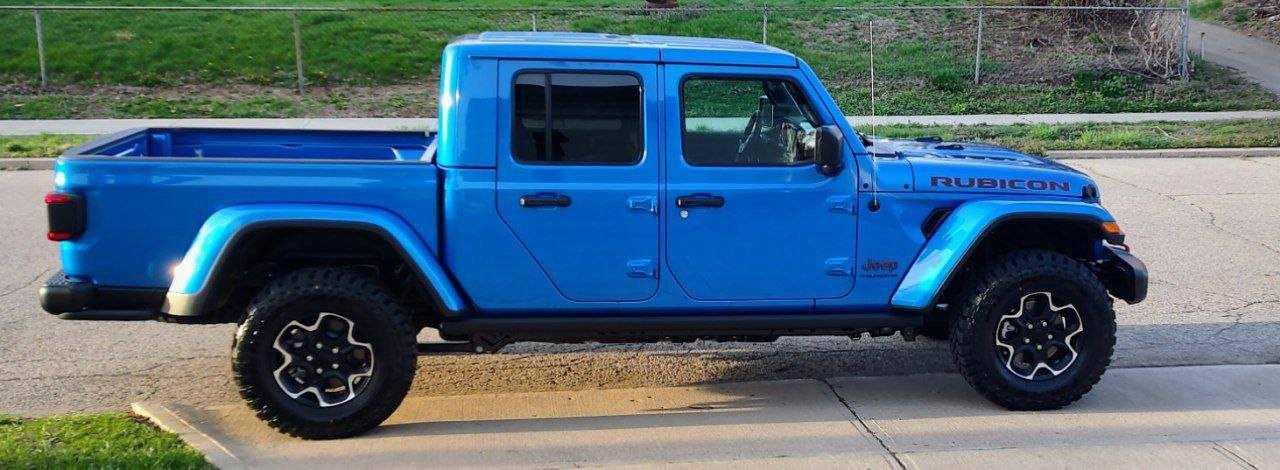

When discussing adding the 2" Mopar lift on the Jeep, everyone tells me Rubicons already come with a 2" lift. When I bought the truck, the Jeep next to it definitely had a lift and was on 35" MT's. While I would have rather had that setup, I did not want a black truck and neither did the wife.
Is the 2" Mopar lift available without Fox shocks? Because my truck does not have Fox shocks. The build sheet makes no mention of any lift or even mention springs or shocks. The only suspension parts mentioned are the electric sway bar disconnect and locking diffs. Is there a way to determine if my truck already has a lift? Or, would it have been on the build sheet for sure?
Here's a pic if this helps at all. She's riding on the optional 285/70R17 MT's roughly 33". The first pic almost looks like she's leveled by it's my driveway.

Looks like you've got more space in your wheel well than I had on mine JTR with 33s.
But at the same time, it looks like your lower control arms are pretty level For a 2 inch lift.
Edit: i read that as 'new' to you, but i remembered reading some of the new trucks don't come with the fox shocks.

I believe the Rubicon has about 1" over a Sport/Overland/etc
Your truck does not look like it has the Mopar lift

They do NOT come with a " 2" lift "
But they do sit a bit higher than others in part due to the fender flares sitting higher, etc.
If I measure the front of a Rubicon, from the ground to a certain spot on the headlights, or even the grill, a Rubicon sits about 1" higher than an Overland.
However, at least 0.2" of that is tires.
A 2" lift isn't even a factory option, so no, the factory doesn't do that, so it won't be on a build sheet. If they did offer that as an option, it would show up on the build sheet.
Factory will be stock Rubicon suspension.
The springs are a bit higher rate than something like an Overland so if you put the Rubicon springs under an Overland it may lift the Overland anywhere from 0.75" to a bit over 1" higher than factory for an Overland.
The combination of spring rate and tire size make the Rubicon sit higher than the others, and the fender flares make them LOOK like they are sitting even higher.
We have a Wrangler Rubicon sitting in the garage next to my Overland Gladiator - amazing how much higher the Wrangler seems to sit - but when I measure from the floor to certain body panels on the Wrangler and compare to my Overland JT - they are the same on the front - and my JT sits 1" higher than stock. From the door hinges back, my JT wins because of the rake. Wrangler doesn't have that rake of a truck.
At any rate - Gladiators don't have a 2" lift option unless that got snuck in very recently.

It looks stock to me. The pictures online show the top of the front tire around the height of the top of the jeep logo and the top of the lugs on the back tire around the height of the step. Complete guess from the picture. The rubicons and mojaves do look tall stock mostly because the have the higher front fenders.

Stock Rubicon, no lift on it. It has the new oem red shocks on it. If it had the Mopar 2" lift. It would have the Fox shocks.
