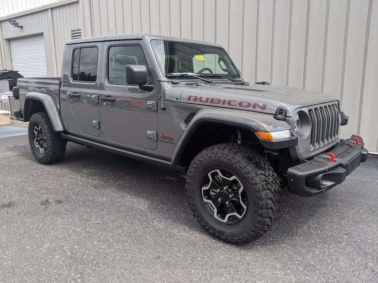

It looks like he has the $995 optional wheels for the Rubicon.
I guess they give you 5 of them and TPMS when you choose that option?

This one has the same wheels.
The sticker just notes the option, nothing about if they come as 5 and all w/TPMS

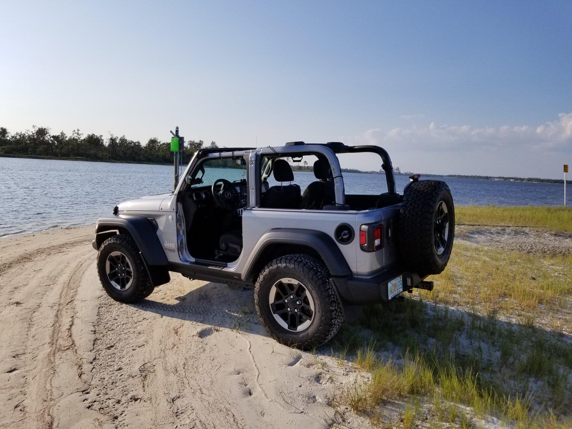

Our Wrangler has the Wrangler optional Rubicon wheels that also cost the same $995. (so maybe it does include 5)
Yup all 5 have TPMS, but only registers when they are mounted on the axels.
