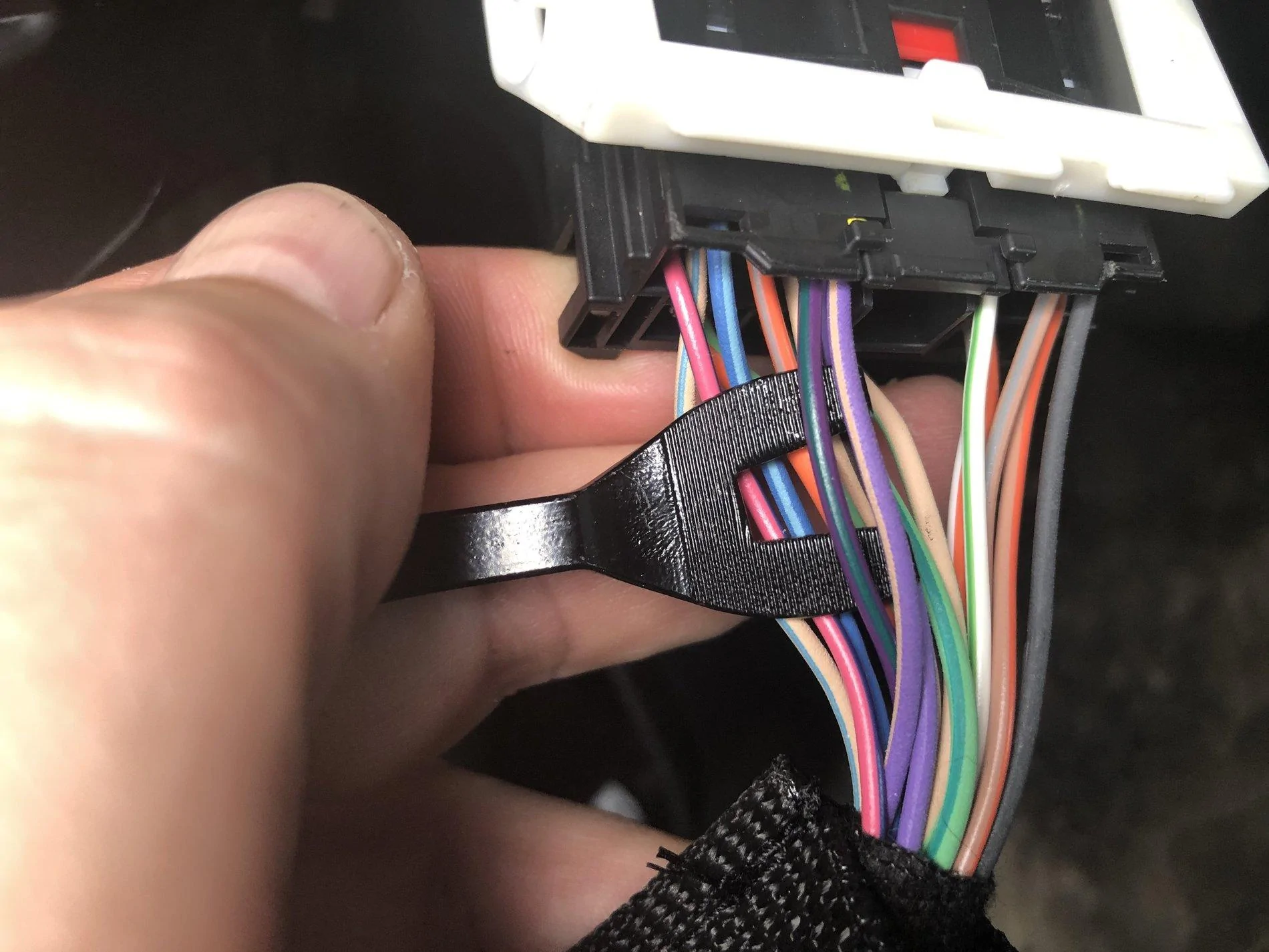

The other week I took the doors off for the weekend. After putting them back on, the remote start and power mirrors no longer operate. When attempting to remote start, I can look thru the drivers side window and see a dash message that says "remote start canceled, door open." The windows still go up/down, power locks still work. I do not have proximity entry installed on my vehicle. I checked each door wiring connection multiple times. On a positive note, the Auto-park feature no longer works!!! I hate that stupid feature, so I'm not sure that I actually want to fix the issue just yet. Anyone else have this problem?

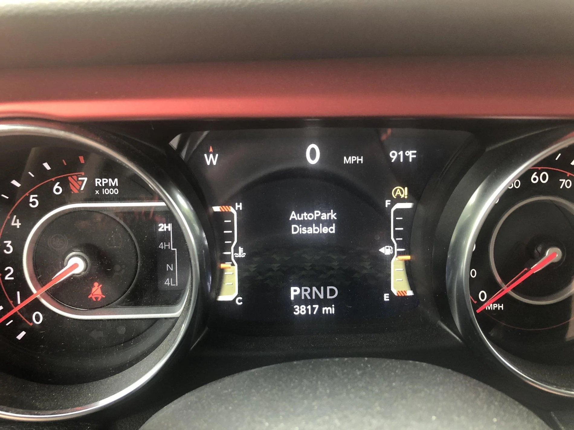

I found the answer. I had to get in there and really look at the pins. Narrowed it down to the drivers door pins in the footwell. I had 5 pins bent. If that plug isn't lined up perfectly when you go to flip the white lever, it will bend stuff but still shut easily.
AND...WHAT YOU HAVE ALL BEEN WAITING FOR!!!! The answer to the auto park!!!!!!!!!!!!!!!!!!!!!!!!!!!!!
The two pins that are connected to these wires (purple/blue, purple/peach) are the autopark and start stop. Out of the 5 pins that i bent over, 3 on the bottom row (mirrors and remote start), I left the 2 in the top row bent just to see and my start stop and autopark are still not working!!!!!!!!!!!! I do get a nice little yellow A in the dash now. Someone else can bend these around and figure out which ones which. Next time I bend them I will bend them to the correct position.

tried straightening the purple/blue pin in the female side and still can't get it to work. still got the circle with A like yours does. the pin looks pretty straight to me but it's hard to see tbh
