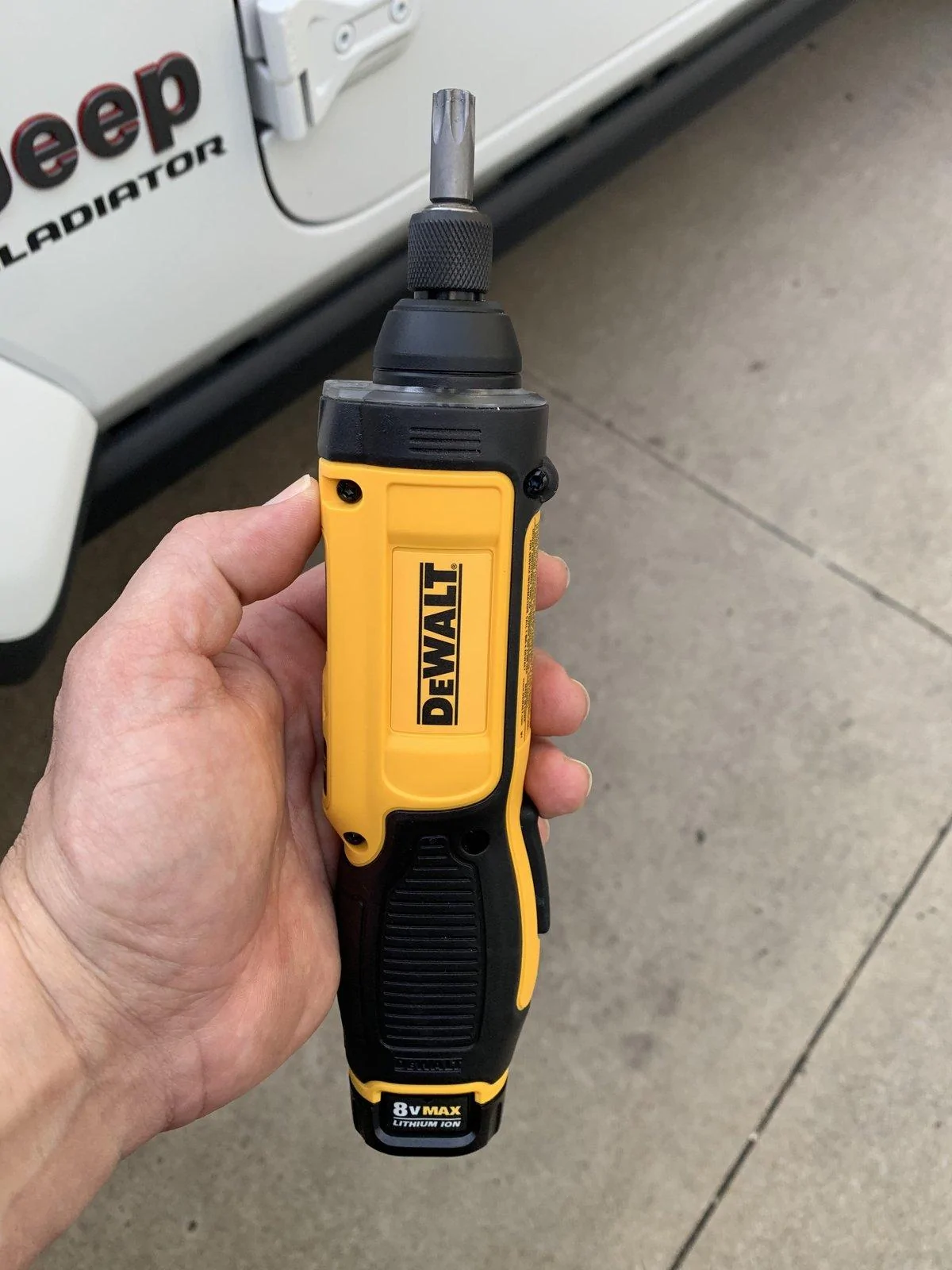

I took the screws out of the door hinges and I’m not looking back... 3rd Jeep non problematic. Now for the door catches I’m currently using the supplied wrench/tool for the door catch until I can to get a long bit from the hardware store for my drill.

On my JK the door bolts and freedom top knobs come out by March and don’t go back until December. I use a small cordless impact driver to take all the bolts on and off. The supplied ratchet handle makes the process a chore.

That's good to hear. I'll give that a good. That said, I used my drill to put in the door catch bolts yesterday and it was a breeze. The tip about leaving to door hinge nuts/bolts off was key. Makes the whole ordeal take way less time.
