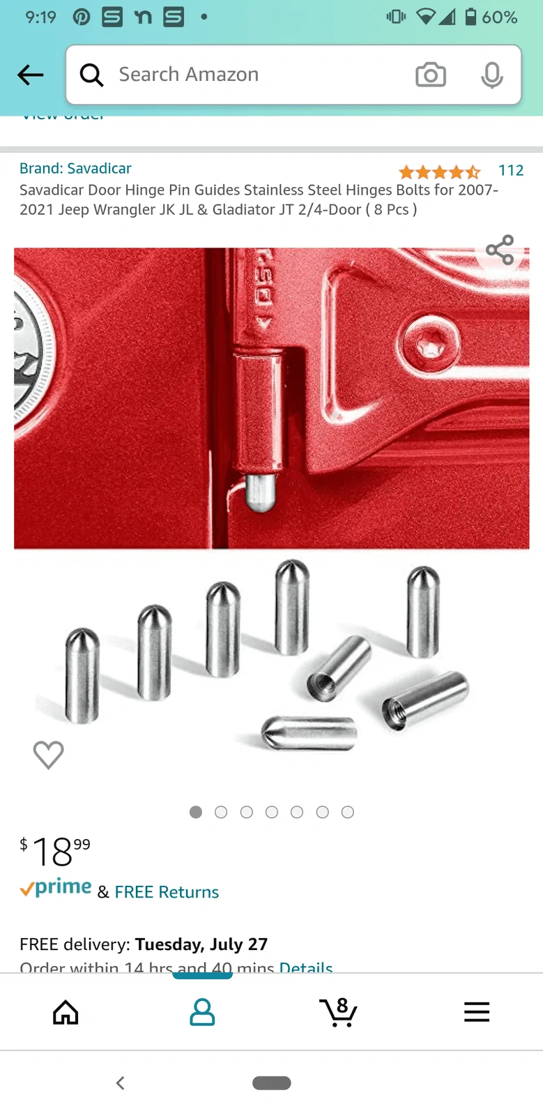

I'm not going to mess with the door stops, but I did just buy these so I don't have to do the hinge bolts anymore:
Jeep Gladiator Door Stops Screenshot_20210725-091915
