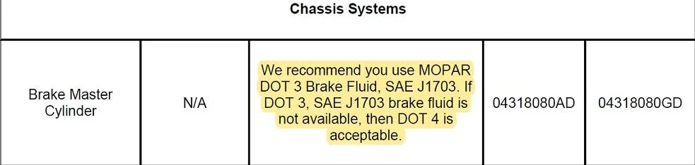

DOT 3 and if in a pinch, DOT 4 is an allowed alternate.
