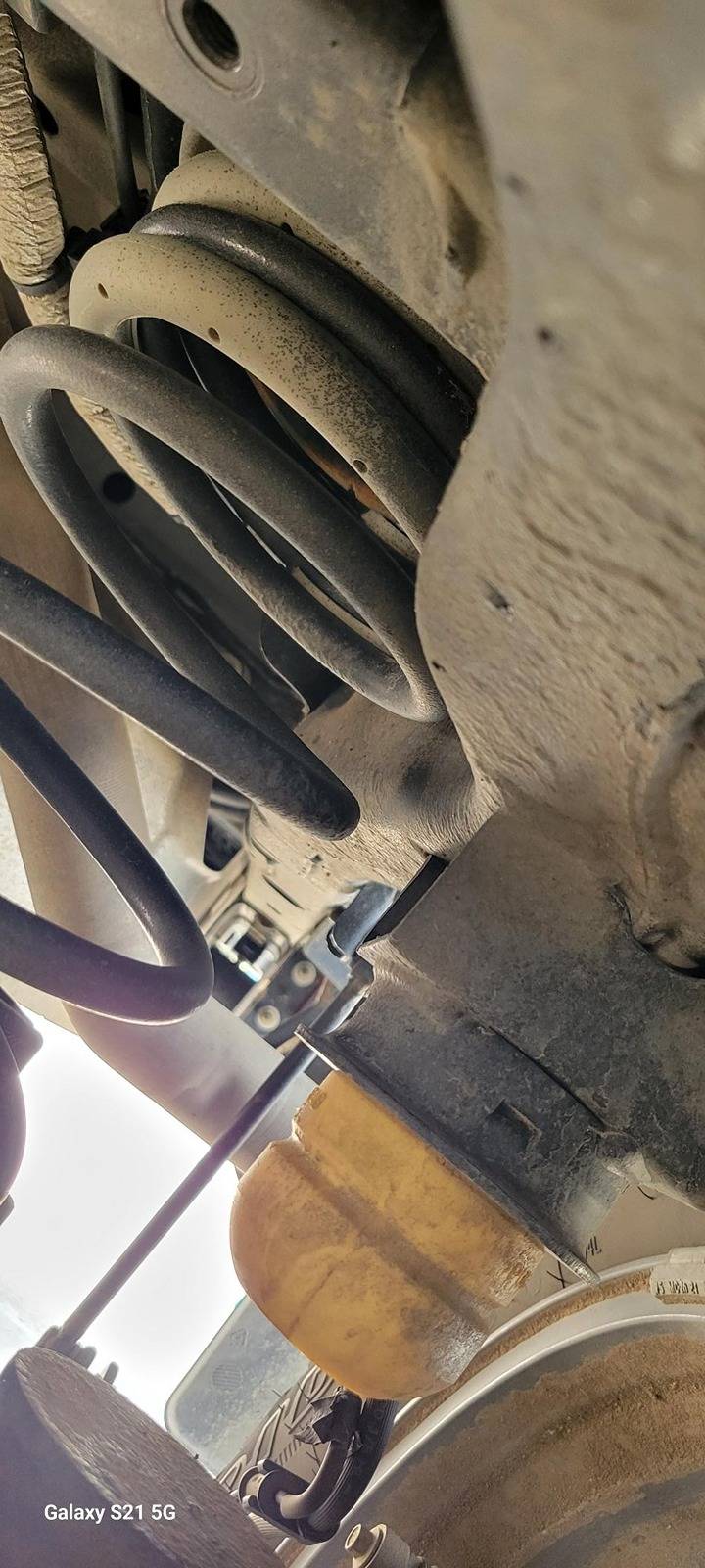

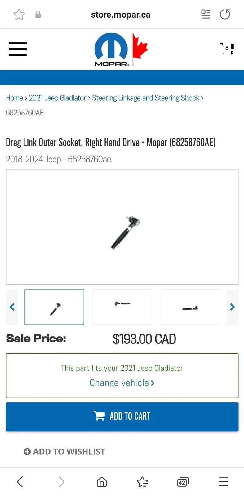

Well all was good. Until I went out for a quick test drive so I could come back give it a quick alignment and center the steering wheel. Well the wheel was off quite abit. No big deal, get under it to loosen the jam nuts and give the bar a twist or 2 and check it again BUT... the passenger side jam loosened no problem the pitman side was stiff so I tried and tried and grabbed a snipe for the already big Ol' crescent wrench but nothing. So, instead of leaving it be (which wouldn't be an option in the end anyway) I decided my only option was to pop it back off and put it in the vise in a better position for leverage, to get that jamnut loosened. Of course despite trying to be delicate, the boots now are toast on both ends(Moreso on the Rh end) after trying to be care with the pickle fork to no success. AND, to top it off that jamnut is welded in place already and isn't coming loose, Overnight, I just put it on by hand last night. Antiseized the inner threads on the bar (not the jam nuts as per instructions) so FML now I have a $625 brand new part on my Jeep that I'll be needing to replace, probably sooner than later since now it's worse than when I took it back off, enough to set the traction control light on the dash. I can't expect warranty for something that's kind of my fault (other than the seized jam nut). Pretty pissed at the moment.
Anyone else who reads threads saying these jam nuts back off easily and to make sure they're good and tight. I'd have to say that fella probably weighs 60lbs soaking wet. I'm not that massive of a guy and put the jam nuts on tight enough where I can't loosen them even though they spun freely with my fingers and weren't cross threaded.
I guess I should've just left it them loose to begin with before test driving and centering the wheel and I might not have had to deal with this until I needed to do an alignment again down the line. But, regardless I now know I'm not a fan of this jam nut style set up. I initially thought it made sense and would be almost as simple as stock. I now know better. I should've researched a little more to start and my fault I guess but it pisses me off having to spend money twice, especially within hours and no miles. Mostly venting here at this point.
