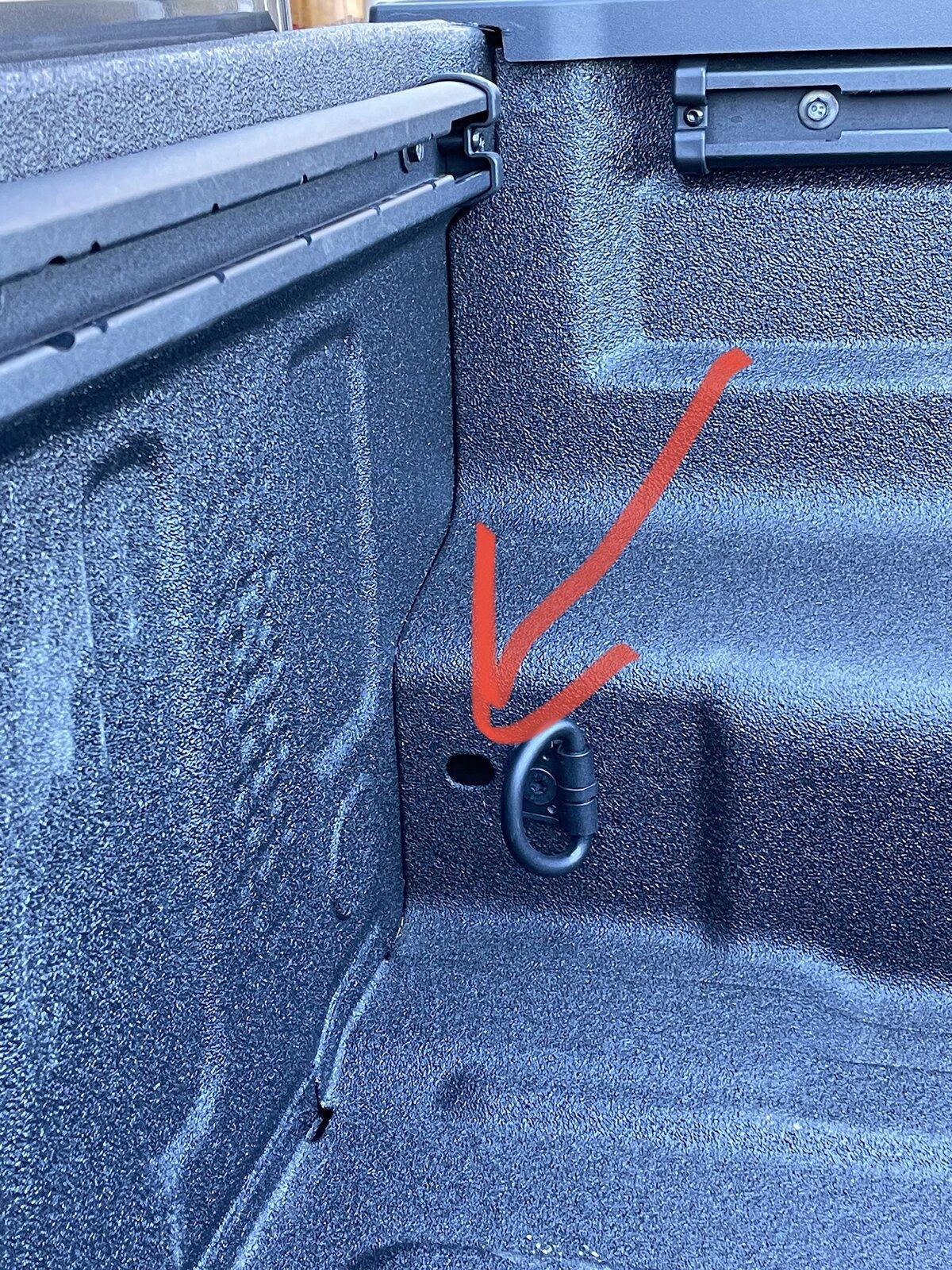

I’m thinking about getting the hard cover and saw it needs drain tubes. I saw these existing holes but was curious if anyone has used these as drain homes without drilling new ones.

I am using those but to be honest I'm not really sure if it's meant for that or not.
There's a spot on the back of the bed where you are "supposed" to drill out for the holes. You can see it just to the left in the picture, under the bedliner.
I tried to look under the fender but couldn't really see where the hole leads. I figure it's not water-tight as it stands with a gaping hole so there's probably not a lot of danger in doing this.

I also used those holes and traced the drain hoses to inside the fender wells. All good.

And the holes you used are the ones in my photo? I would hope those drain to the ground. Or why have them? LOL
That was my logic. I don't know exactly what they are for, but they certainly don't keep water out open to the air like that. I'm not really sure what would be harmed under there to begin with.

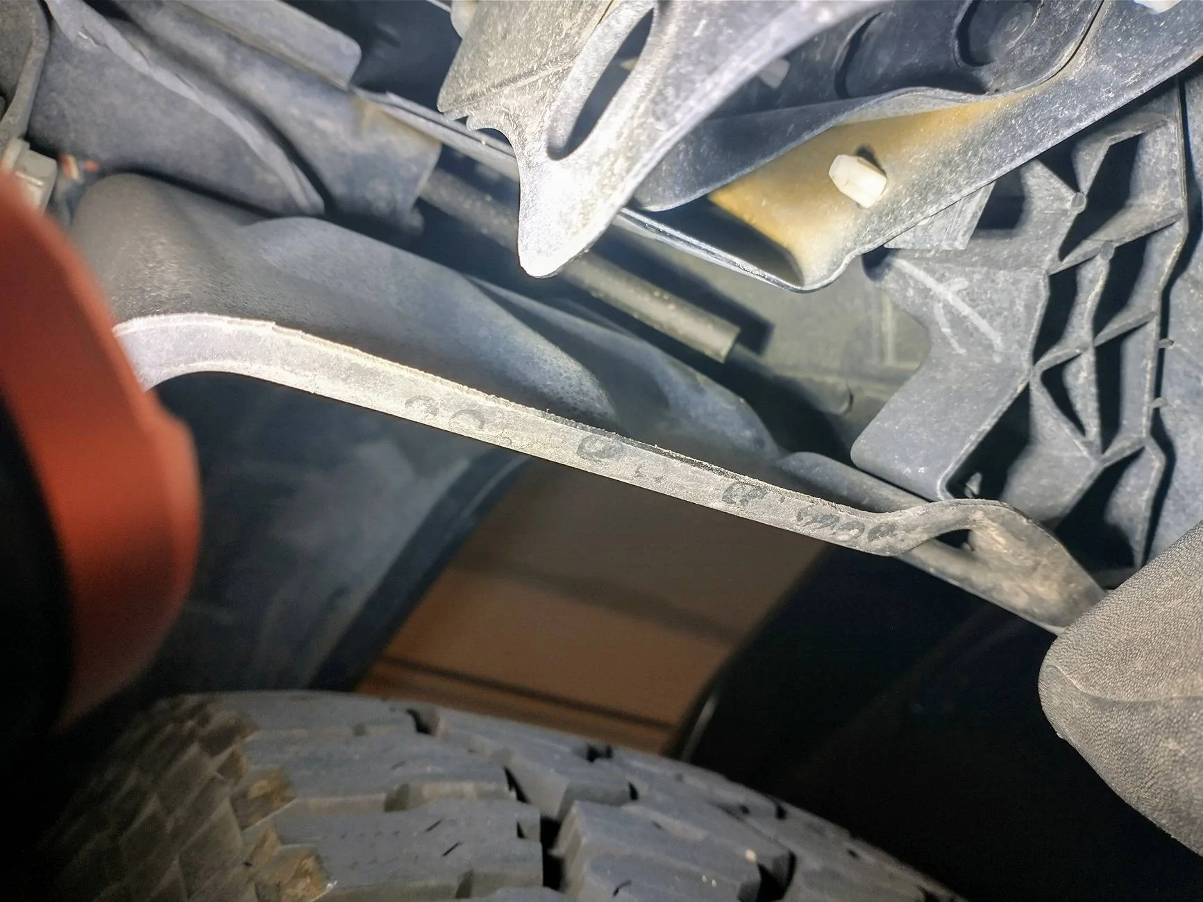

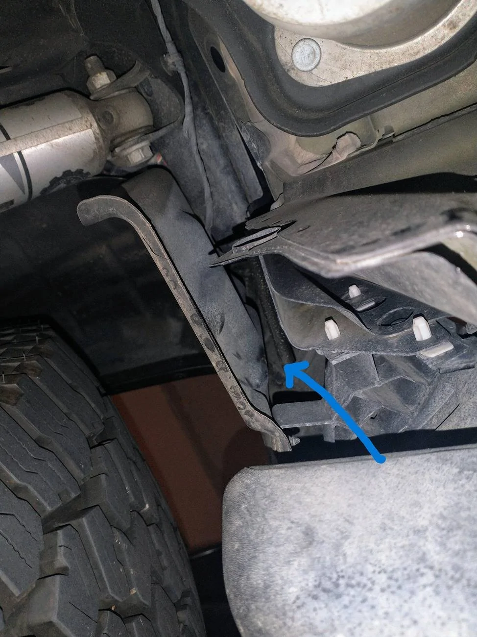

Yes, those are the holes I routed the drain hoses out of. Once you snake them through, you can clearly see them in front of each rear tire, draining directly out of the bed area.
I’m not where my Jeep is but I’ll post a pic of the hoses from underneath tomorrow.
