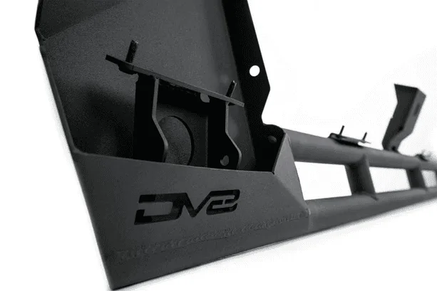

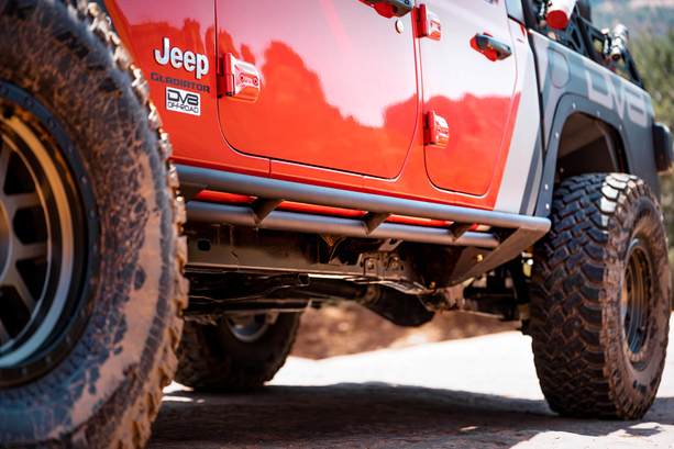

Looks to be mostly pinch seam bolts with 1 frame bolt. Kind what you'd expect from DV8 honestly.
You going to be using them as sliders or steps? Because these are basically a metal version of the plastic Overland step board with 1 body bolt tossed in, and that's probably more to support the pinch seam bolts than support rocks.

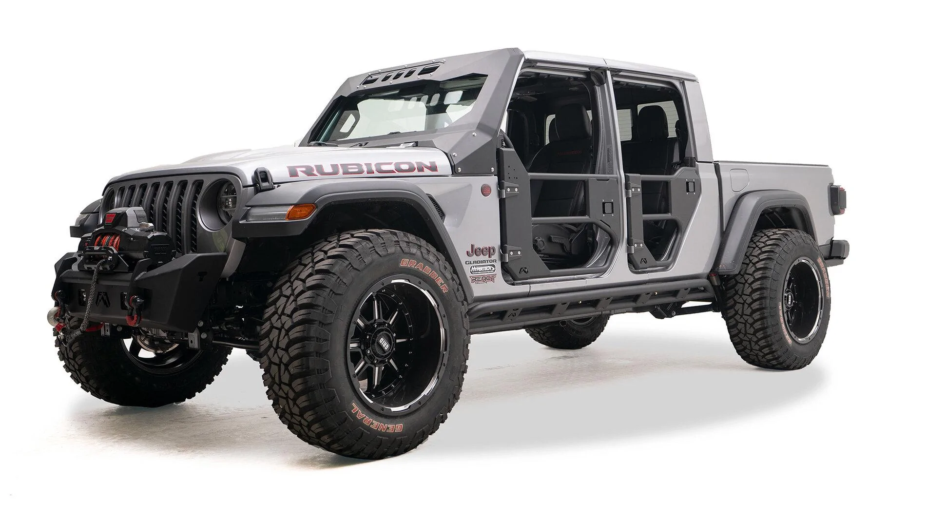

It seems like DV8 is more fashion over function, so I'm definitely going to go another route.
The Fab Fours look like a viable option, even though they don't cover the pinch seam....but not much to step on.

Those are crazy thin metal. Only 0.120 inch thick tube which is why they are so cheap. They are at least body mounted. But in general Fab Fours is also going to be a 'for show not go' brand.

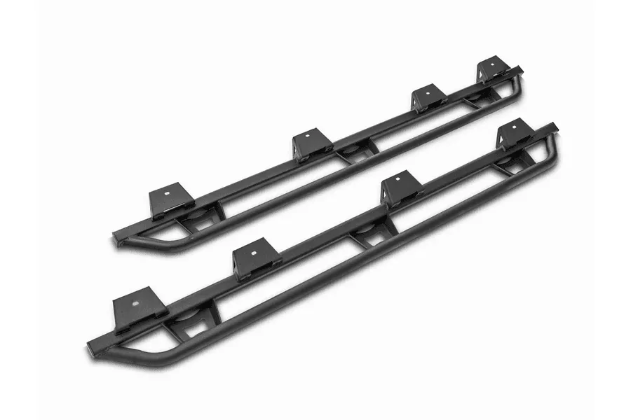

In that general price range, I think your best bet is going to be NFab. 0.188 thick tube and body bolt mounted. Will not hide the seam. $787 at Northridge.
