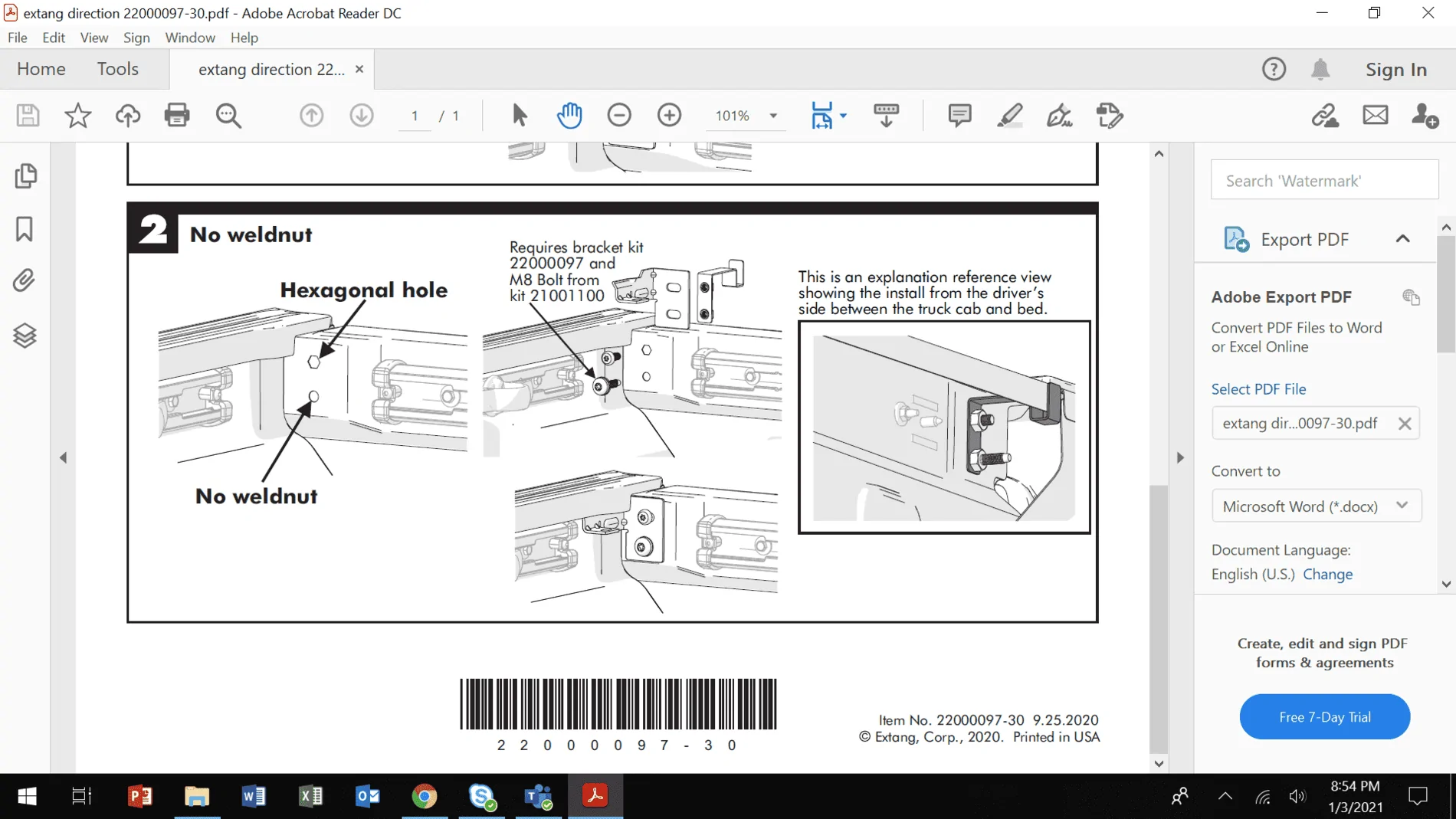

Rugged Ridge (Extang) now includes a bracket kit (or they'll send you one for free) that has weld nuts that are part of a "L" shaped bracket that goes between the bed and the cab. It was much easier to hold that bracket then trying to get small nuts and washers back behind there
