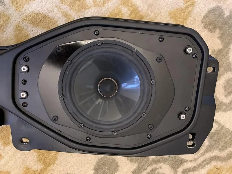

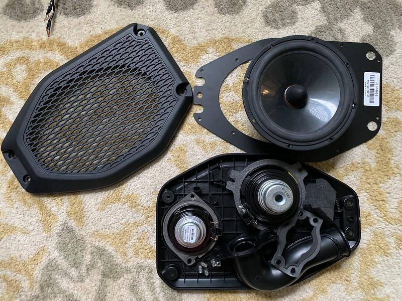

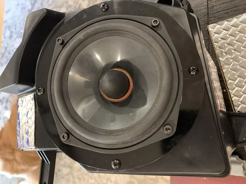

Did this to our soundbar as well - but used 6.5" mids instead of 6x9" speakers because of how small the soundbar enclosures are (personal preference here, 6x9" speakers would be much easier to install with this kit):
Jeep Gladiator Easy rollbar speaker upgrade for Alpine Premium system 51312010240_4743c51ecf_c
Removed the soundbar to make installation easier:
Jeep Gladiator Easy rollbar speaker upgrade for Alpine Premium system 51337513085_c461570171_c

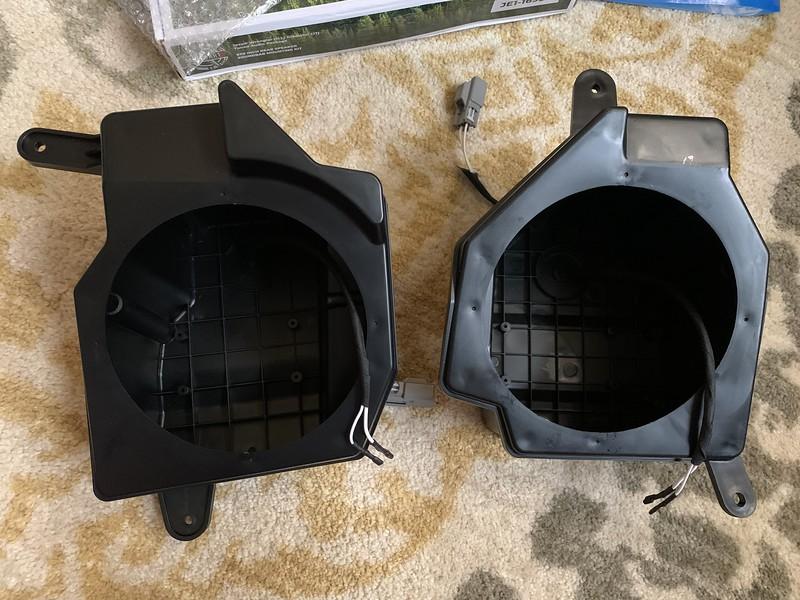

The MB Quart adapter plates and new grille compared to the stock setup:
Jeep Gladiator Easy rollbar speaker upgrade for Alpine Premium system 51336509706_2011d4eab0_c

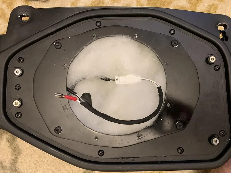

After cutting the opening larger, applied a bit of dampener:
Jeep Gladiator Easy rollbar speaker upgrade for Alpine Premium system 51357599365_76dafb0ab3_c
Used polyfill to stuff the enclosure, fabricated 6x9" to 6.5" adapter baffles out of some scrap aluminum, and plugged in the MB Quart adapter:
Jeep Gladiator Easy rollbar speaker upgrade for Alpine Premium system 51356814998_bede459c29_c
After all adapters and speaker were installed:
Jeep Gladiator Easy rollbar speaker upgrade for Alpine Premium system 51355844902_a4dc872ac7_c

Used more dampener inside and on the outside (they are hidden inside the dash so you can't see the dampener on the outside of these), stuffed with polyfill again, and modified them to house 5.25" mids using aluminum baffles/adapters (personal preference once more, as the volume inside is still limited, and the JL C3 6.5" mids wouldn't fit due to their basket shape/size):
