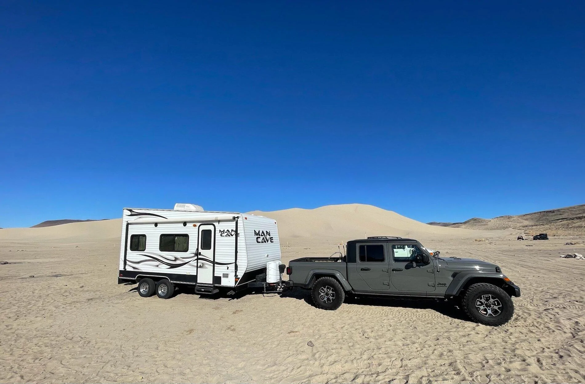

I cannot help you with the diesel part . I can offer some towing advice with a max tow. I just bought a man cave toy hauler. It weighs 4000k +change. I put about 1000lbs in quads and another 200 or 300 lbs in food and clothing and 60 gallons of water. I towed from Sacramento to Fallon NV with a gas Max Tow. A steady climb to 7800 ft. All can say between 3000 and 4500 rpms it just chugs. I pulled it at 65 over donner pass. I felt the 5500lbs was no problem to pull and the oil, tranny, and water temps stayed completely normal. I would say a 5k trailer would be totally doable with a set of torsion bars and a anti-swaybar on a gas max tow. Good luck in your choice.
