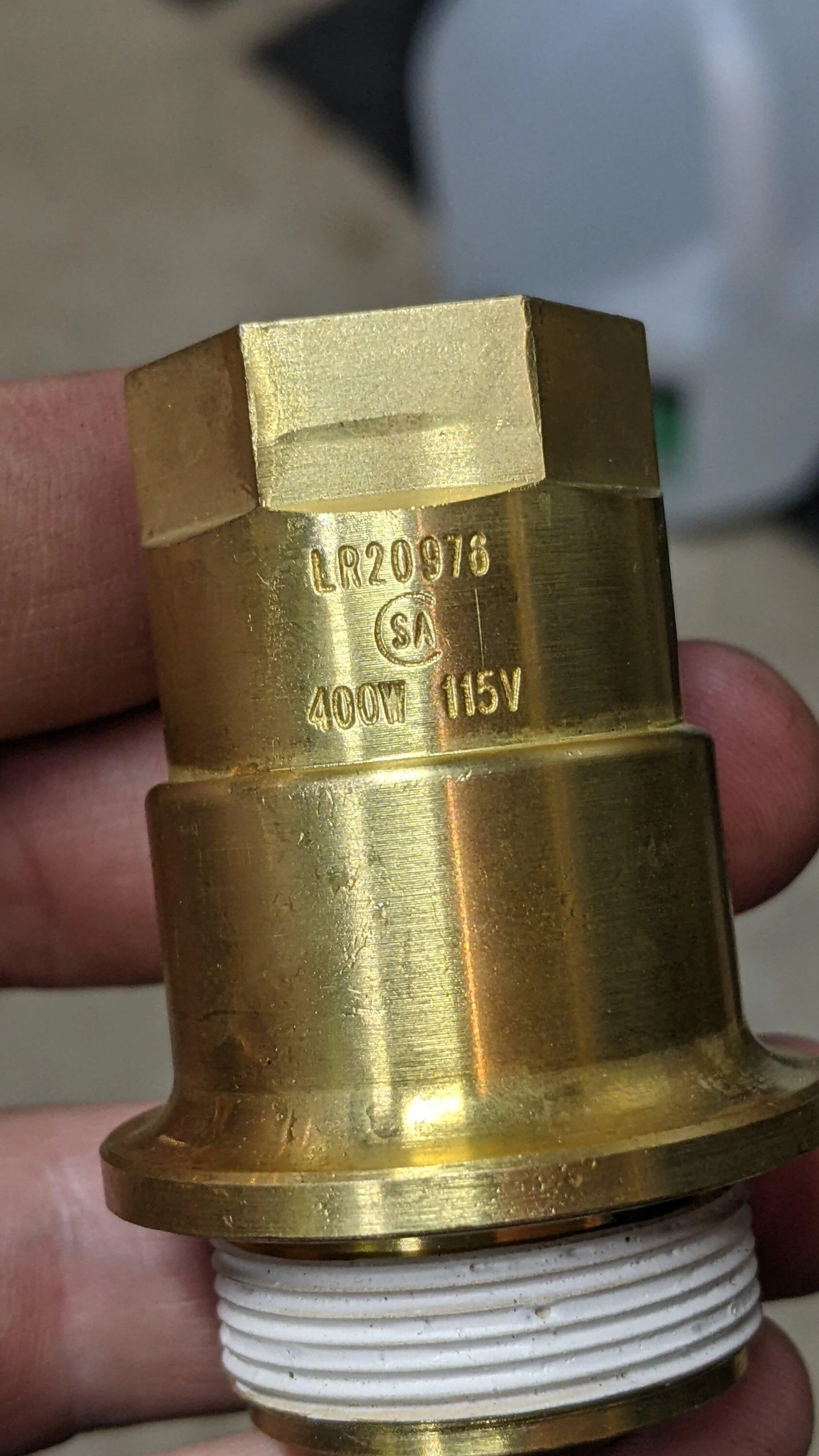

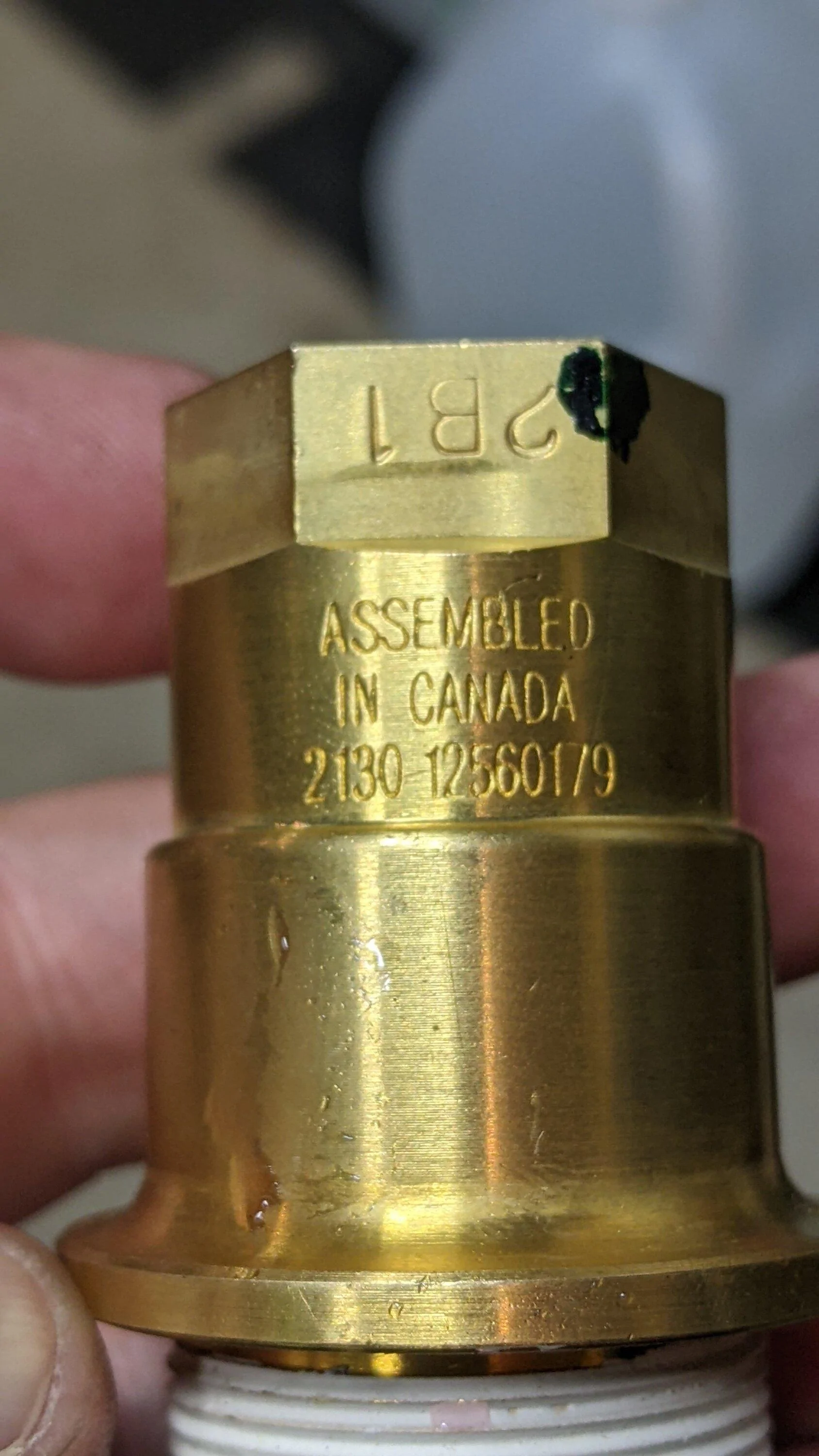

Block Heater PN: 56044738AA

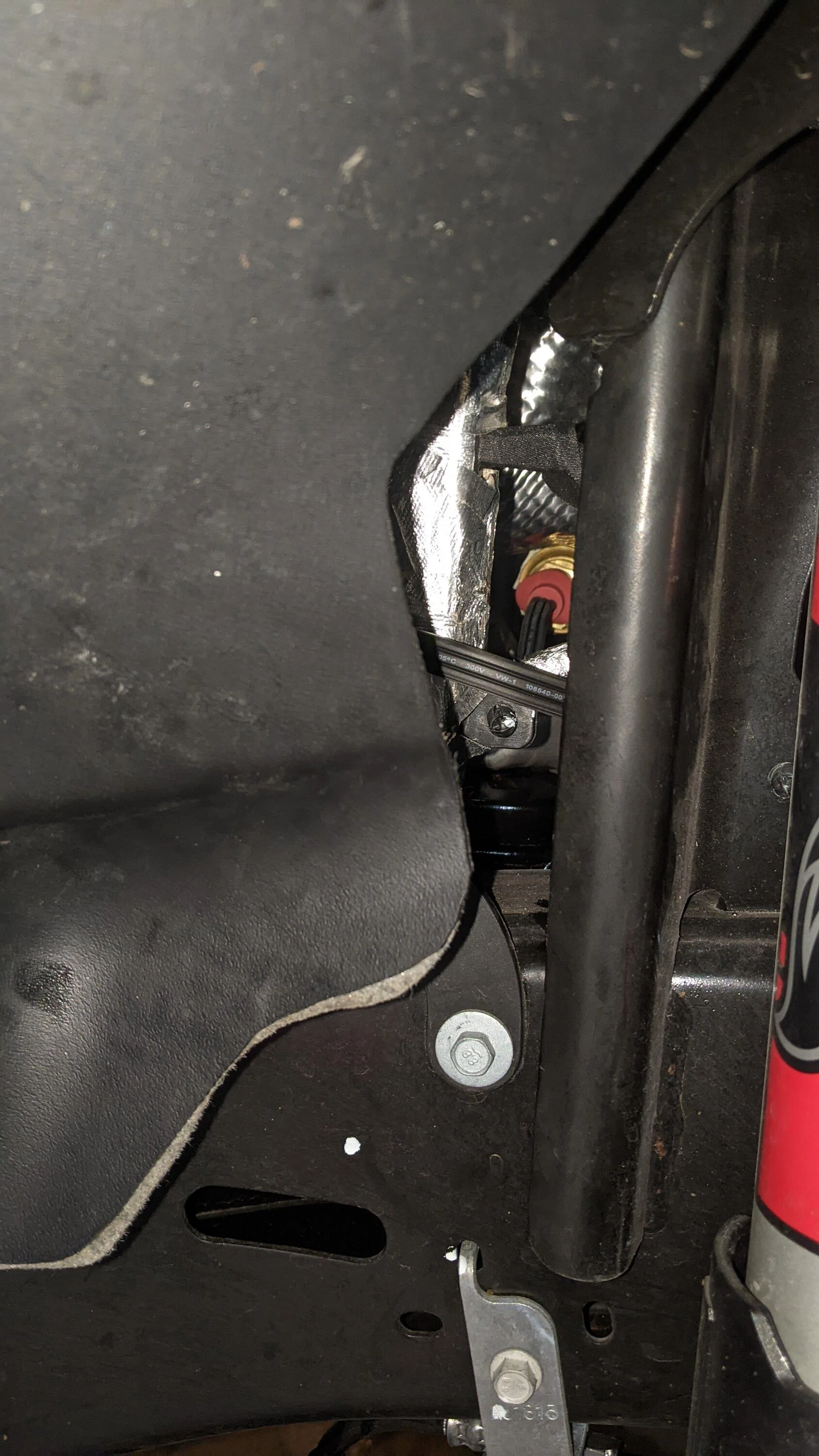

Looking in just behind the shock tower on the passenger side, you can see the block heater plug. If you look in and see a red cap on it, then you already have the block heater. If it looks like it does here, it's just a plug. That unscrews, and your block heater screws in in it's place.
Jeep Gladiator EcoDiesel Block Heater Installation PXL_20220929_214235125

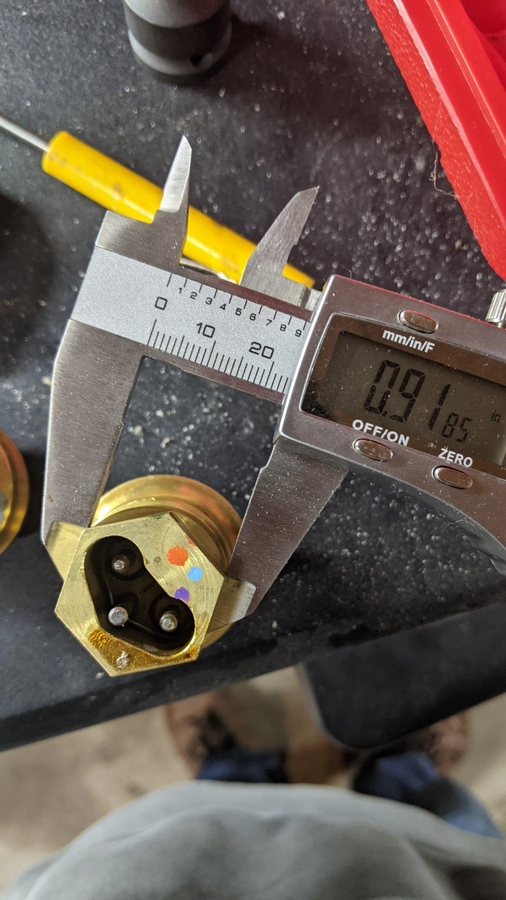

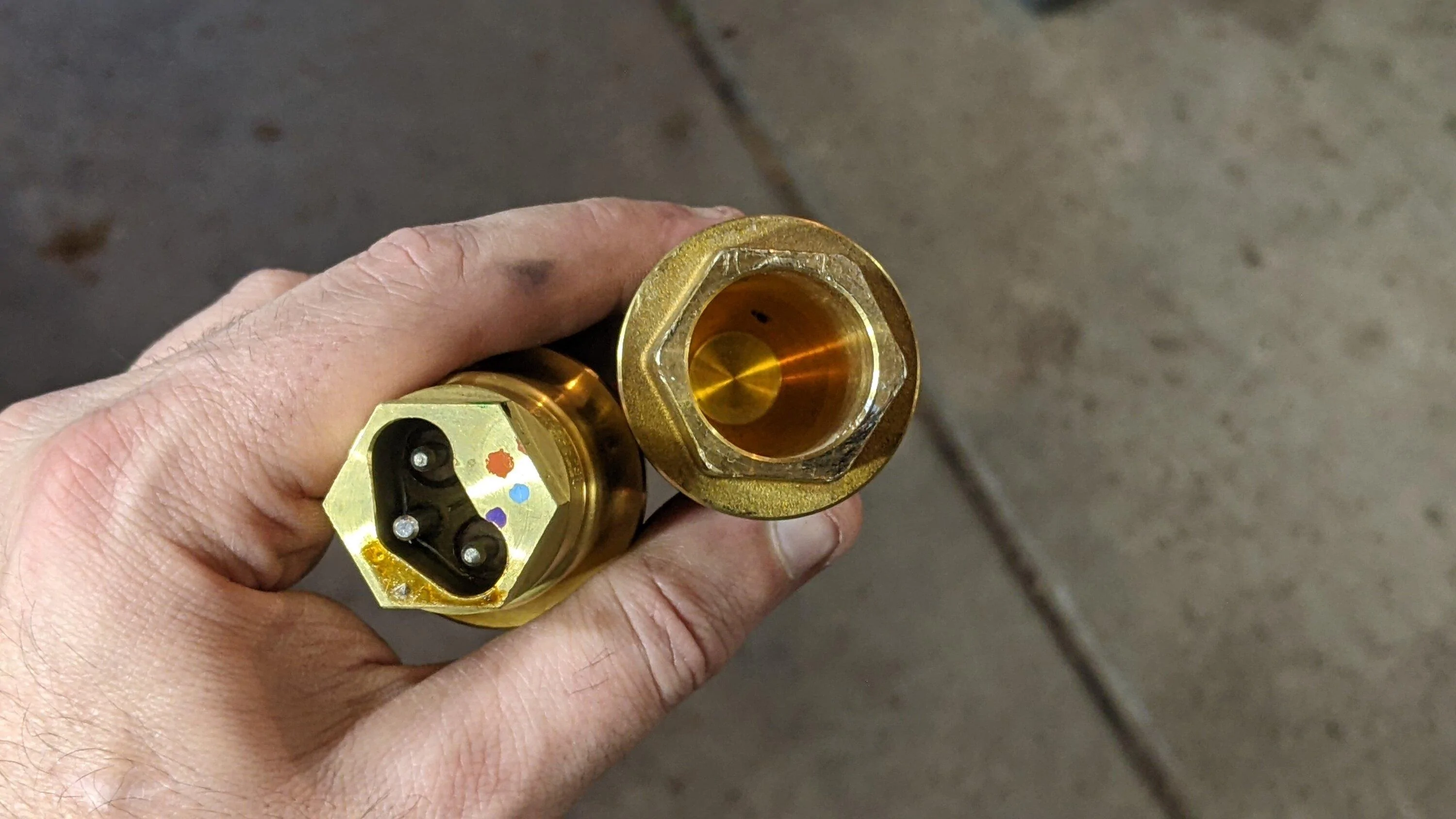

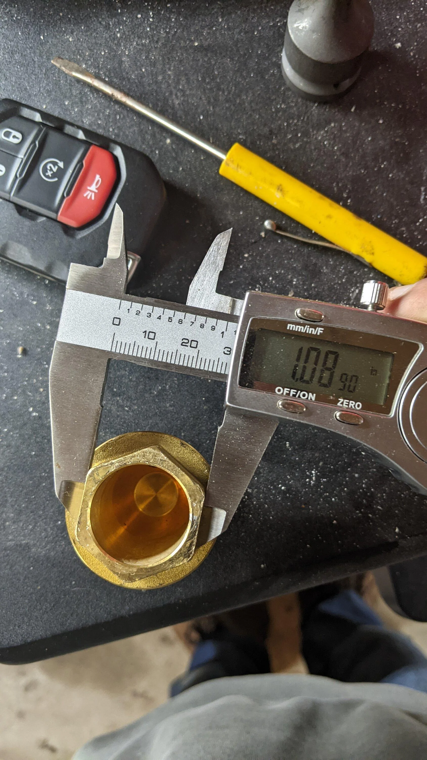

It looks like a 28mm socket would be the right size for removing the plug but I either don't have one or it's clunking around in a frame somewhere. I used a 1-1/8" socket and it worked fine. There's a heat shield directly above the plug that may require a bit of massaging to get the socket over the plug.

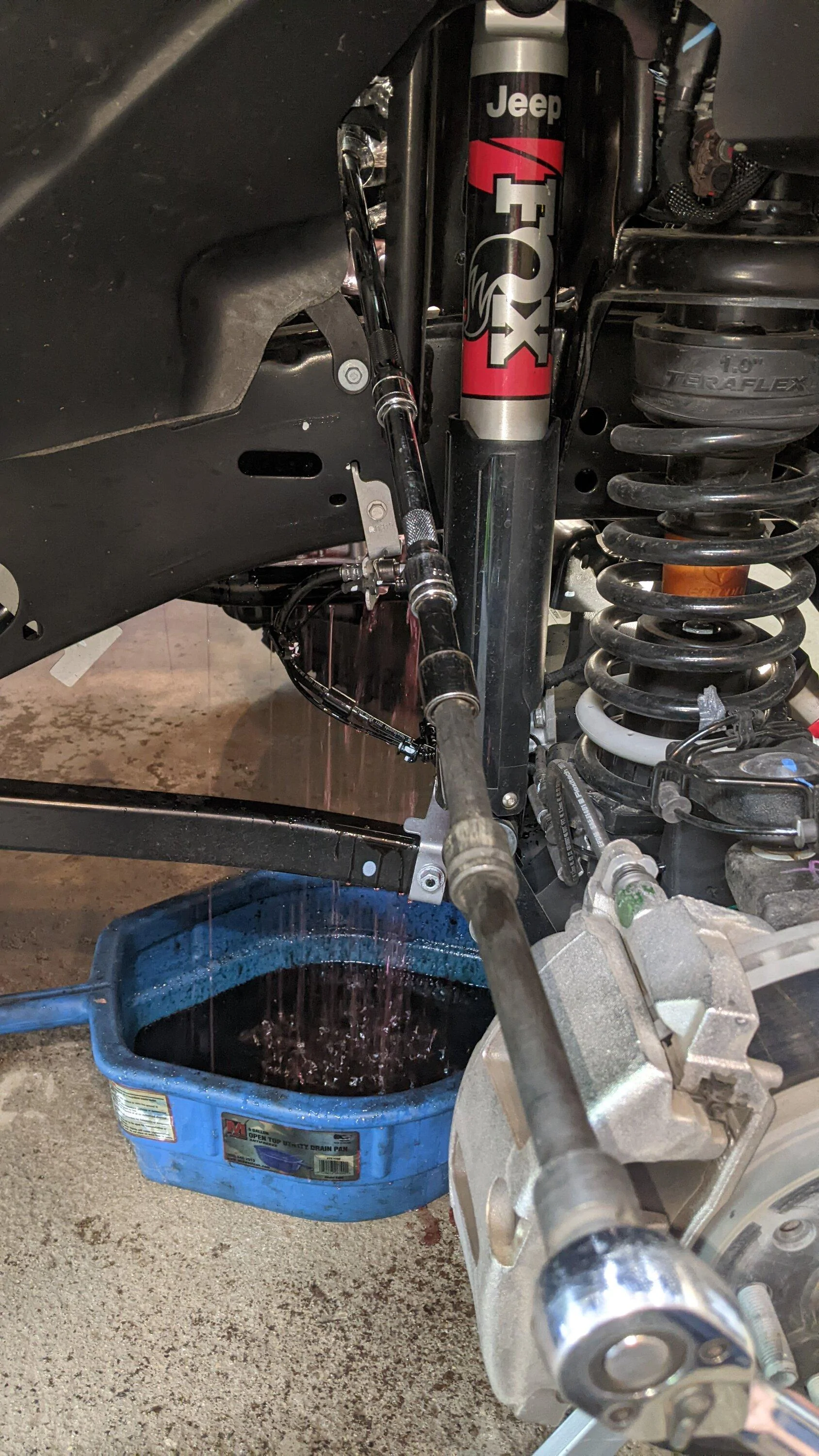

Getting to it from the top, or directly beneath, or behind, seemed almost impossible. Getting to it from the front seemed doable, especially if you jacked it up by the frame and drooped the axle for more room. I opted to go straight in from the side with a bunch of extensions. It's a large diameter thread, so it takes a bit of torque to break it loose. Coolant is going to go everywhere, be prepared.
Jeep Gladiator EcoDiesel Block Heater Installation PXL_20220929_221643271
Jeep Gladiator EcoDiesel Block Heater Installation PXL_20220929_222112809

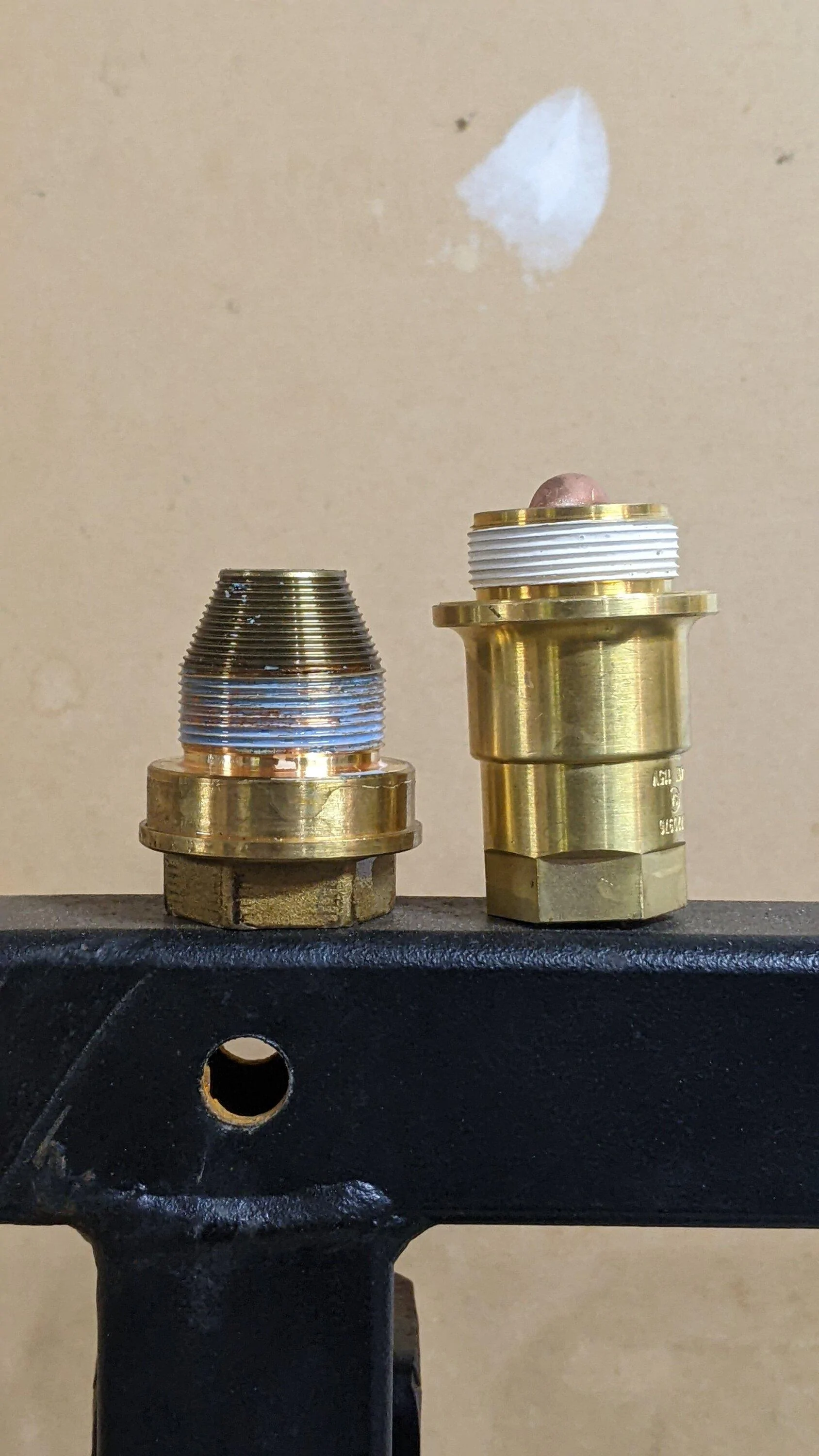

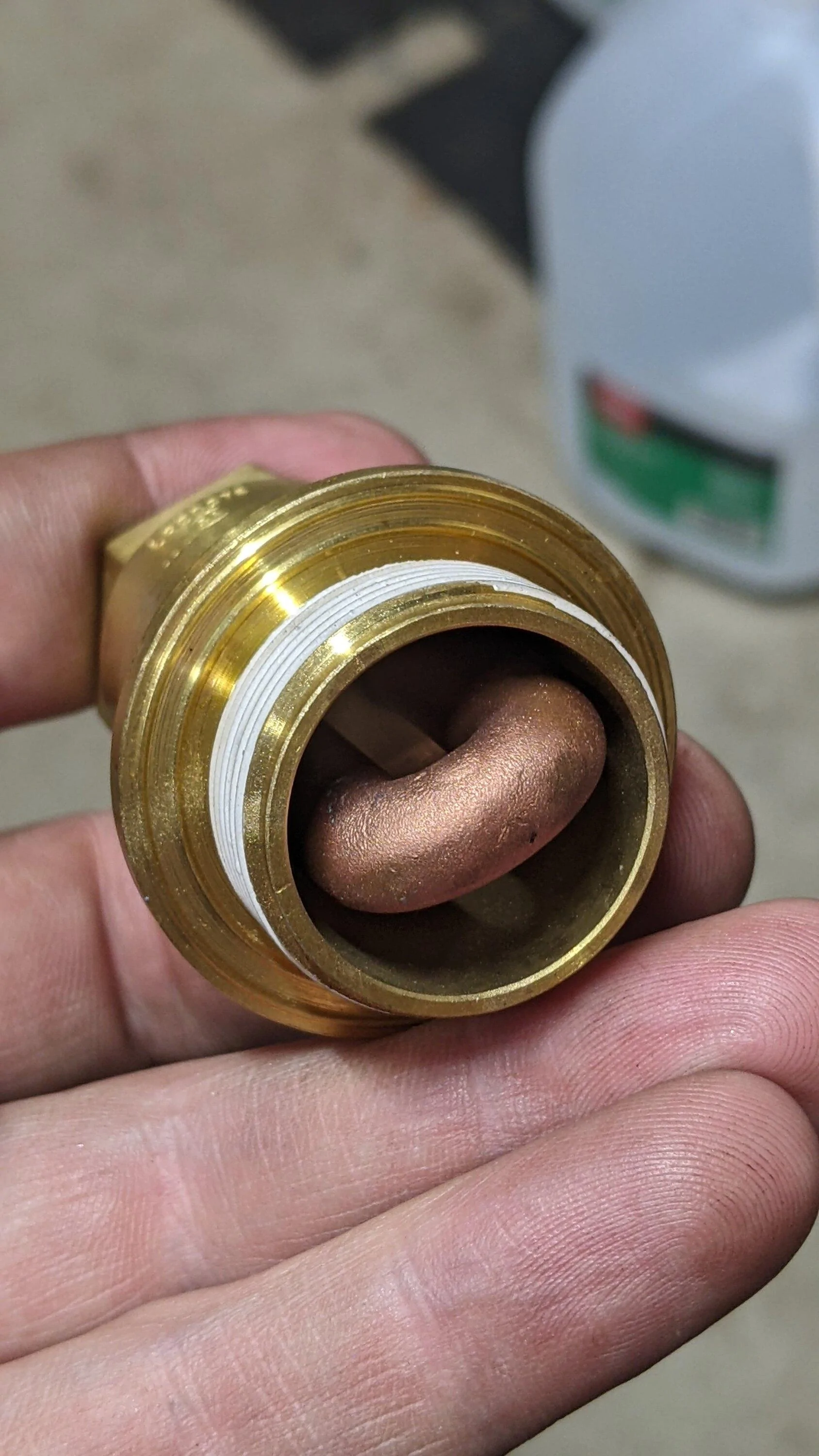

Block heater, comes with teflon tape applied:

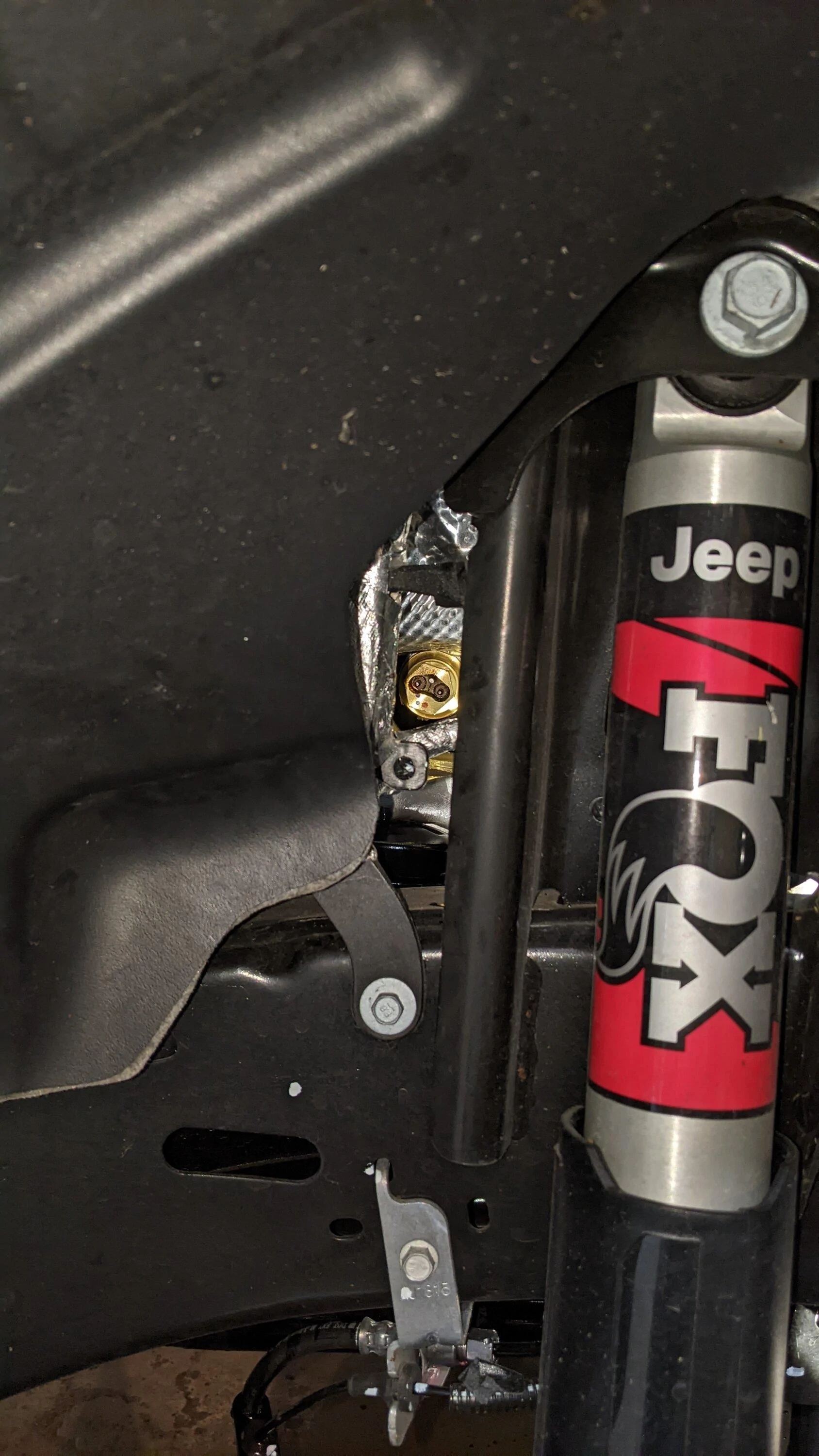

I reached back through and threaded the new block heater in using a 15/16" socket.
Jeep Gladiator EcoDiesel Block Heater Installation PXL_20220929_222046334
Installed:
