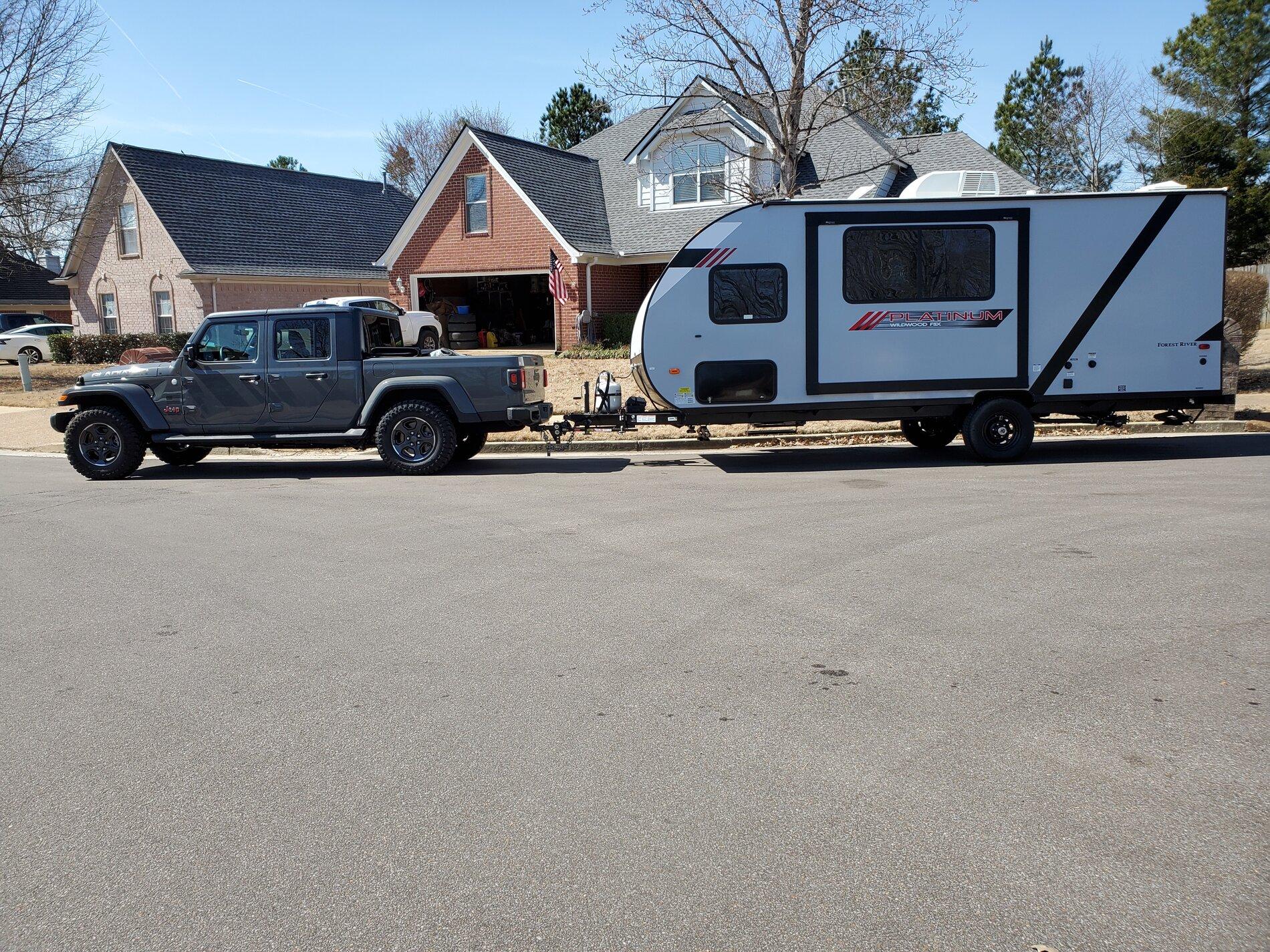

We have had our 2021 Sport EcoDiesel for just a few weeks now.
I used it to pull our 4,000 lb. (dry) camper to the house for some de-winterizing and then put in on the highway for some 65-70 mph cruising to see how it pulled.
My coolant temp seems to normally run ~203 degrees with just the wife and I in the truck.
Pulling the camper at 65-70 mph, the coolant temp stayed around 213 degrees.
Just trying to see if this is what other Gladiator EcoDiesel owners are getting with a similar sized camper.

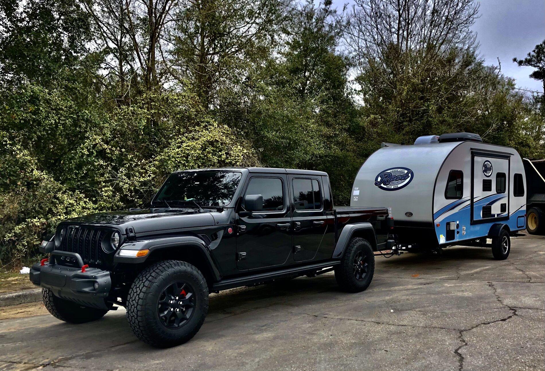

My camper weighs 3,500 lbs and my temps are right where yours are. I have seen the oil temps hit 235 before.

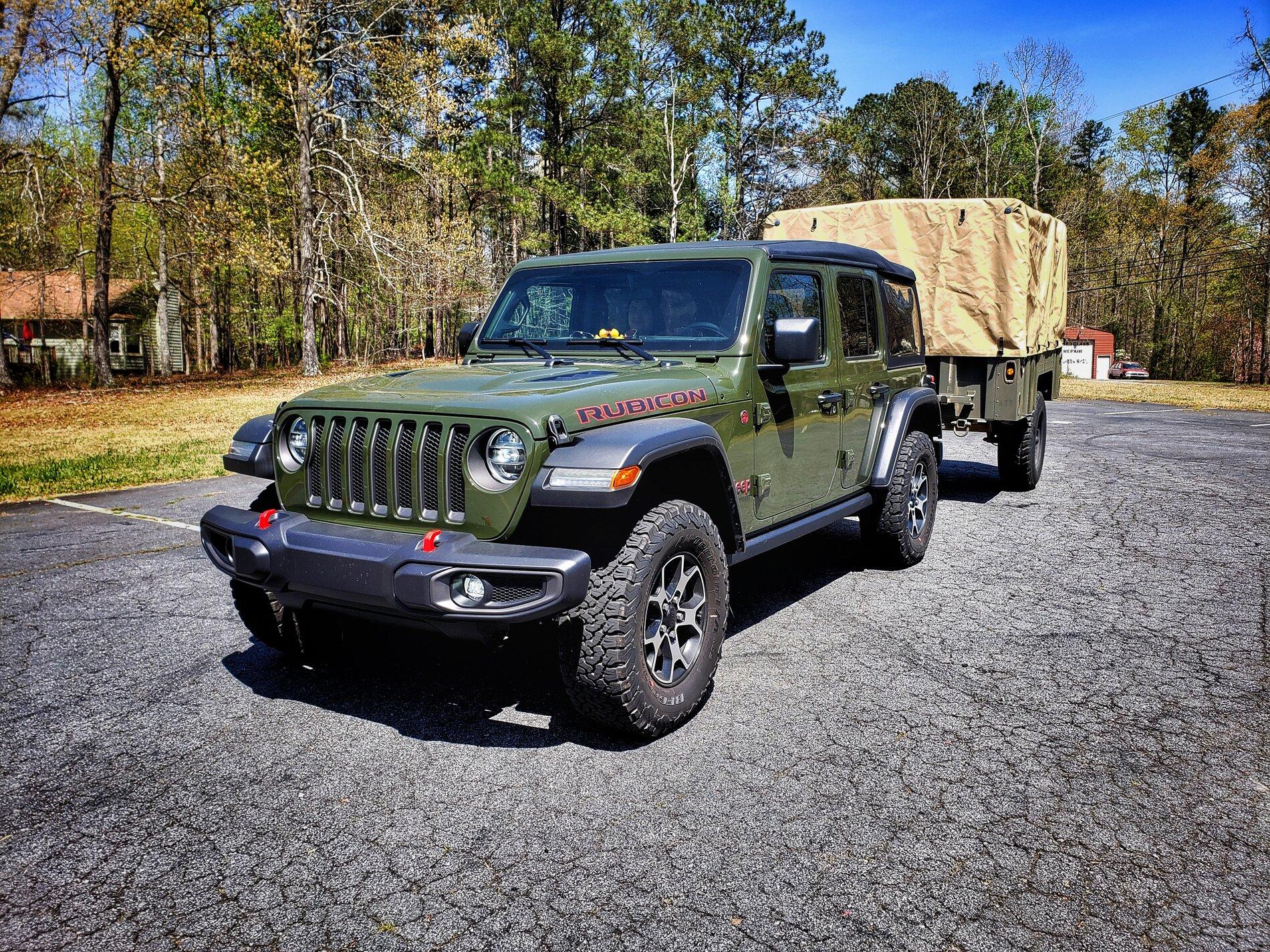

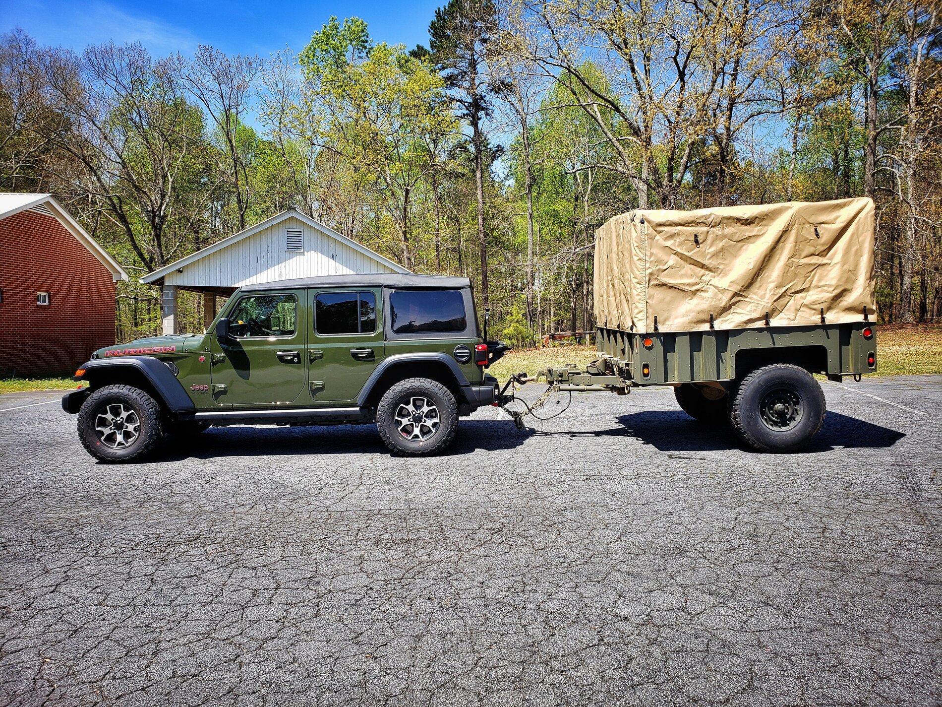

JLURD here and just towed this massive parachute 450 miles yesterday. Bad day to do so as we had this cold front coming in with stout winds. We saw our oil temps rise to 250, although trans and coolant temps were not an issue. Even at 250 though the gauge isn't reading high so to say. So I guess the L630 is just designed to run hot?
Ended up drinking through def on the ride though. Just had to add a box at only 2360 miles after the ride.
FYI we normally only tow the trailer with the top on slower roads not highways or interstates. However I was expecting to be outbid on at least 1 of the 2 govplanet auctions I recently bid on. Well I won em both so the trailer had to go on the ride as isšŸ¤£šŸ„²
