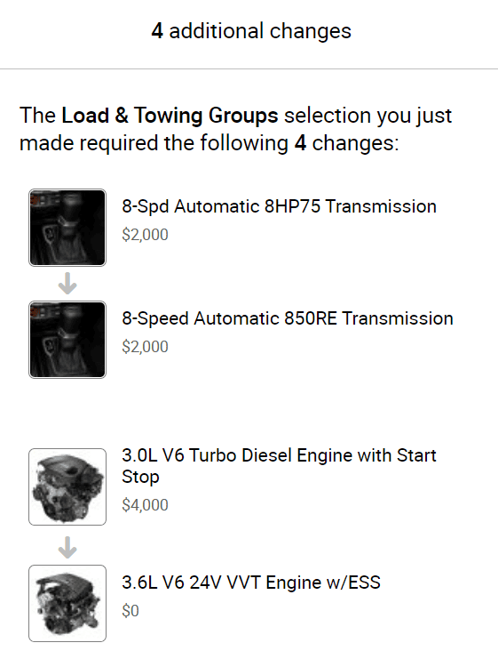

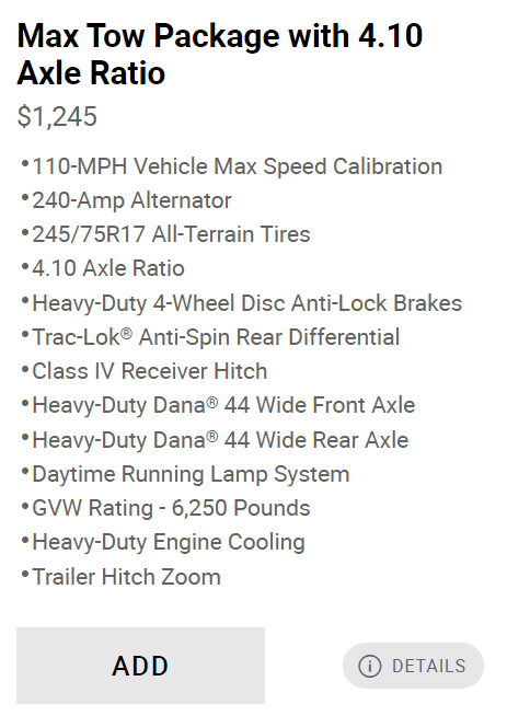

BTT for the OP's original question:
Is the EcoDiesel available with the Max Tow Package (in any trim) in order to get the Heavy-Duty Dana 44 Wide axles?
If I select this package when building a Sport S the configurator forces me to de-select the diesel. I didn't think 4.10 gears were available for the diesel so this isn't a huge surprise.
Is there a trim where the Max Tow package can be added with 3.73 gears to the diesel?
If not does the diesel already include the wide axles? I haven't seen this definitely answered either, although I believe they are the M210 front and M220 rear in the narrower width based on something I read on the JL forum.
Jeep Gladiator Ecodiesel Max Tow 1607404372657
Jeep Gladiator Ecodiesel Max Tow 1607404417442

You cannot get the Diesel engine with the Max Tow package. You can get the Standard Tow Package with the Diesel engine.
