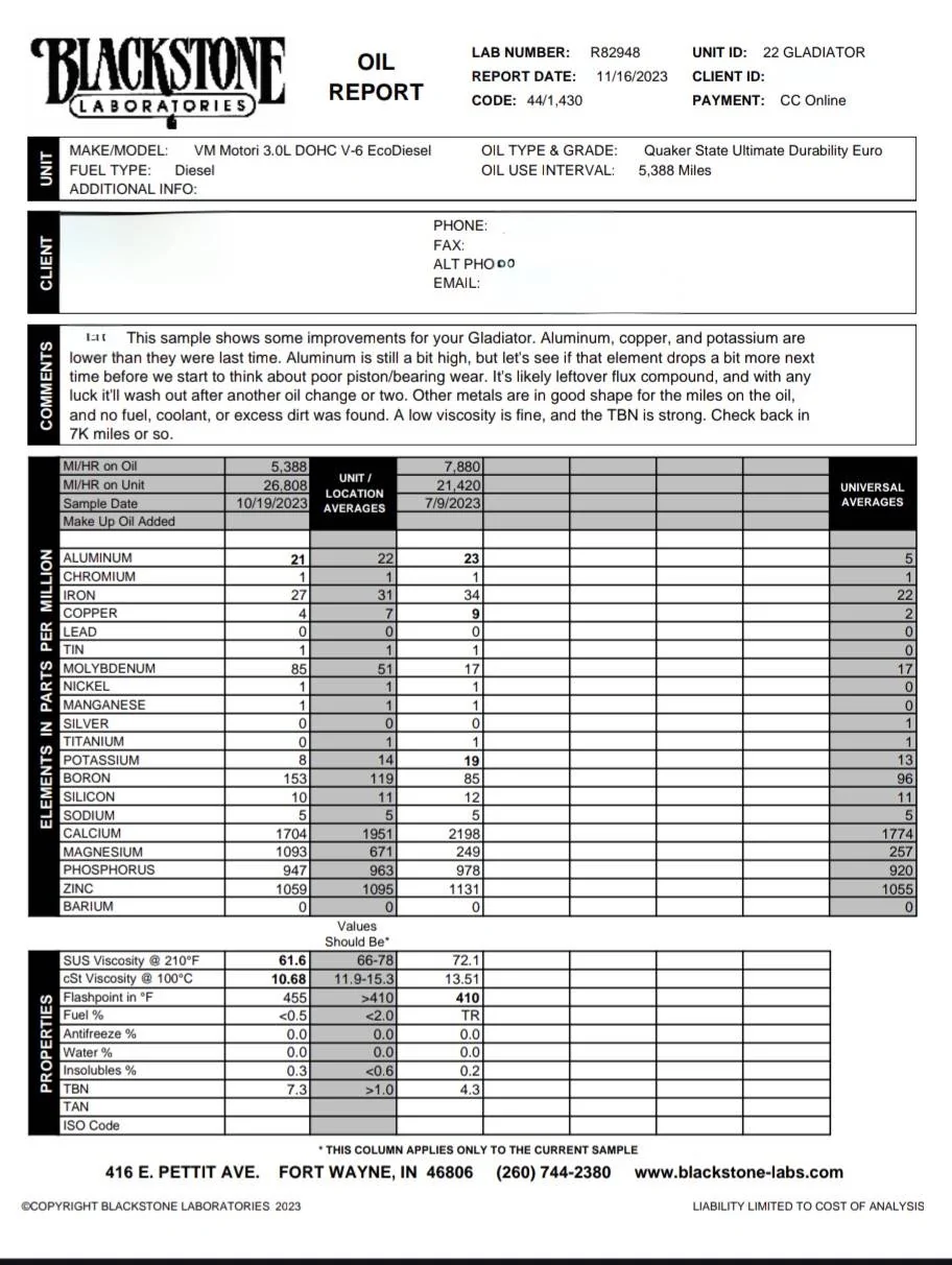

Alright here's the latest from QS euro through a stp filter, 5388 miles , GDE for the full interval I did have mine reflashed to the latest release after I did this oil change based on reading up on the ecodiesel ram forums. Once I get the new pump I'll go back to GDE.

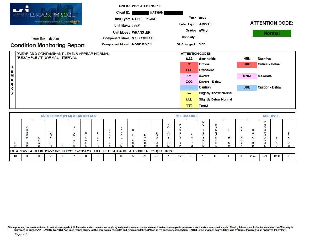

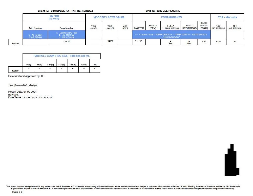

Results after running Amsoil's 5W-40 FS Euro. Roughly 21k miles on the Jeep and 4k miles on this oil interval.

Thanks for posting! Wow that lab is nice it has the ISO and only $25
The report is pretty good considering it is a Group 3 Oil. Amsoil no longer uses a PAO Group4/5 Ester. Even there Signature Series is a Group 3+ . Hot Shots has a some PAO oils and So does Redline Oil. The problem is just like this Amsoil's 5W-40 FS Euro is that it is not an approved oil and warranty has been void using. It. There is no API Starburst and API SN Donut on the back. It's not licensed unfortunately. I did my first oil change at 795 Miles and will do another at 4k Miles and every 4k Miles there after. After listening blogs with industry leading tribologists, they say TBN needs to be 7 and up in a Diesel for max life of engine. I would 100% dump this oil and change it because your right there. With a good bypass filter system and a Group 4/5 Oil you can go much longer and do so by using TBN boosters and lab work. Thanks to Castols win in court, Group 3/3+ GTL oils are NOT True 100% Synthetic base stocks molecules even though they claim they say 100% or "Full Synthetic"
With that said I plan on doing secret oil changes in-between the 10k mark that Warnaty would not know about to test both Redline Oil and Hot Shots PAO. Let see how they do with lab work if it's worth to use or not in my case.
Also it shows fuel but don't see a number for dissolution. In the Manual it states that if you EVER use B6-B20 fuel, you must change the oil in 6 months and not the year because fuel dissolution give excelatrated wear. This is why I 'm going to do my changes at 4k.

Thanks for the feedback! I'm new to oil analyses, so I'm happy to get informed about how to read these things. I've been doing oil changes every 4-5k since I bought the Wrangler new.
I'm currently running Hot Shot's Secret 5W-40 Gray Diamond Euro and Stiction Eliminator this oil interval. Will do another analysis of that after 4k miles (25k on the vehicle) and post here as well. I started to get curious about Hot Shot's mid-SAPS oil after seeing that Amsoil's mid-SAPS seems to be outperforming its full-SAPS, and because Hot Shot's oil has FR3 in it (which I understand is a state-of-the-art nano lubricant additive) and I've had good experiences running Hot Shot's fuel additives.
On the fuel, I don't run bio diesel fuel, but my base fuel is always Exxon's "Diesel Efficient" and I run Hot Shot's Secret EDT every fill up and Diesel Extreme every 6k miles. The oil analysis I bought doesn't have a number for fuel like you pointed out, just an "AAA" mark, which is an indicator that the fuel is within "normal" range.

Oh wow what a surprise! Can't wait to see that next report with Hot Shots and the FR3. I was going to add some to my Next Mopar 5W-40 Oil Change and see what it does. They post there independent lab reports with wear scars against the competitors. So that Gray Diamond Euro is a Group 3 and as you know Mid Saps but the Blue Diamond is the Group 4/5 PAO and full saps HDEO with More wear protection. The mid saps is for the protection of the DPF but theoretically if your not consuming oil, then full saps might be worth a try if you want to have the best shot and the lowest wear. The engine costs let say new 15k, what does a DPF cost or to have it cleaned? Much much less. For the Manufacture and EPA pushing them. The emissions matter most, not engine life. They aren't going to spec 2 oils for us by saying if you know consume oil run fill saps if you do then run mid saps.
Going back your Amsoil lab work. Almost no moly?? I have heard there is a new kind of moly ad pack that doesn't show up on regular lab work. Infinium Moly or something like that, Not sure what's going on otherwise?
I have LX4 for the fuel tank im adding with my Redline 85+. When I finish that I may go to EDT with the LX4 combo to get the most lubricity and I spoke with them. The LX4 is vegetable oil base and does not harm DPFs.

What's weird is that the mid-SAPS oils appear to be outperforming the full-SAPS on reducing wear metals. At least the Amsoil mid-SAPS is. Remains to be seen whether the HSS will too.
If it's a choice between replacing the engine and the DPF, obviously you would pick the DPF. But if the mid-SAPS oils perform just as good if not better against engine wear, then fortunately you wouldn't have to make that choice. Instead, the choice would be between (a) picking the oil that is within owner's manual specs or (b) picking the oil that will produce less ash and prolong the life of the DPF (which is an expensive item to replace/repair). I personally would go with option (b) since I'm keeping my Jeep for the long haul, but I wouldn't blame anyone for making either choice.
On my results, not sure why the moly is low 🤷‍♂️ and to be honest, I'm not informed enough to know the significance of that. As far as TBN goes, I'd be curious to know the reasons the tribologists you consulted gave for saying the TBN should always remain above 7 to prolong engine life. From what I understand, TBN is still relevant, but no longer as relevant as it used to be given the prevalence of ULSD fuel. A couple different sources on that:
