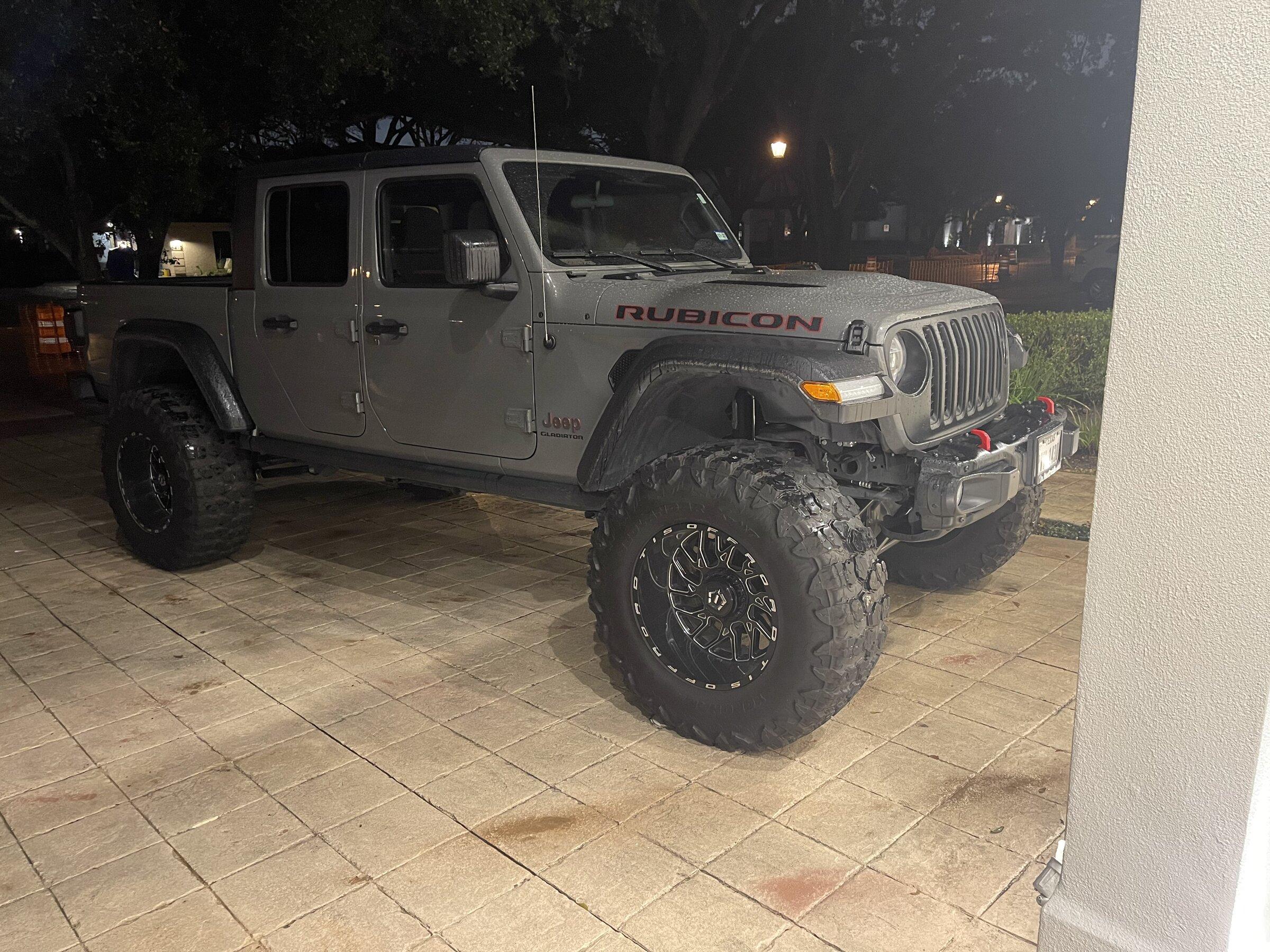

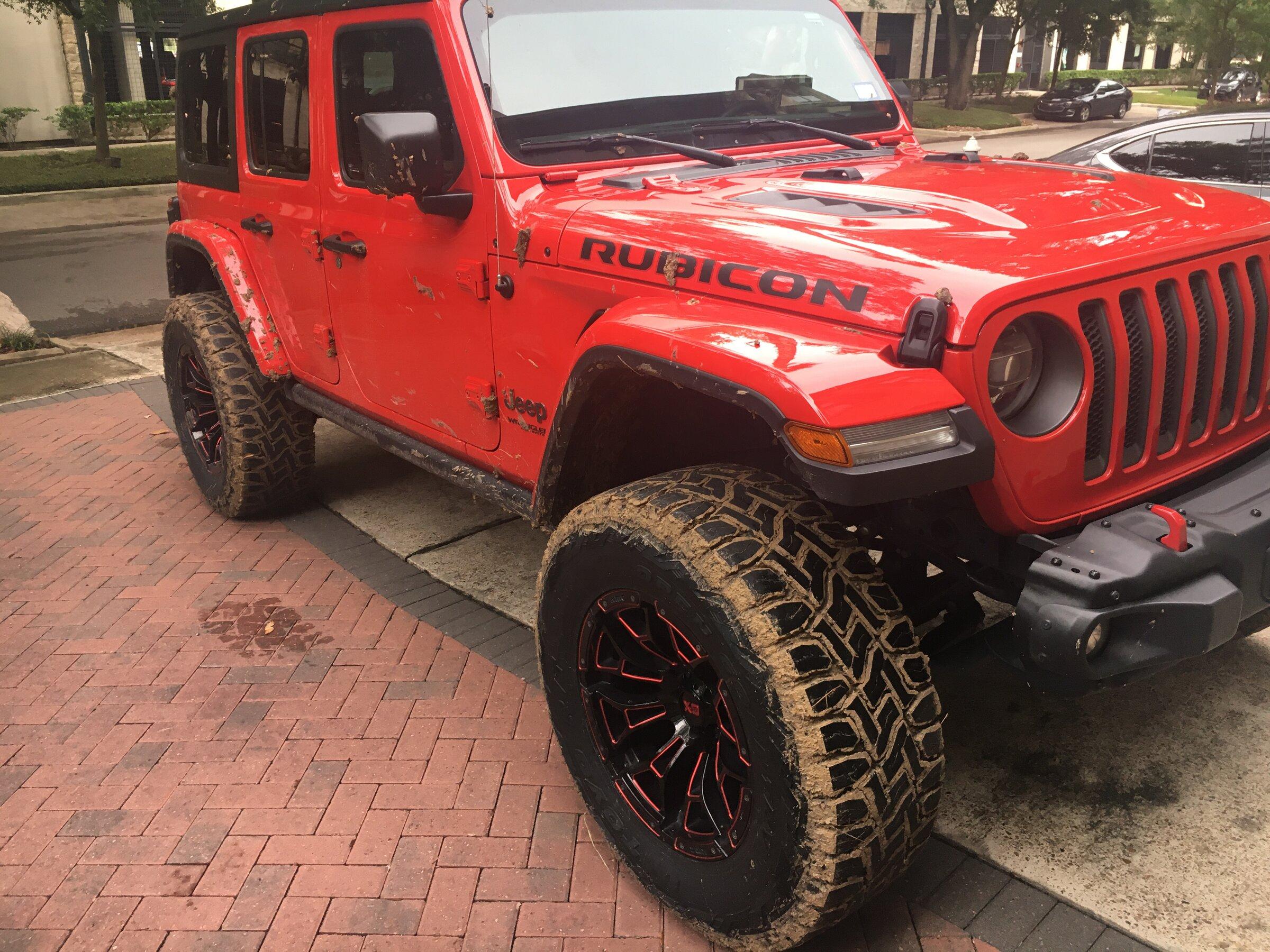

I have a JTRD on 40x15.50r20 w/ the EVO 4.5 lift. My take off is fine, but my truck shifts down in speed when I hit any type of incline. I’ve read a lot about the 3.6 and regearing for 40’s, but I can’t find information on the 3.0 in terms of regearing. Will 4.88 completely kill my MPGs? It’s already down to 19 mpg. Also I’m hoping this would make it easier on my transmission. Any help is appreciated

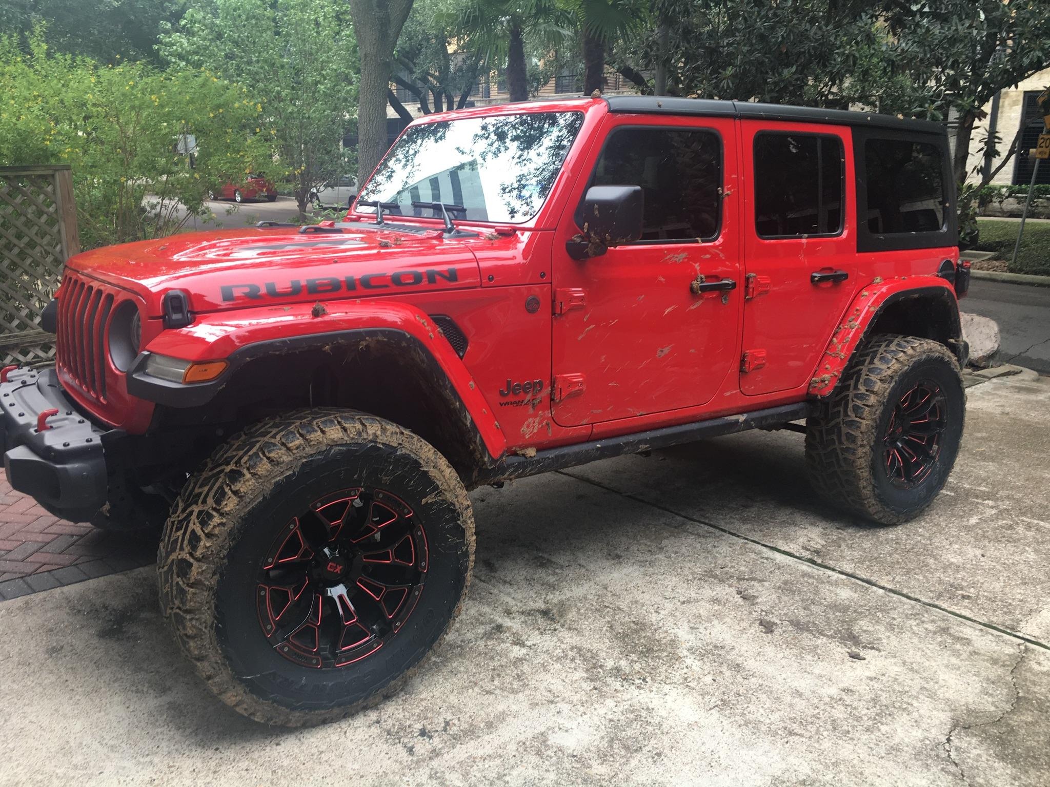

This is my JL I sold to get the JT

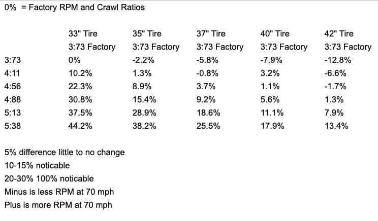

This table may help.
I have 37 KO2s and I'm waiting to see the real world application of a buddy's 56s on 39s to decide whether to go 4.10s or 56s.
