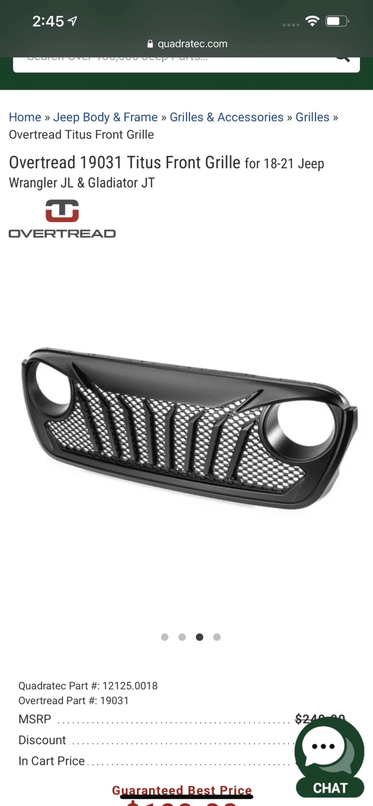

I wonder if there is a aftermarket front grill that can allow more airflow to the engine. Perhaps this one…
Jeep Gladiator Ecodiesel power derating as temps rise? 96FD3317-C910-4596-9E75-0384C140A544
I've never liked those angry looking grills, but what if........
Funny. Exactly what I said this morning. I also wonder if the hood scoops for the Rubicon would help the engine bay temp.
