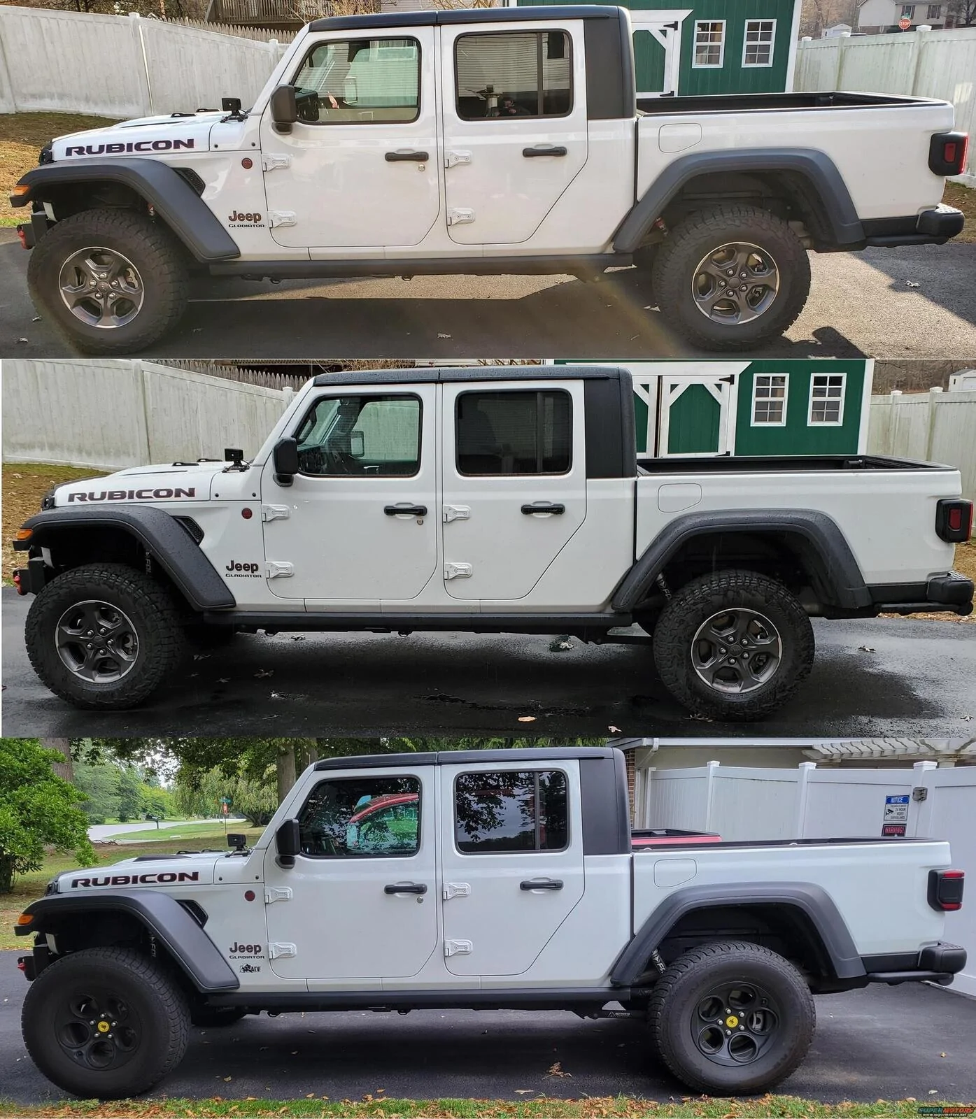

Pic below is the progression from stock OEM Rubicon suspension to my current configuration.
Top Pic is stock OEM suspension.
Middle Pic with the following:
Eibach Springs 2" Front (E30-51-024-02-02)
Eiback Springs 1" Rear (E30-51-024-02-20)
Daystar Front Coil Spring Correction Spacer (KJ09179BK)
Daystar Rear Coil Spring Spacer 3/4" (KJ09192BK)
Falcon SP2 2.1 Monotube Shocks
Teraflex Progressive Bump Stop Kit (1969200)
MOPAR Front Sway Bar End Links (68306981AA, same as used in MOPAR 2" lift Kit)
Bottom Pic with everything from middle pic and the following:
Teraflex Alpine Control Arm Kit Front/Rear (Not required if staying 2" lift or below)
AEV Savegre II Wheels
Milestar Patagonia AT 35x12.5x17 Tires
In all pictures, I have a Go Rhino stubby bumper with a Smittybuilt 12K winch installed.

That looks great and exactly what I’m looking for. I might not do the full kit of new control arms but it looks good. Side note, I have been tossing around the the idea of those yellow aev center caps too. They break up the muted color palate a lot.

Yeah, the control arms are not required, I just wanted options if I decided to go higher down the road on the lift.
As to the yellow AEV caps, I splurged and paid extra for the exact same reason.
