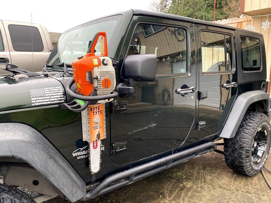

The inverter wouldn't run a corded saw of any real size, even that weird toy saw harbor freight sells for "carving". All of the battery saw are fairly comparable in terms of performance, mostly a question of how much weight do you want to carry. They make it easy, just need a file set and bar oil and away you go. Gas saws need fuel and mix oil and a file set and a spare plug and bar oil... if you are only using it some of the time, some of the times you wheel then limit your exposure cash wise. Who knows, one day you might be the guy with the saw scabbard on your fender. Not me BTW, I keep my husky in a case so it doesn't leak a slick of bar oil and/or burn someone with little fingers on little hands.
